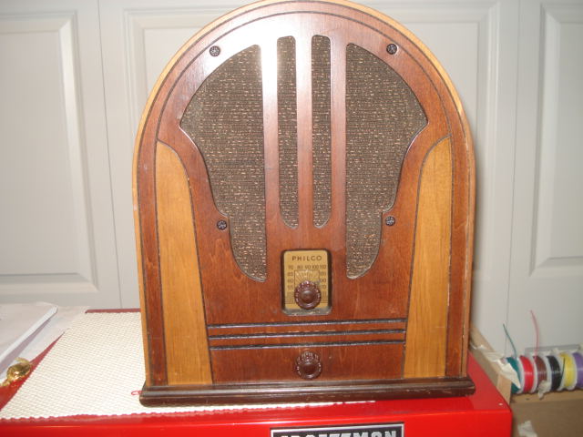

RE: Philco 84 caps -
Jimradio - 01-14-2022
![01-14-2022, 06:48 AM](attachment.php?aid=26154)
This is the completed radio pic.
Paul Philco322 - 01-14-2022
Real nice job
![Icon_smile Icon_smile](https://philcoradio.com/phorum/images/smilies/icon_smile.gif)
Radioroslyn - 01-14-2022
Has a nice original patina.
