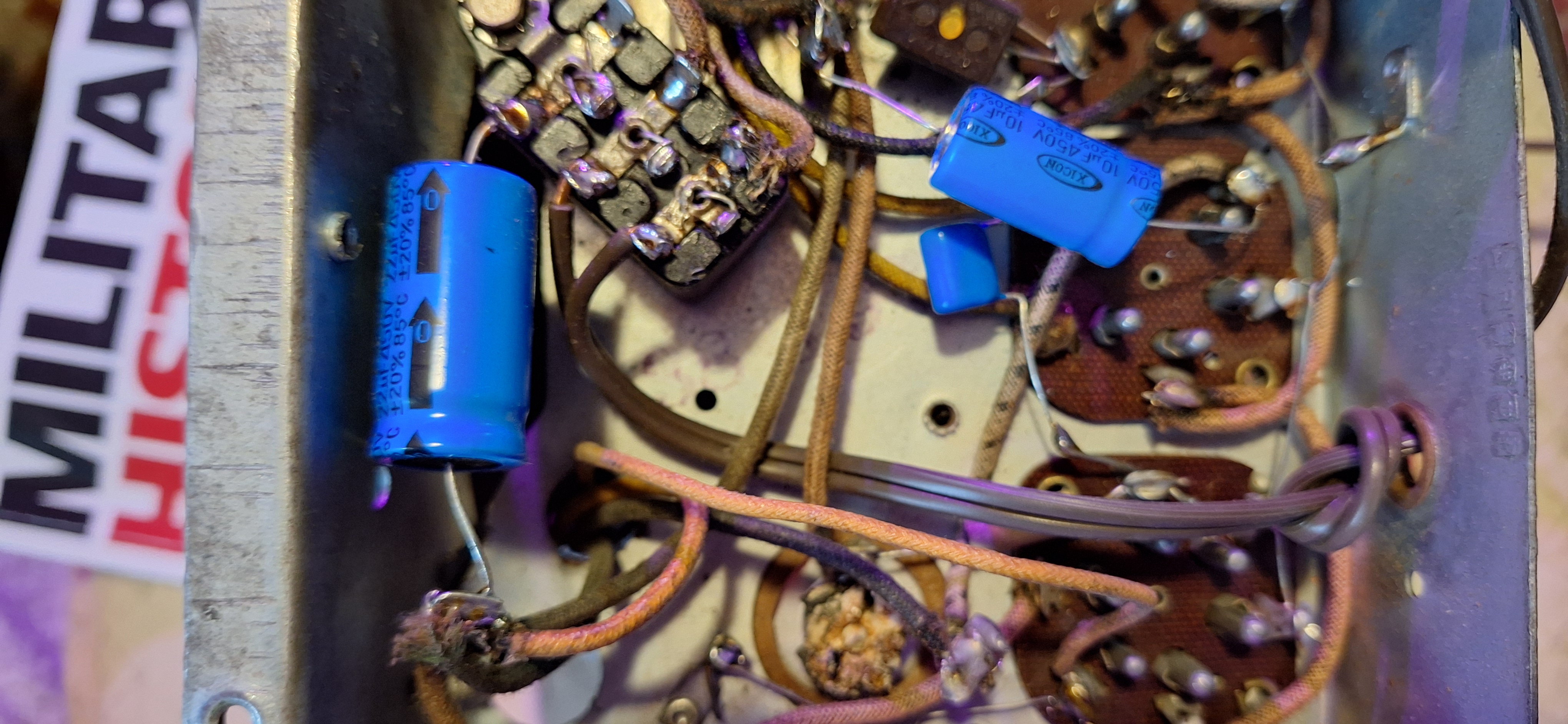

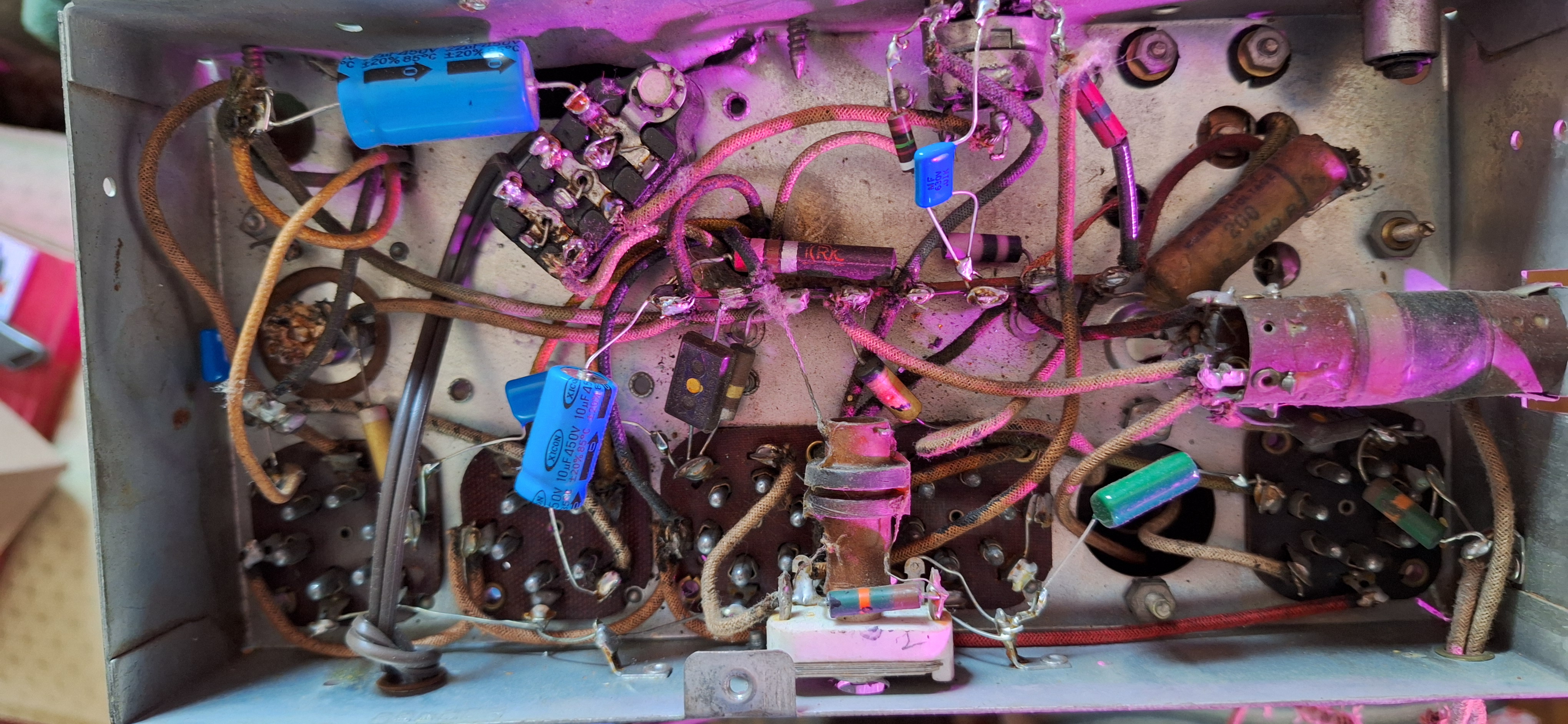

Getting started on my 38-12, I see some previous replacement caps under chassis. Not sure if that work addressed the filtering caps, also I have posted photos of the antenna transformer wiring. Is it correct? Thank you for any guidance you might be able to provide.
RE: Philco 38-12 question - morzh - 01-20-2026
Welcome.
I have restored at least three 38-12, one 38-14 and one 38-15, which are more or less the same radios.
You could search for 38-12 and my name (and there are others' names with the same radio).
I see that the AC filter cap (large backelite in the center) was re-stuffed.

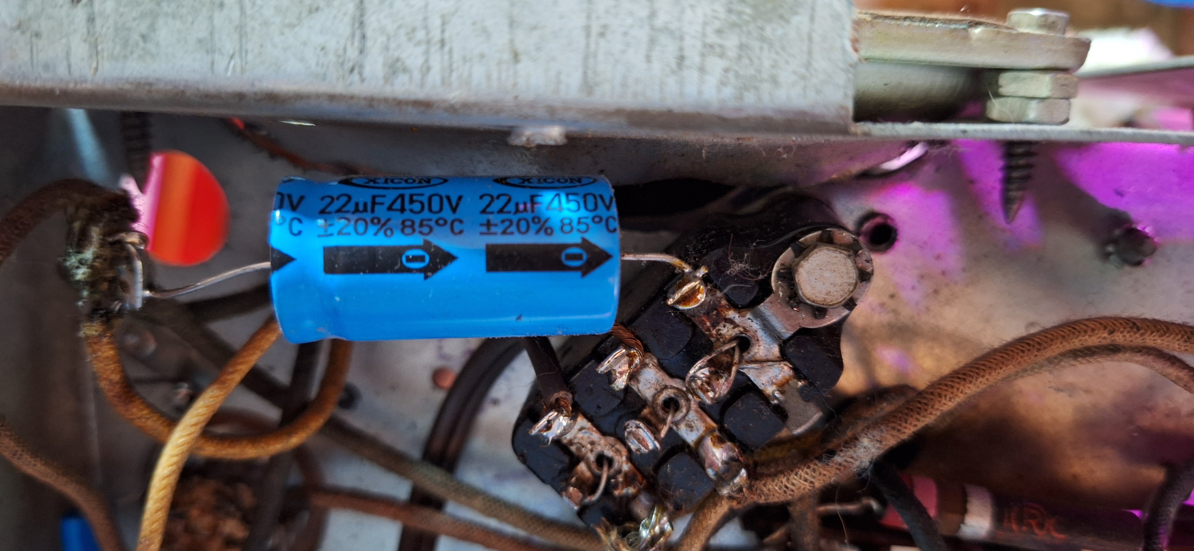

I am not shure from the pictures of what's going on with the Plus of the electrolytic in the corner. Is it being used as a post? If yes, is the case of the original cap isolated from the chassis?
Now, the main question is: why are you planning to address the radio? It's been recapped before: does it not work, or you have other considerations?

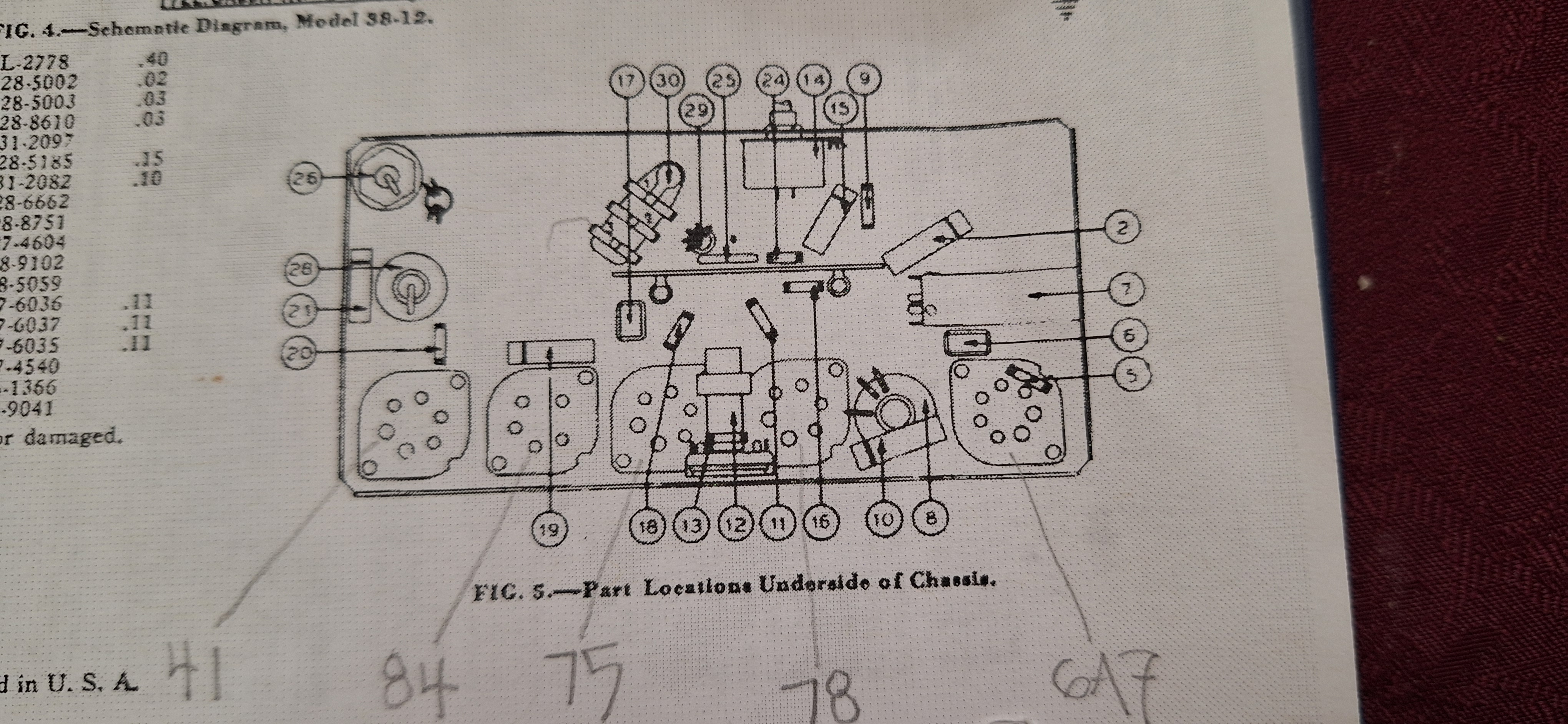

The original item 28 12 mfd. Condenser is still present and wired into the 8-position terminal strip at the center of the chassis.
The original Item 26 4 mfd. Condenser has been removed. In that corner of the chassis, the positive lead of the blue 22 mfd.,450 volt XICON cap is joined to three wires, feeding item 22, the output transformer on the speaker, the speaker voice coil and the base for the #41 output tube.
The negative lead of that cap is connected to the item 30 .01/.01 mfd. bakelite Condenser.
The negative lead of the new, blue 10 mfd. cap is connected between one end of the 8-position terminal strip and the socket for tube 84.
Make sure the old capacitors are not wired into the circuitry.
If a cap is insulated from the chassis, it's plus then could be used as a soldering post (make sure it's minus then is not). Or vice versa, if you want to use its Minus, do not connect the Plus.
The smaller cap, electrically connected to the chassis, cannot be used. You said it has been removed.

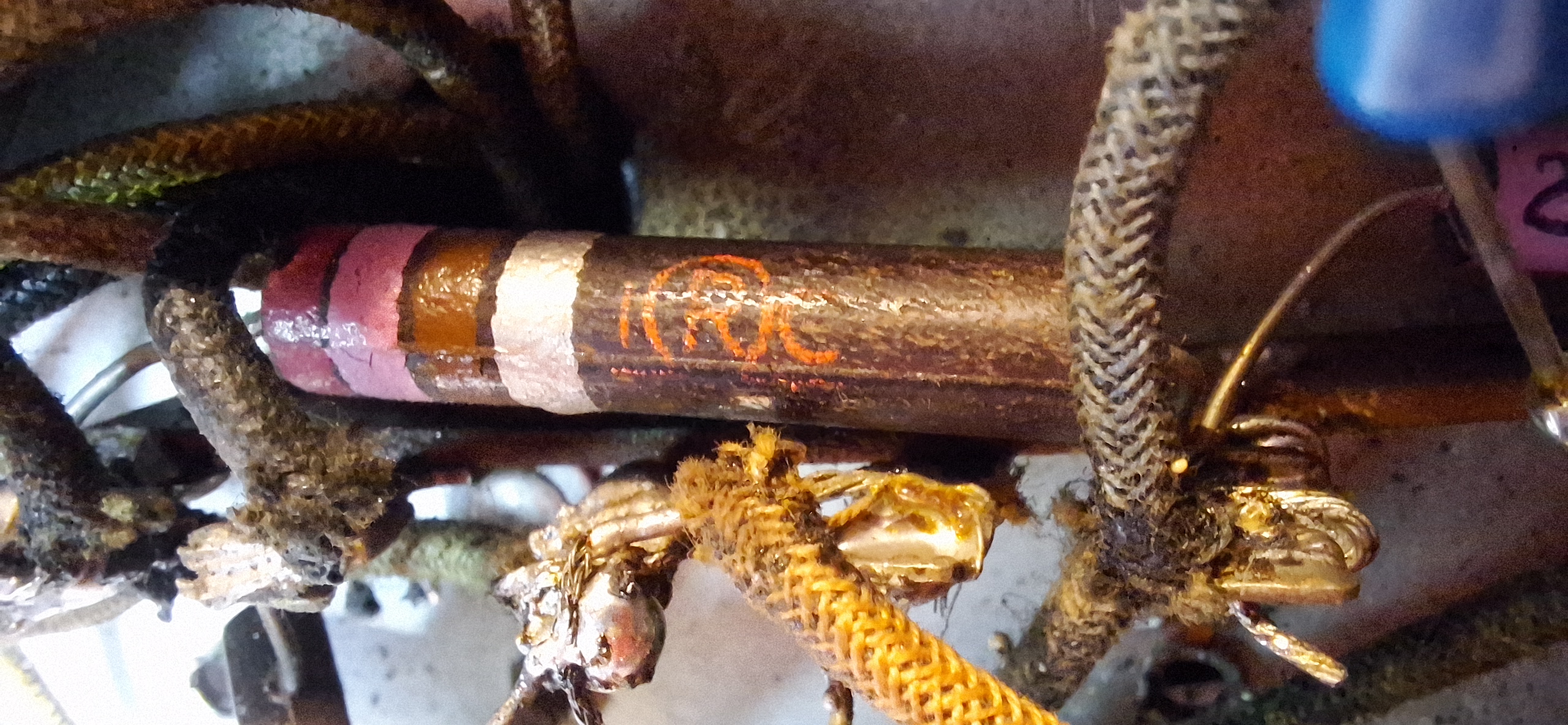

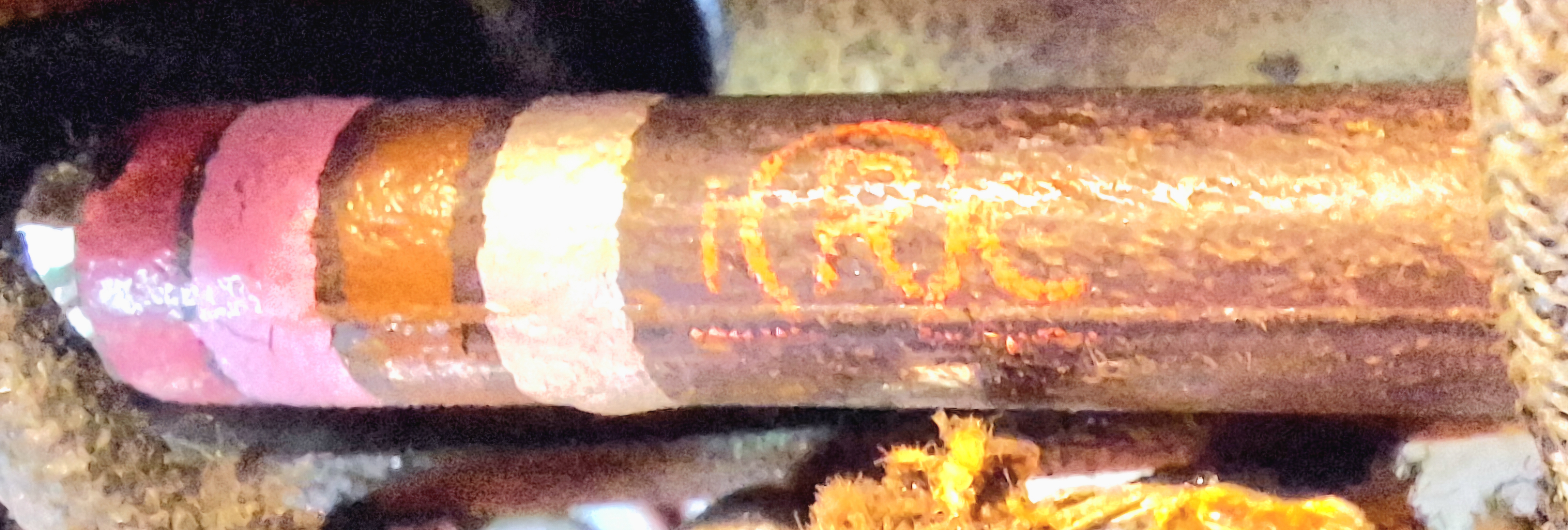

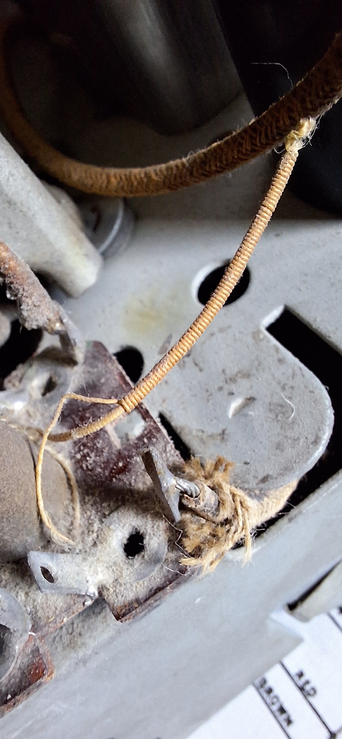

I have finished identifying and testing the caps and resistors on this 38-12, except for the final resistor on my list. On the schematic it is identified as Item 25, a 250 ohm, 1/2 watt. However the color code appears to indicate 270 ohm, 20%.The colors are red, pink (violet), brown and silver. Photo attached.
I lifted one leg and it measures 306 ohm.
What should I use to replace it?
Only two other resistors were out of tolerance:
Item 9, a 2 Megohm (no wattage speced) tests 2.36 Meg, and Item 11, a 40 Kohm measured 49.5.
Thanks for your patience and assistance.
So glad to get started on this job, and I have several more radios I plan to work on.
RE: Philco 38-12 question - morzh - 01-25-2026
The resistor seems original. I probably would leave it be, considering that it is within tolerance for 270 Ohm and not that far out of tolerance for 250.
2M resistor is fine.
40K is also fine.
If you want to replace them, do it, but it will work fine as is.
PS. Did not see the original photos of teh whole chassis; the middle tube, the 75, the 2nd Det/1st Audio, is supposed to have a shield around it. If you decide to align without it, you might get squealing.
