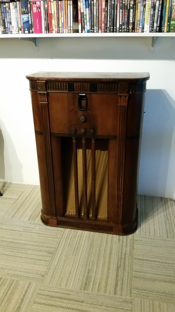

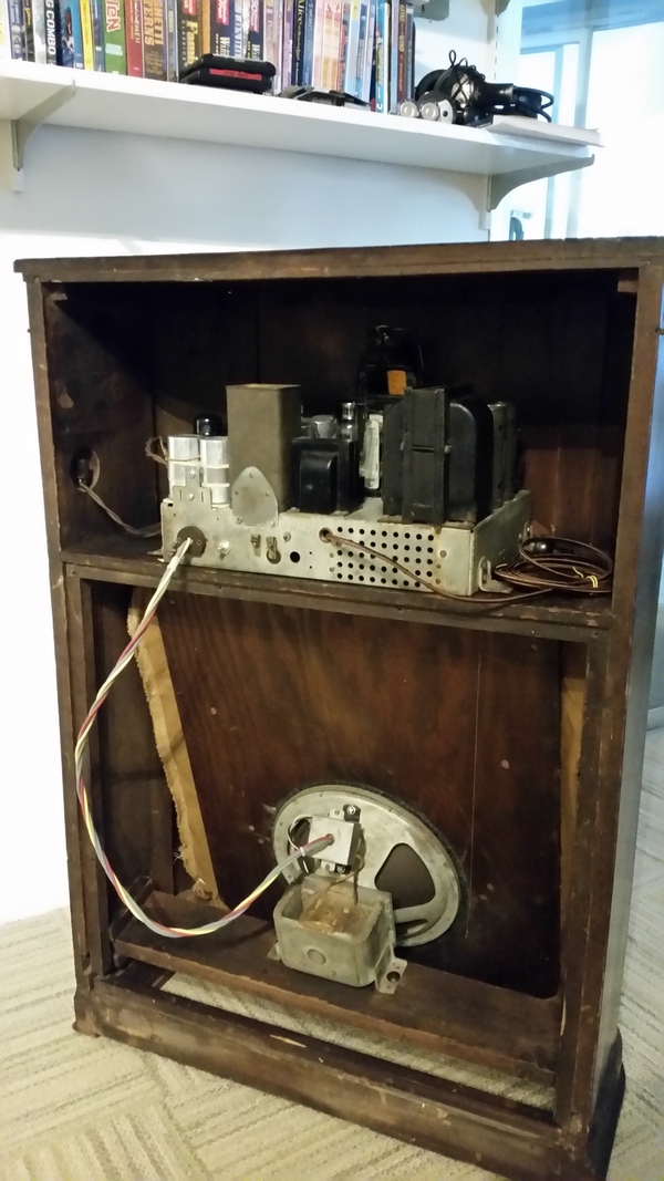

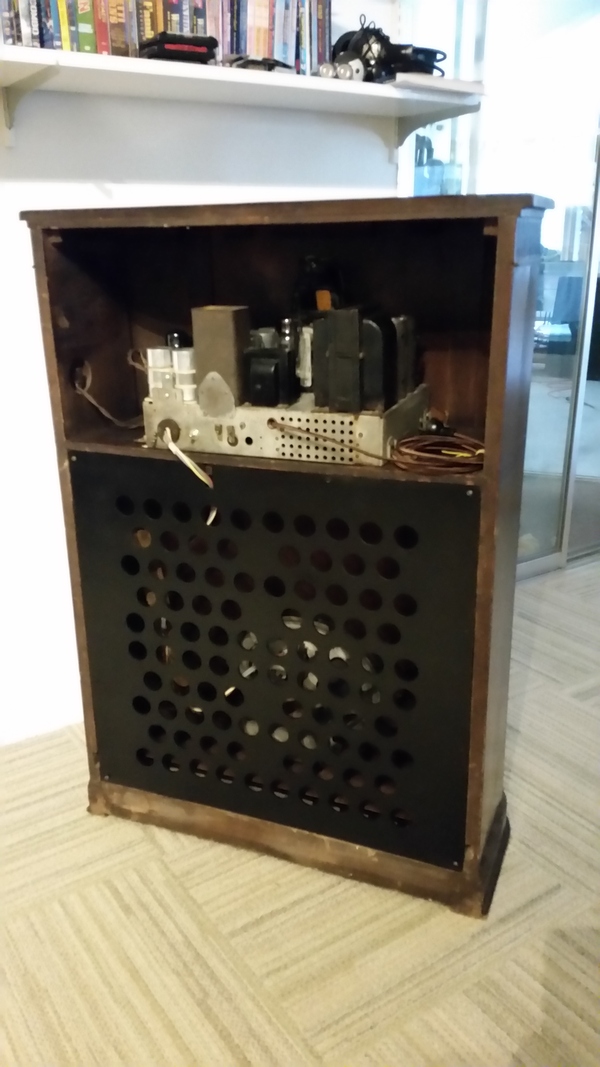

I thought a few pictures were appropriate, now that I have the chassis back in the cabinet, and the newly made back in place:
Please excuse the (resized) image quality.
I am very happy with how this turned out, not least because she receives and plays wonderfully after a desperate and very involved rescue bid!
Ed
