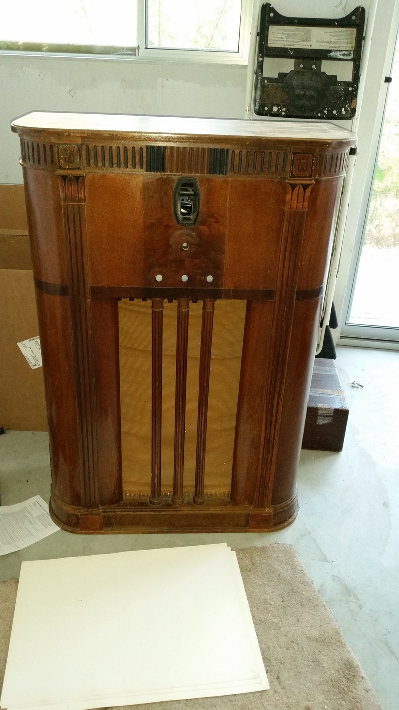

The radio is an early 5 band 16X matching the 1934 spec. The cabinet is the style with 3 posts in front of the speaker, lyre motifs and a large flat top, similar to some 18X sets. Pics soon.

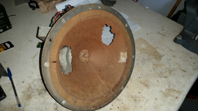

After the move from LA in 2006, the set was stored, along with a great number of other belongings in what was assured to us to be a good outbuilding on my father in-law's property... With movers flying left-right and center, it was all I could do to direct 50% of the stuff to the proper locations, let alone supervise careful handling. It was probably at this point that some of the knobs were lost.. Since it came off the truck early, it was buried before I could know what was going on, and languished at the back of a stack of belongings, inaccessible for far too long. Somehow, 10 years passed until clear out of the store was possible last September (2016), and we returned to find a horror story of rat infested damp decay, with many items damaged irrevocably. Poor Mrs H saw many beloved things in terrible condition, and my hand first turned to cleaning and finishing some of the Victorian wooden furniture for her.
When I looked at the radio, I was a bit crestfallen to say the least. The top veneer was peeling and the finish ruined, and the decorative thicker veneer on the cabinet sides was also loosening and curling. The chassis and speaker were covered in rodent droppings, and the speaker cone had provided at least one meal. Despite this, I thought that there was enough to work with, and at 83 years old, a survivor like this deserves preservation, and the more complete electrical restoration I had in mind all along. Done by the end of the year, I had confidently predicted.
That day, I gave myself an early lift by sanding, gluing and attending to the cabinet top. Things looked brighter - the cabinet would look great again with some more work. It was only the beginning.

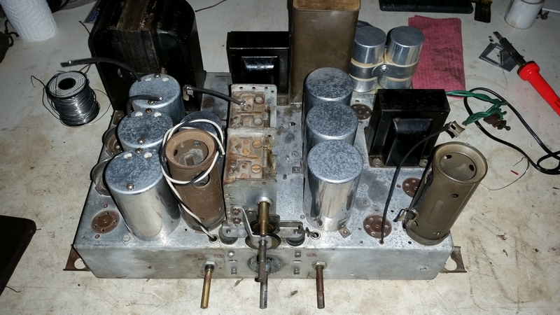

3) A full assessment of the chassis and components was in order....
4) A friend offered me a substantial collection of Erektor set parts, which did not seem significant at the time.

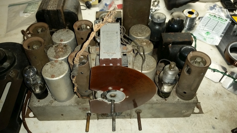

Electrically, we started somewhere here:
This is a picture of what was present once I had brushed off the loose, err, stuff around the back, the wires to the speaker voice coil had been eaten away.

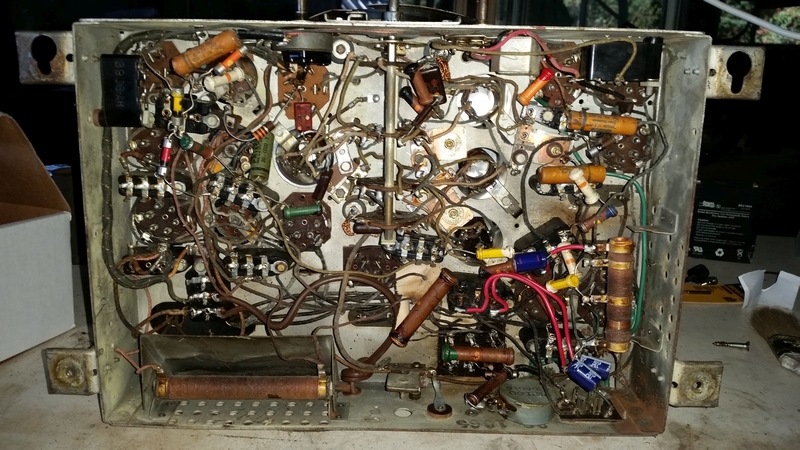

Underneath, things look reasonable but with work to do:
It was once the multimeter was brought to task that the full extent of the situation became apparent, and the scope of the project expanded beyond all previous expectations. In addition to the anticipated repairs, far more serious issues were apparent:
1) Both primary sections of the speaker output transformer were open.
2) The interstage phase-splitter audio transformer primary was open.
3) The shadow meter was open circuit (instructions for repair were provided in my schematic packet).
4) The volume control pot was bad.

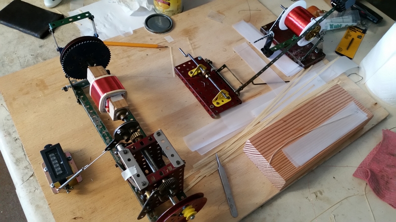

Having never seen the inside of an audio transformer before, the silly notion occurred to me that I could rewind one, and the Meccano might provide the means... I started tinkering, and looking on-line for some hints.

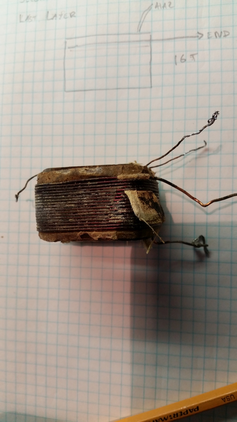

One wet sunday afternoon, I opened up the case for the transformer, and started taking notes of wire layout and core build - for instance there's a paper gap between the E and I sections to prevent saturation, since the driver runs in class A. Then the tedious process of unwinding, layer by layer, began. Turns and layers were counted:
Primary: 17 layers 32 AWG wire, 130 turns each
Secondary 24 layers 34 AWG wire, 180 turns each
The primary wire was very fragile, with signs of corrosion near the center of the bobbin.
The original former looked in OK shape. I measured the old separating papers with a micrometer, and bought high quality tracing paper to use for the rewind. What had I started? Definitely "in at the deep end" now.
Meanwhile, the winder was tinkered in to shape, and the various bits screwed to a piece of handy plywood. A cheap mechanical counter was added. Here's a picture:
We're all set up in this picture. Quite a bit of learning was needed before getting to this point - the fine wire is hard to handle and one must prevent it from crossing over, keeping the turns neatly side by side. Practice runs helped a lot. After each layer wind the wire was coated with shellac, and a new paper coated with shellac and wrapped over the top. For thicker wires, it was necessary to ad end papers to keep a regular surface, otherwise the wire would fall off the stack at the edges. I found that out the hard way about 4 layers in to the secondary wind.
I lost count of the hours spent here, with unravelling, equipment build, learning and rewinding, but it took many afternoons.

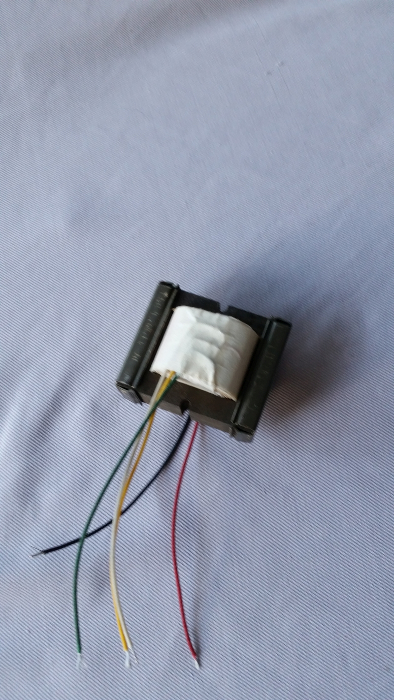

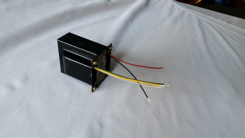

And here is the end result:

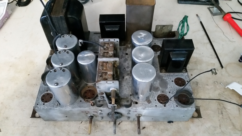

Alongside the rewinding, I had also started to clean up the chassis, scraping, scrubbing and derusting in a few spots.
The cans over the IF transformers were removed, allowing a new top cap wires to be brought out for the IF valves on the left side. At the right rear of the chassis, there is still a big hole where the electrolytics used to live. I found some motor caps of appropriate rating, made a clamp and fitted them in place:
Other wiring was replaced with new cloth covered wire, and I started working through the block capacitors. Here again, the repair man, many moons ago, had been at work. Some block caps had been clipped out of circuit and new caps added. Wiring was returned to the factory positions once the blocks were rebuilt and replaced.
