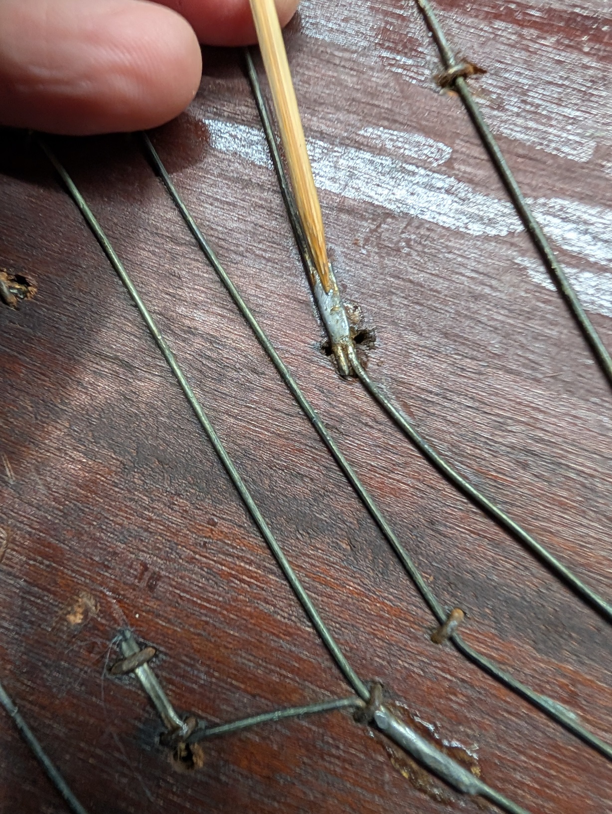

So, some removal and some cleaning.
Taking the parts out, obviously, take some desoldering.
I use the bamboo skewers from grocery shop to separate the wires upon melting the solder.
Like so:
They then come apart easy and don't re-solder by themselvs.

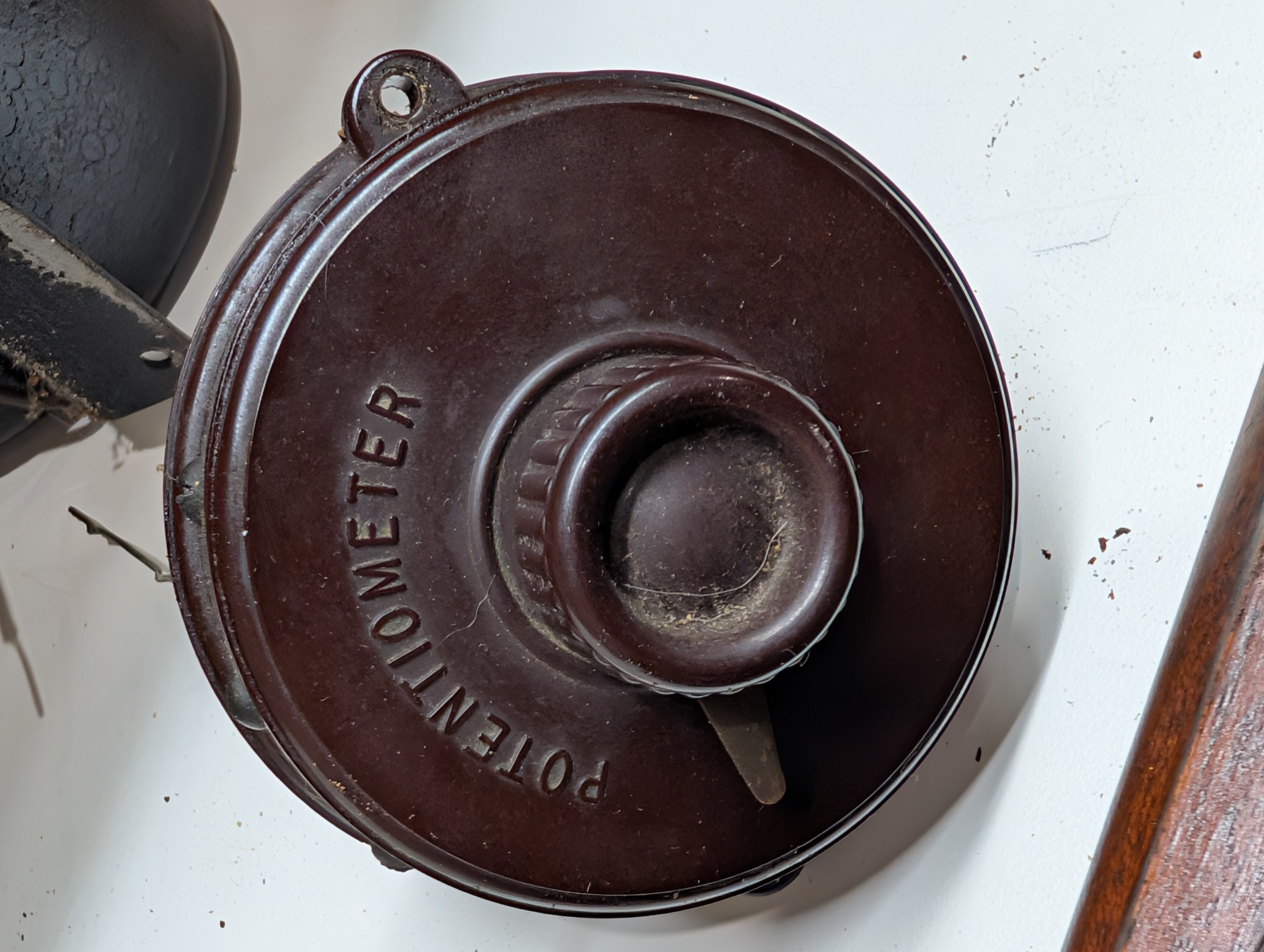

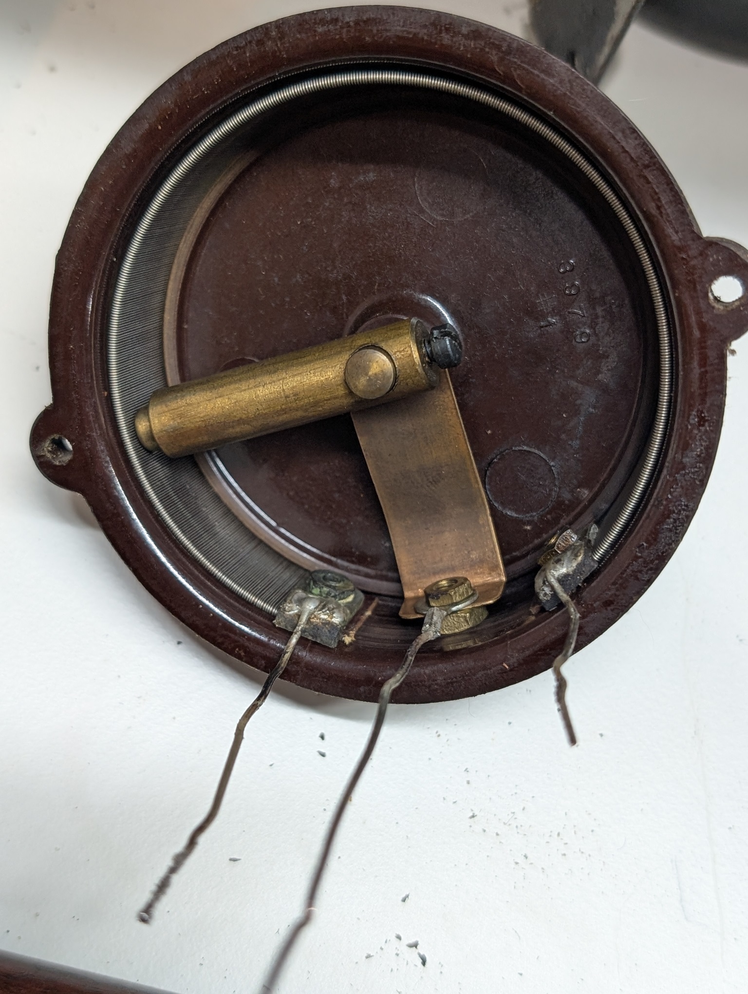

This is the potentiometer: this one could use some contact cleaner used judiciously.

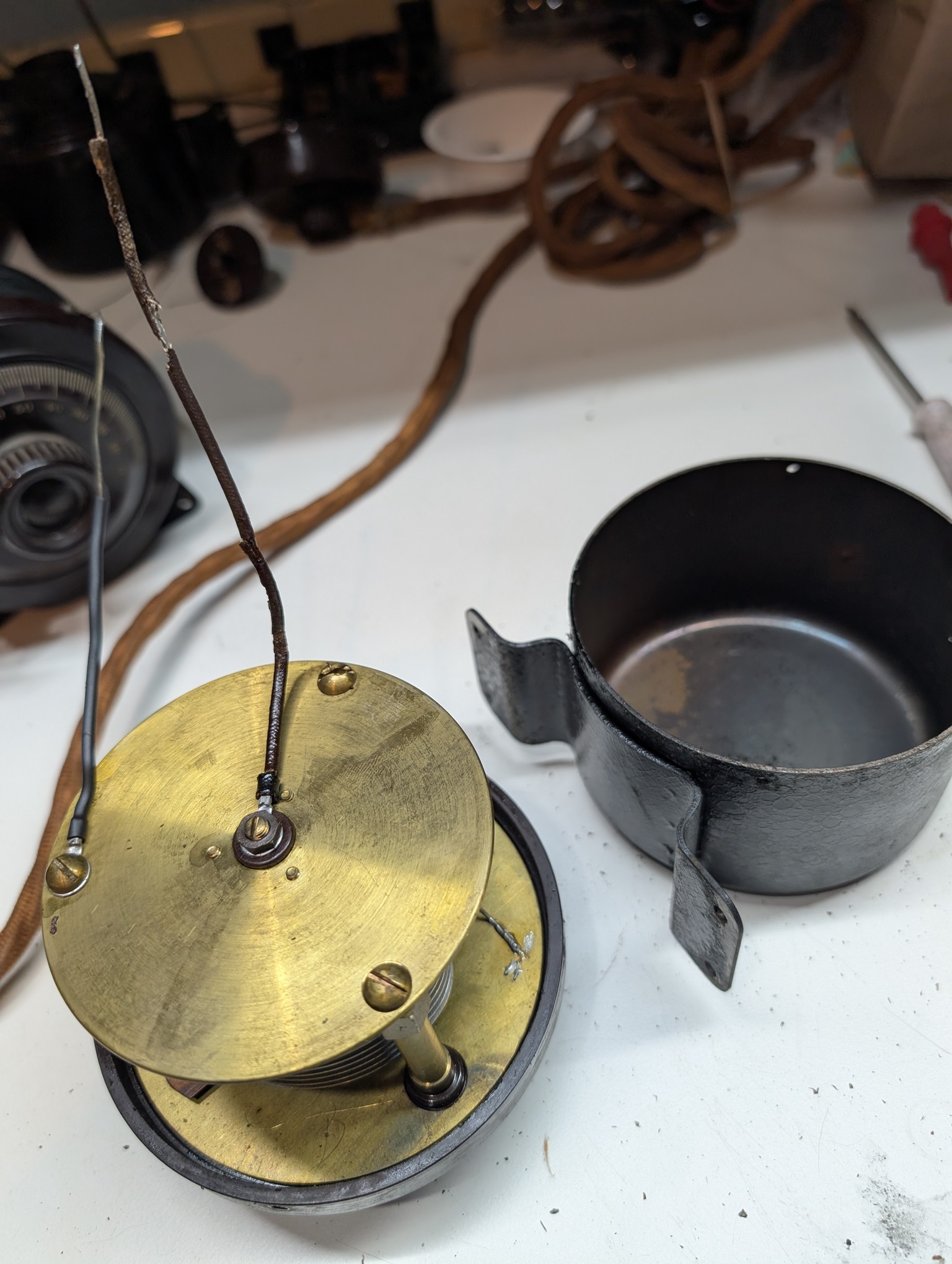

Then I opened the variable caps and re-insulated the wires. The insides otherwise are very clean.
I also made sure the spring contact makes contact with the case, which it did very well.

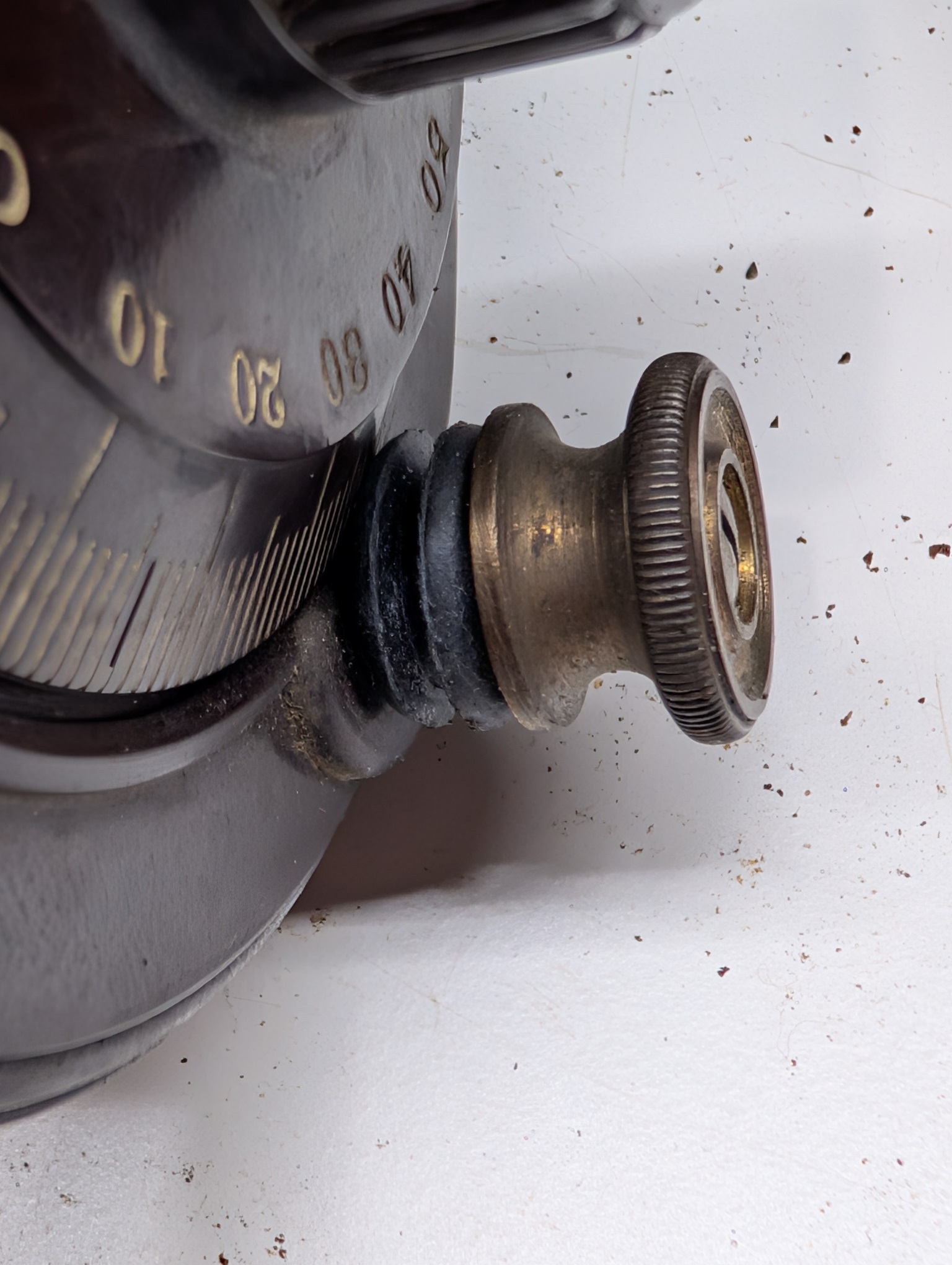

And I used rubber grommets with rounded edges to make the tires for fine adjustment knobs.
When a better one becomes available, I will put them in. It is easy.

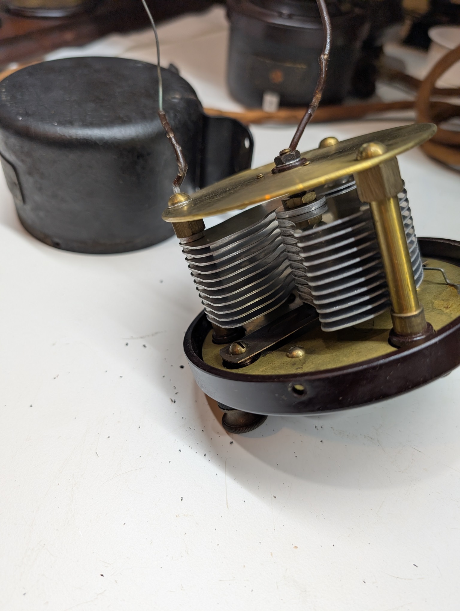

Re-insulated all three tuning caps.

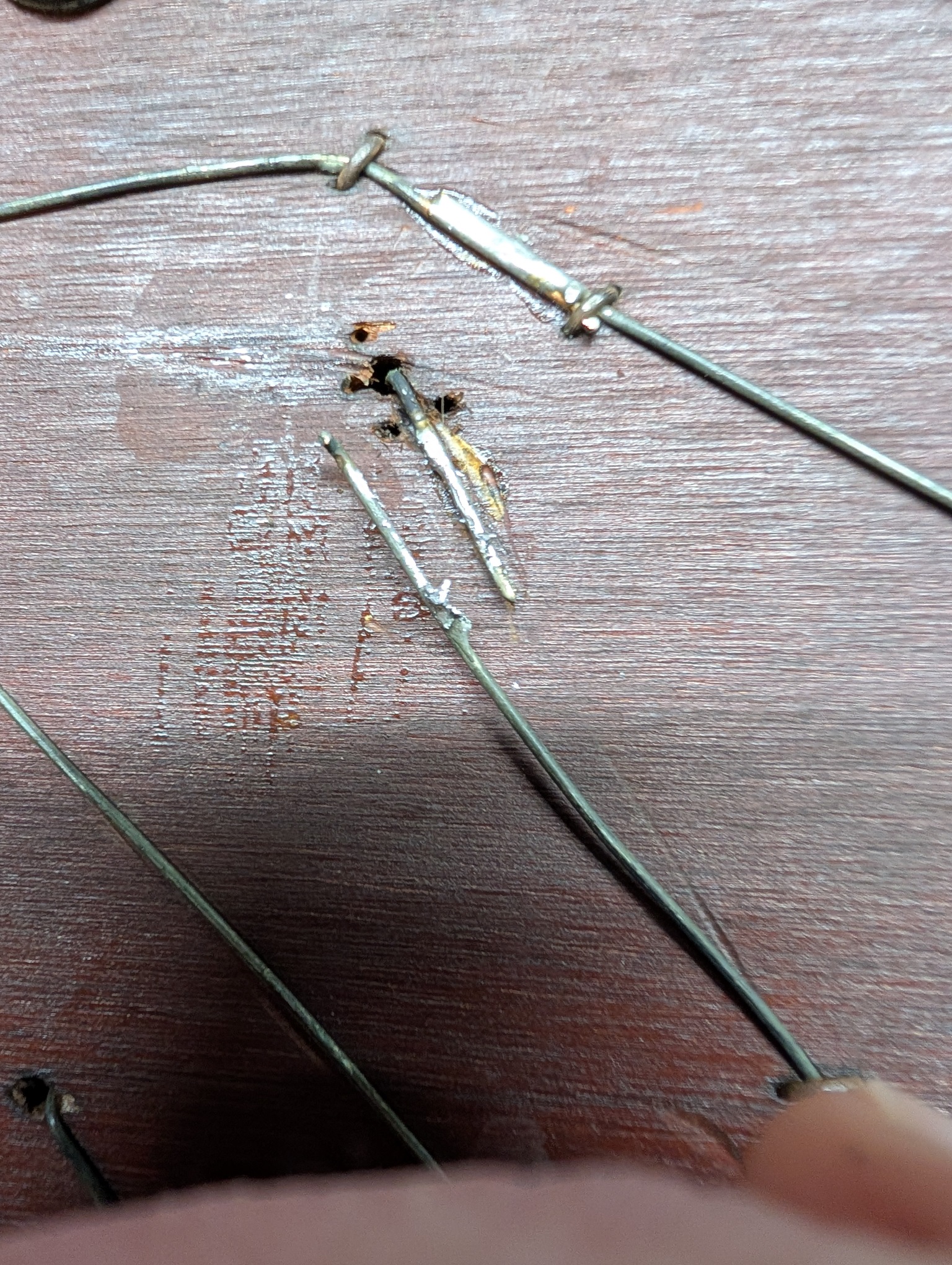

The coils' wire is fully discolored. I saw that Glass Slinger person paining it with some gree oil color. Could work too.
Two out of three coils had a breakage at the last turn that goes inside to the posts and it was repaired. The repair somehow oxidized (though remained fully conductive) so I re-tinned it.

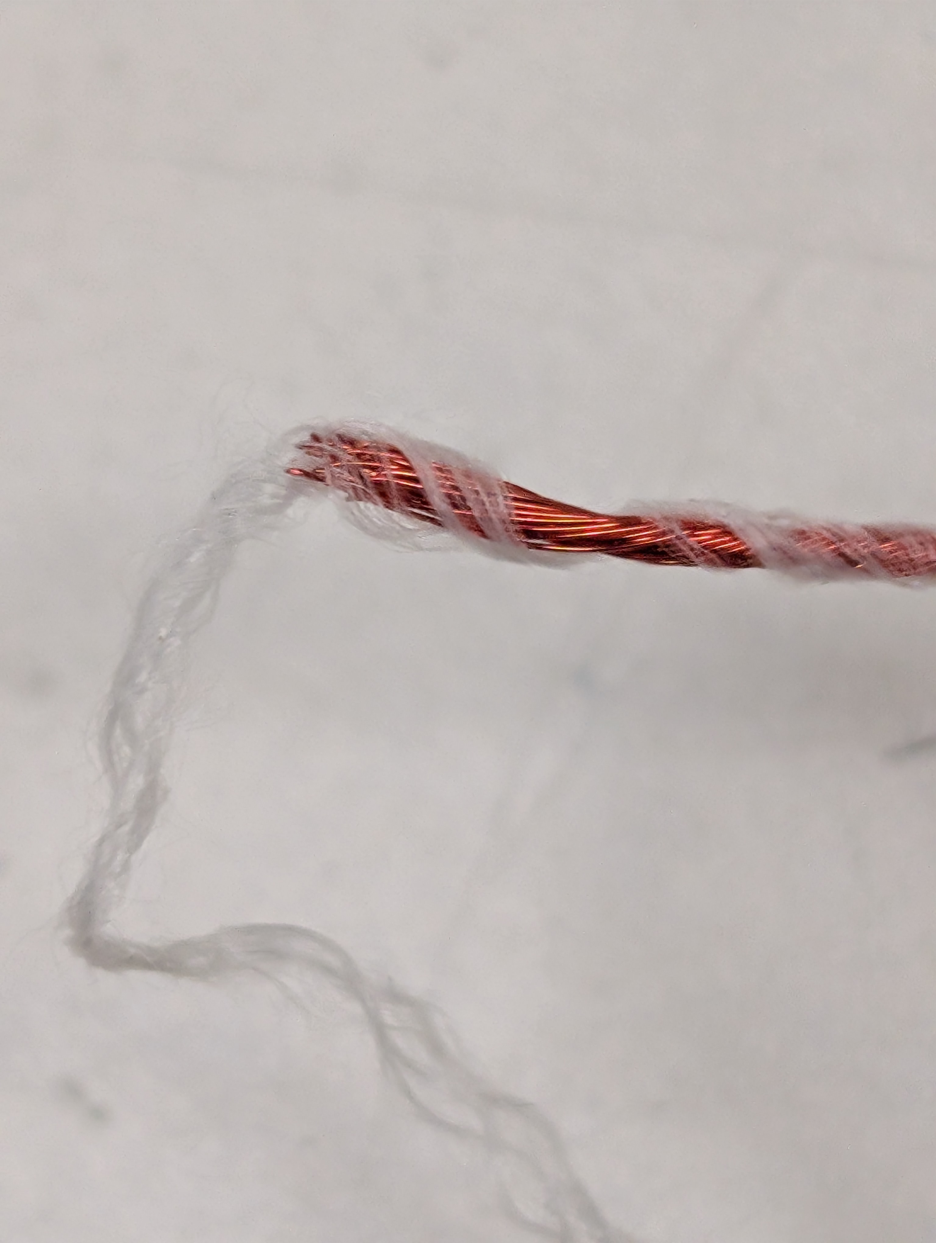

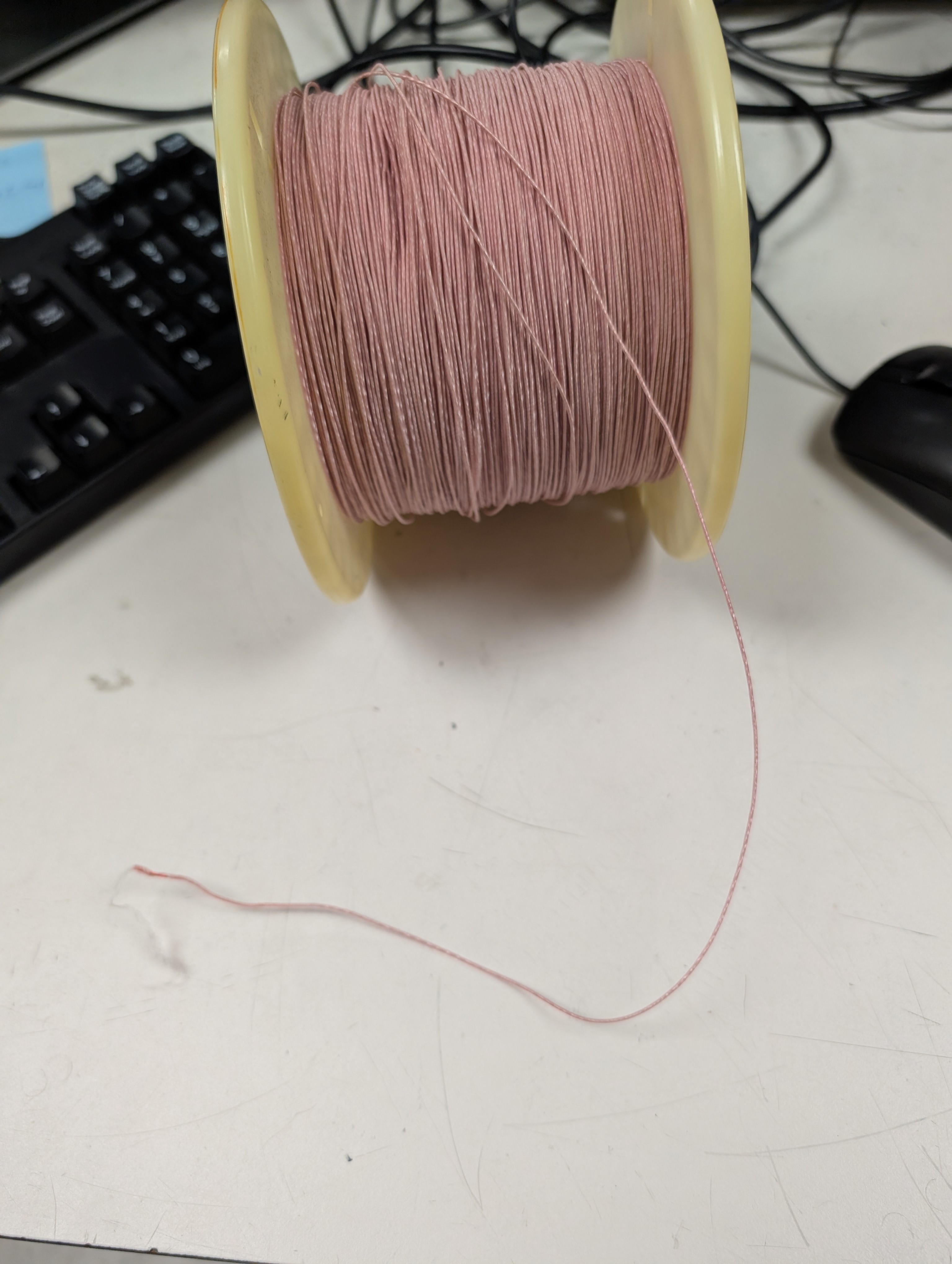

But the wire is not a litz. Even though I've seen some places calling a silk-insulated solid wire a litz, litz is by definition multy-strand, with each strand insulated with varnish to prevent skin-effect. This wire is a solid core type. Actually made it easier to twist and solder where it broke.
This is a litz I have. I still have two bobbins at work, but many are back home as they at work suggested discarding it, and I told them I'd rather take it for myself. Crazy. Each bobbin is a few hundred bucks.
The color is a bit off.
But it is a true litz and would probably make  a better coil, not that it would make much difference in this case.

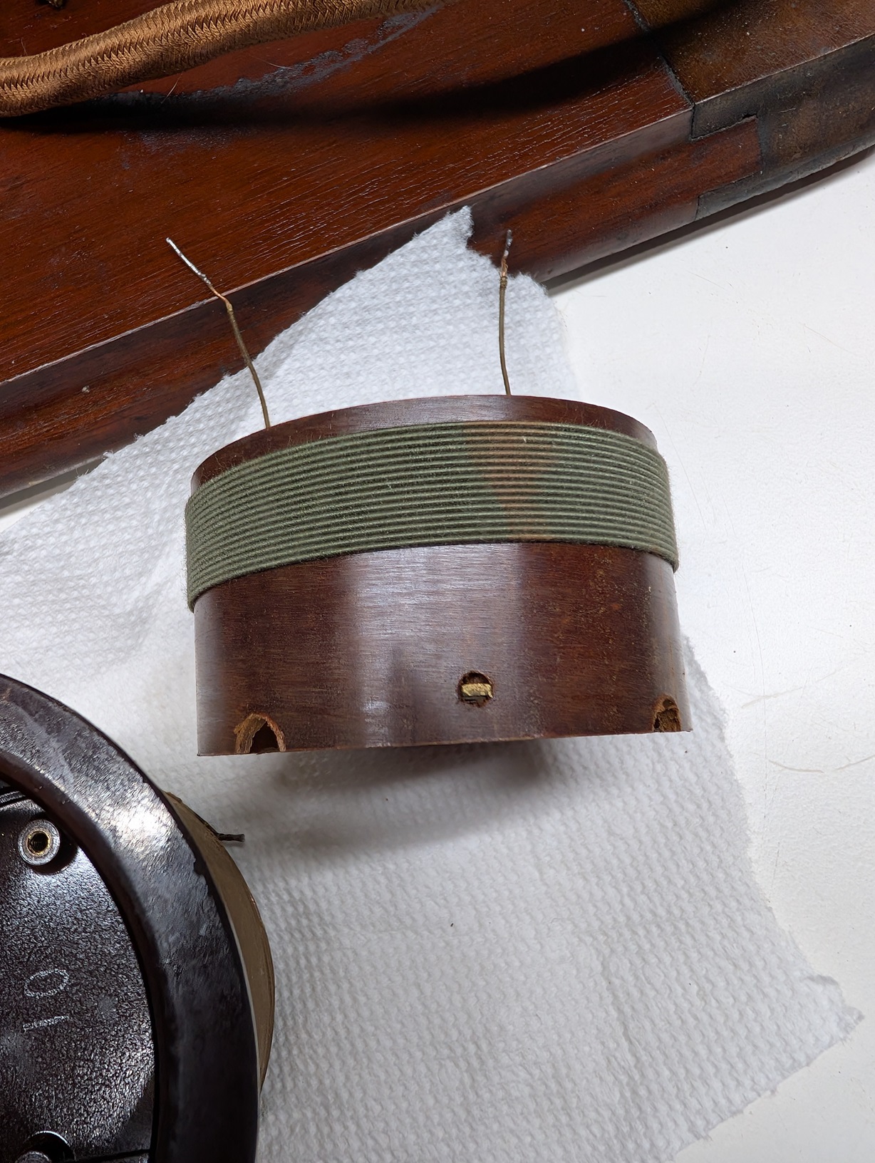

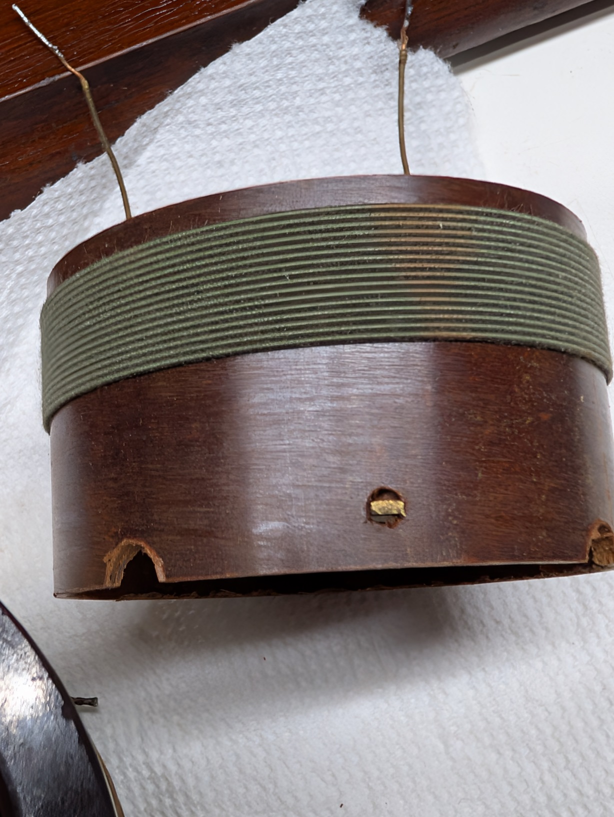

So, after some measurements, the exact gauge of the wire is AWG23, 0.57mm diameter, and the exact thickness of the wire with insulation is 0.887mm in diameter.
The latter is more importan as the wire resistance and skin effect won't make much difference at BC frequencies, but it is more important to keep the geometry, that is the number of turns and the length of the coil.
Now, I pulled one of the inner coils in order to see the original (if somewhat possibly faded) color.
Feast yer eyes, gentlemen:
This is what it is, and this is what I will eventually want to get.
Mike;
It's almost an avocado green, assuming they used the same wire to wind the outer coil as the inner coil. You could probably use a fabric dye to colour the beige stuff, though I would want to rinse it thoroughly afterward. I'm sort of inclined to leave things alone unless it has obviously failed, such as it has come unraveled, does it appear to be green on the underside of the outer coil windings?
At this point I am leaving it alone. This is a plan for the future. Right now I just want it to look decent and start playing.
As for the underside, I have not unwound any, nor do I intend to unless I ever get that wire (Chas showed me some British company, WIRES.CO.UK who sells reasonable amounts for reasonable prices, and also some write-up by Robert Lozier on his way of dyeing these wires).

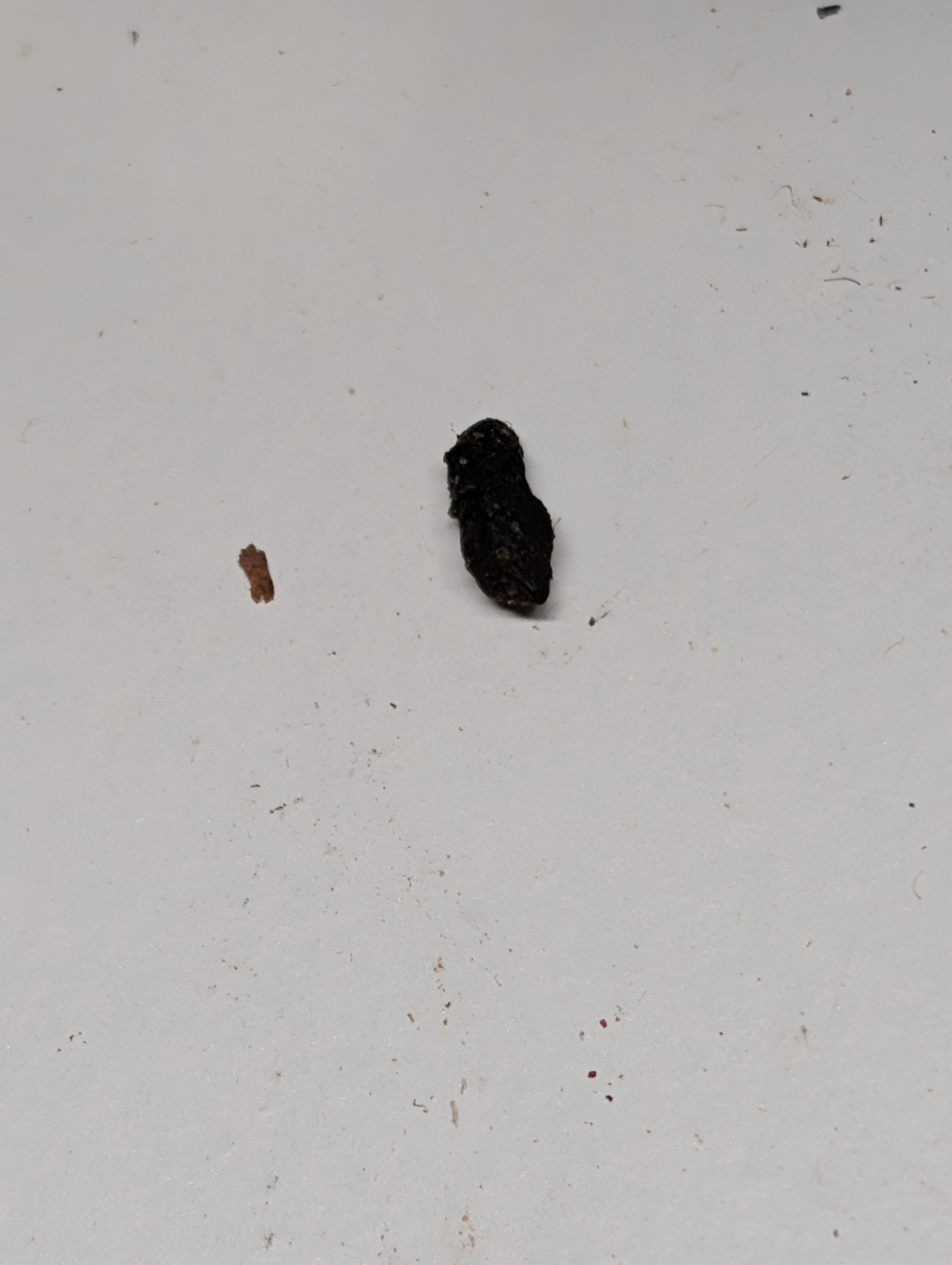

When taking the last amp off, this fell out.
I hope it is not what it looks like. As there was no more across the whole radio. Plus it was inside the amp.
Well, I will attempt the Howard treatment tomorrow. If it does not work well, OK then, I will think of something else.

I too hope it is not either I have Zenith model 715 which had nest under the chassis .

As for that black pellet looking thing, it's too black to be a vintage rat dropping, they usually dry up, turn grey, and disintegrate, plus I think there would be more then one found in that set. It's more then likely a ball of tar if there are no holes for anything to fall into, like under a tube socket, or something.
Yes, this is what I thought too. They usually come with a company.
