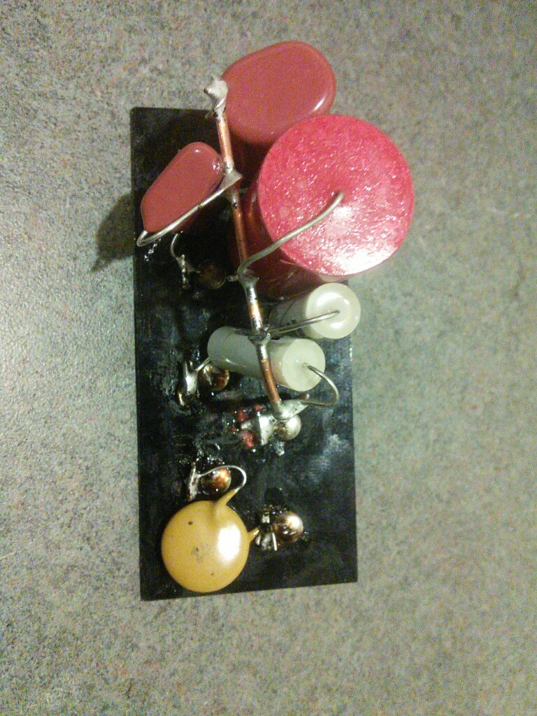

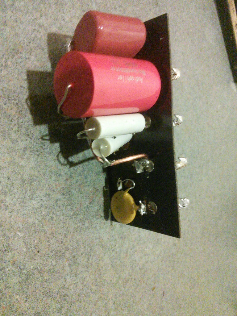

Caps fit just fine - same exact arrangement was n 111, and they could be put there before the can goes over.
And yes, getting a junk toaster oven is a good idea.

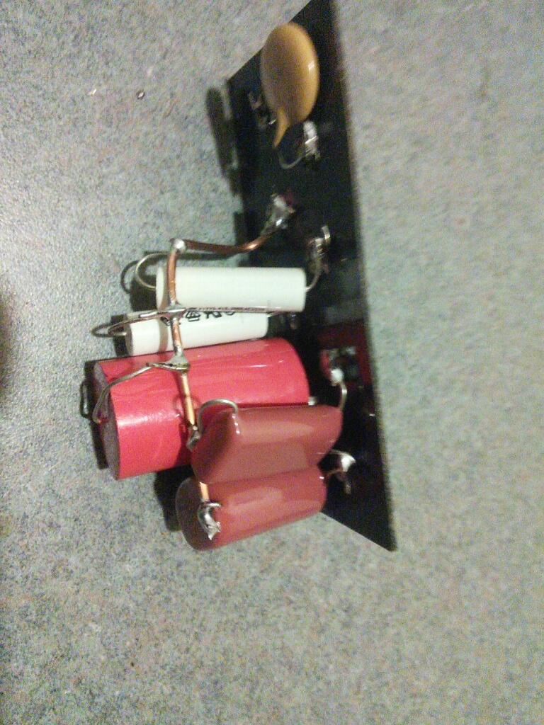

This is the capacitors mounted on the strip. I could put it in before I clean the can.
The cap from hot to antenna I made XY rated safety 10nF.

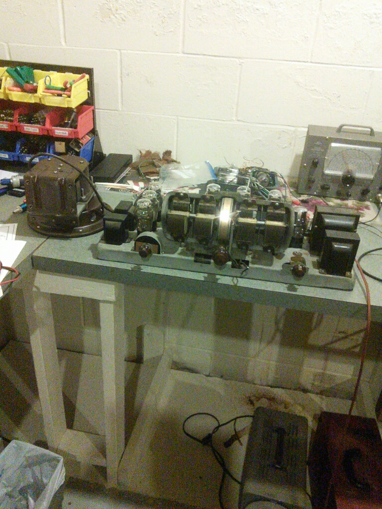

So today I put this panel in, screwed it down.
Forgot to solder it in.
Turned over, powered. Zero volts. Took me about 4 minutes to come to my senses. ;)
Luckily, no shorts (power wires were hanging inside) or otherwise bad things.
So I soldered everything.
Good thing about this radio, the B+ is loaded by a resistive load from the start so the caps do not experience large voltage rises before the tubes warm up, so I could safely use 400V caps where otherwise I'd use 500V.
The speaker is in pristine condition.
I pulled it out, plugged in. Powered.
The radio produced typical noises, hum dependent on tuning, some howling and a distorted weak station, all with no antenna.
The "local" mode where the Line is used for an antenna did not help.
I disconnected the antenna from Local, touched it with my finger and was able to receive my local station. It is not yoo loud and it is at full volume.
I suspect the radio is badly misaligned, plus needs neutralizing.
But.... it's a good result.

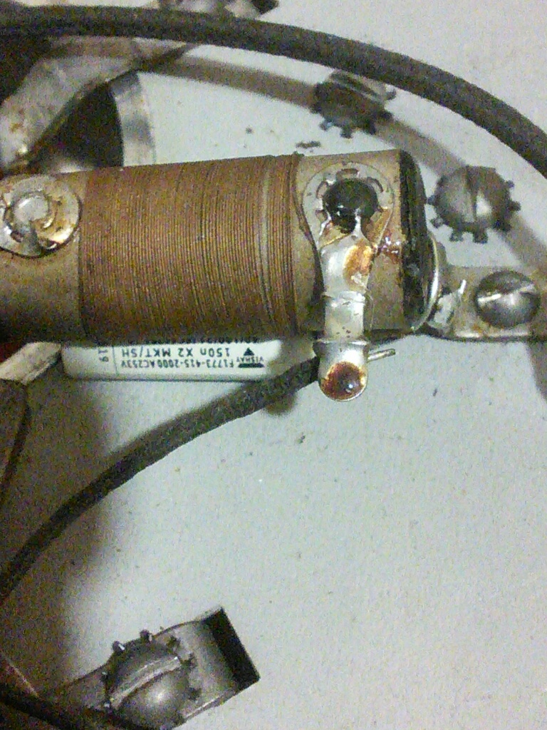

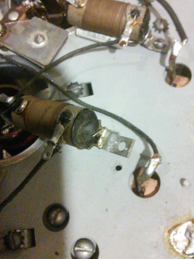

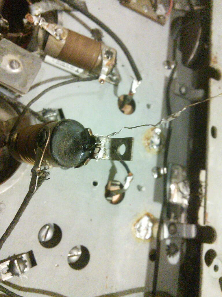

The 100 ohm resistors have caps inside them. Supposed to be 0.1uF. Test at 0uF (well shows 140pF at the meter showing 110pF at nothing).
Luckily the lead of the cap is easily unwound from the holder that grou ds it and then cut.
The new cap goes under the resistor.
The reception is much better and less garbled. It figures.

Question ???? I would like to know,,,IF,,,you have ever pulled the capacitors ,,,out of the resistors (wire wound ones ),,,??? thank you
No. I cut one of the leads and then put the new caps outside.
I actually wrote about it and supplied the photos.
