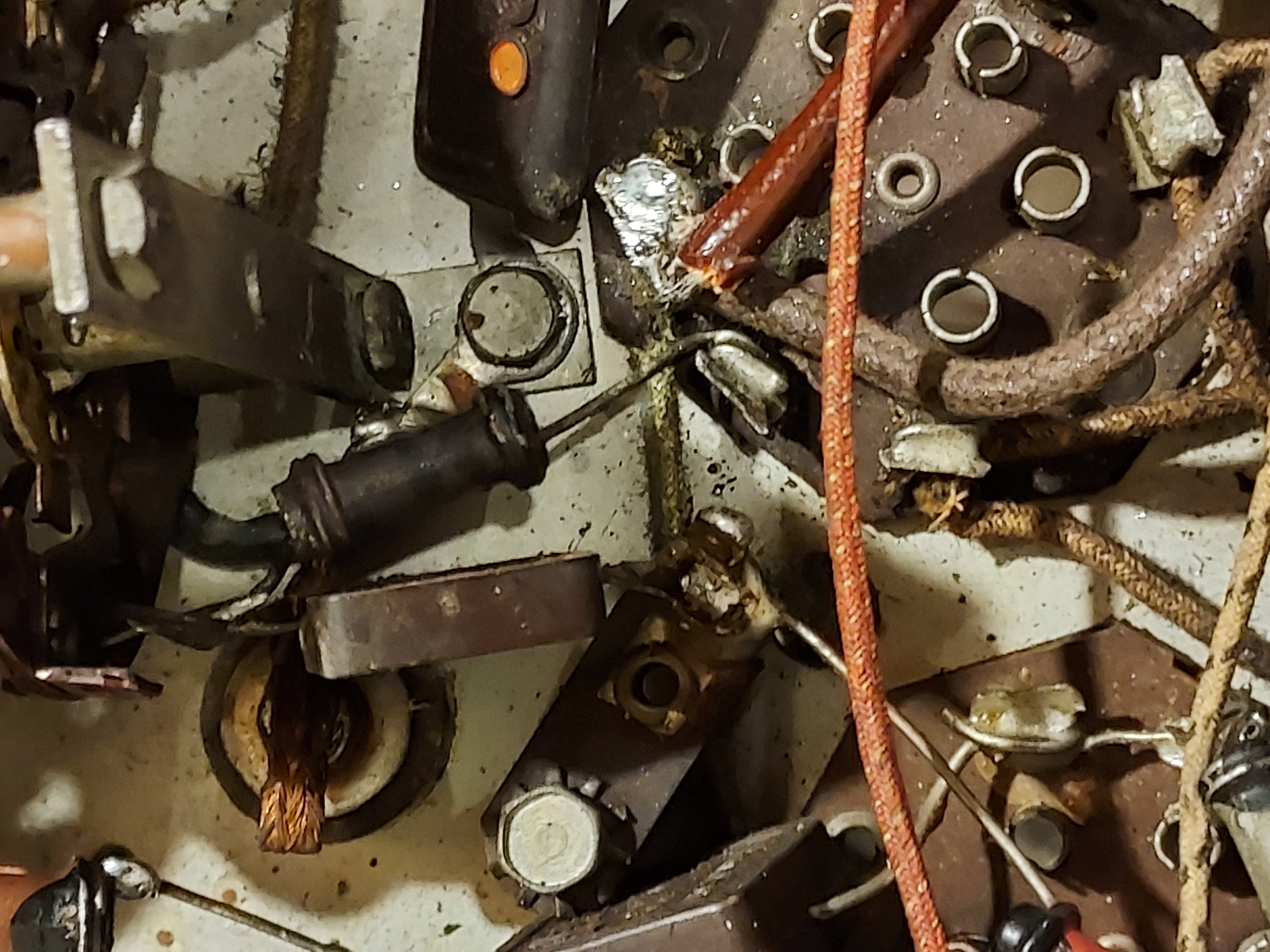

It seems that a resistor with the value of about 80 ohms has been placed between the RF AMP plate and the rest of the circuitry (Cap #40, a 100pF and a band switch's contact). I cannot find the service bulletin mentioning that.
The soldering is clearly original factory one so it is not some repairman's "improvement".

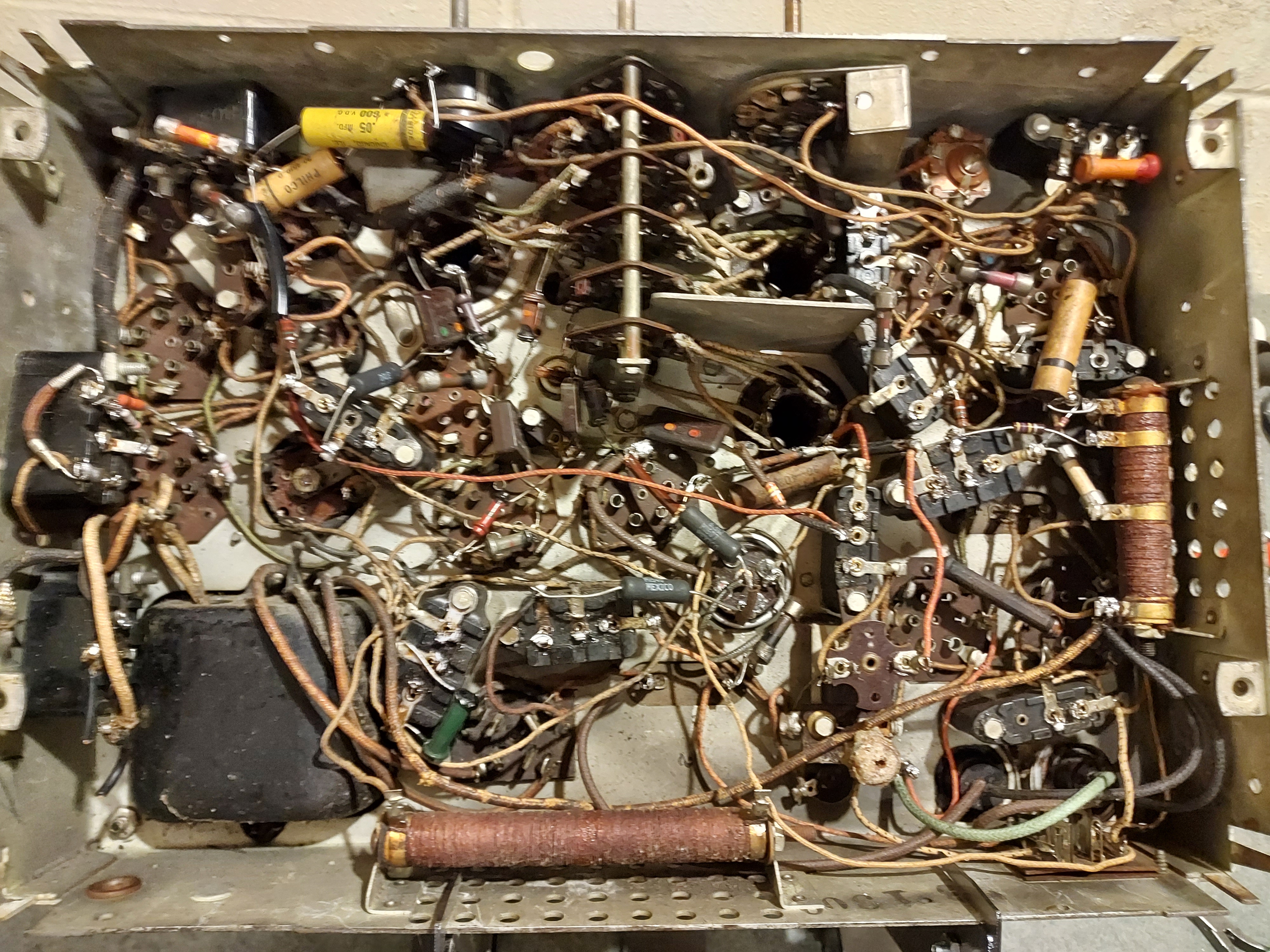

I have not devoted much time to the chassis so far these two days, but at least I attached the power cord and tested the transformer with my Variac; it looks fine.
I thought to maybe try powering it up but I remembered I am lacking two tubes (forgot which ones) and I have not found/bought them yet.
I thought I did not have 78 tubes.
Also I realized one of the 78 tubes was replaced with a 77 one.
When I damaged one 78 in the beginning, I thought I did not have any in stock and now I even thought of buying some. Then I looked at my bench plastic bins, and I have a whole bin-full of them.
So I picked three that tested like new.
Also on the photo you could see a 77 tube's (the one right under the two IF cans) grid wire is outside the shell; I am sure it should be inside.
So I put all the tubes in, made sure it started rectifying at about 50VAC, and then went to 110VAC.
There was hum in the speaker and it reacted to the volume pot wiper being touched.
I could hear aerial noise, but rotating the tuning cap at where the local station is did not result in reception, so I will have to look at the RF circuit.
But so far no smoke and AF working is a good sign.
PS. Of course it works. I came down to see why there is no reception and then it occur to me to check the band switch posiition. Sur'nuff, it was on some SW band. Put in the BC position, the radio clearly receives the local station.
PPS. Putting the heat shield to the wire-wound resistor in the back proved to be a bit of a challenge. When taking that off I did not feel like taking the resistor out, so I bent a side. Putting it back was not possible without taking the resistor out, so I straightened the bent side, took the resistor out and then the insulating washer that is in between the holder and the resistor's end (probably to stress-relieve the ceramic) disintegrated, having been burnt over the years. And I do not have a fibre washer in the house. So I searched far and wide and found a fibre bushing which was exactly the right size and the internal diameter, so I saw off a piece to make a washer, and then spent some 15 minutes hand-sanding it to the right thickness. Eventually it went in. So the under-chassis is done.
I turned the speaker towards myself when playing (the cone facing the bench top obviously affects the sound) and was pleasantly surprise by a good clean base.

The chassis aligned without much difficulty. Actually, it was very much aligned; the adjustments were very slight.
Now I have to fix a lamp of the band 4 that does not light up (and it is the one that the wrong size though I do not see how that would cause it), and then try to align the shadow meter to get the dark sector in the middle (when looking at it the sector i way to the right, so I only see the left edge of it).
The lamp of the Band 4 had the wire going to the switch broken. Easy.
I also look into the shadow meter, and decided all was good inside, so the arm holding the bulb got a bit of adjustment and now it works just fine.
After a while I started getting some raspy distortion that would come and go. I changed driver, a 42; it seems to have become less but once in a while a hint of it would still come.
Then I remembered that the 20-100-130 Ohm divider that creates the biases for the 1st AF and the driver (77 and 42) was in fact 21-170-200 or so, so I paralleled two resistors to make it 21-101-120, close enough to the original.
The radio seems to play clear for awhile but I have to run it for much longer to make sure this does not return, as I cannot quite explain it with the grid bias that is a bit less negative.
I guess it will have to wait after the vacation; I am going in three days.
