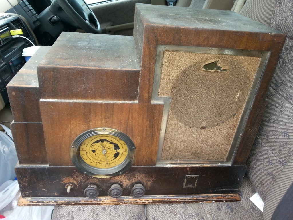

I've wanted one for a long time and this one just fell into my lap... I ended up paying over double what he wanted for it - because he sold me a few other radios for good prices and because I felt this was worth at least what I wanted to pay, but well more than he wanted. Call me mad, but I just couldn't steal it and then enjoy it.
[Image: http://i241.photobucket.com/albums/ff222...5nrqsr.jpg]
Unfortunately, it wasn't until I was looking at it in the car and thought, "6V6GT output tube, what the?..."

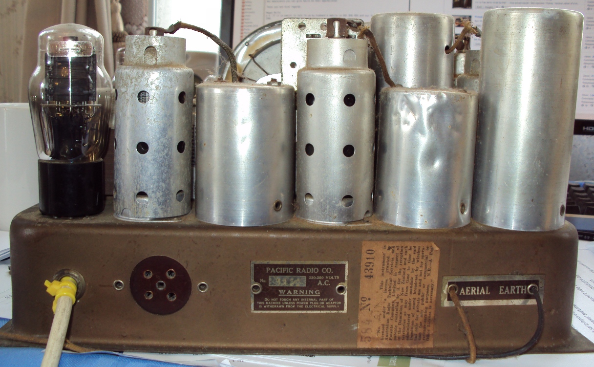

The chassis is originally from a 'farm set' - given the tag on the back. I ignored this because it all looked wrong - but the radio is most likely from Central Otago - a remote (by NZ standards) gold-mining and farming area back in the day... they never got mains power until very late in the piece, so its possible that the service tag was modifying the radio for the new fandangled 'lecy-tricle wires that they got. The 2V filament setup is gone, a power transformer added - and then a second one for a 5Y3 underneath - the chassis has been cut up to accommodate this. New sockets have also been fitted, rather shabbily it seems. Add to this that the IF cans are not a good fit either - so they might have been replaced.
[Image: http://i241.photobucket.com/albums/ff222...ip3qkf.jpg]
[Image: http://i241.photobucket.com/albums/ff222...cmvmsa.jpg]
So, it could indeed be a standard tag for the cabinet, with a farm set chassis fitted (I'll look into the chassis that were available in that era from Radio Corp NZ and see what might fit). That chassis has then been heavily modified to suit mains at a time when more modern tubes would have been available to replace the old battery ones.

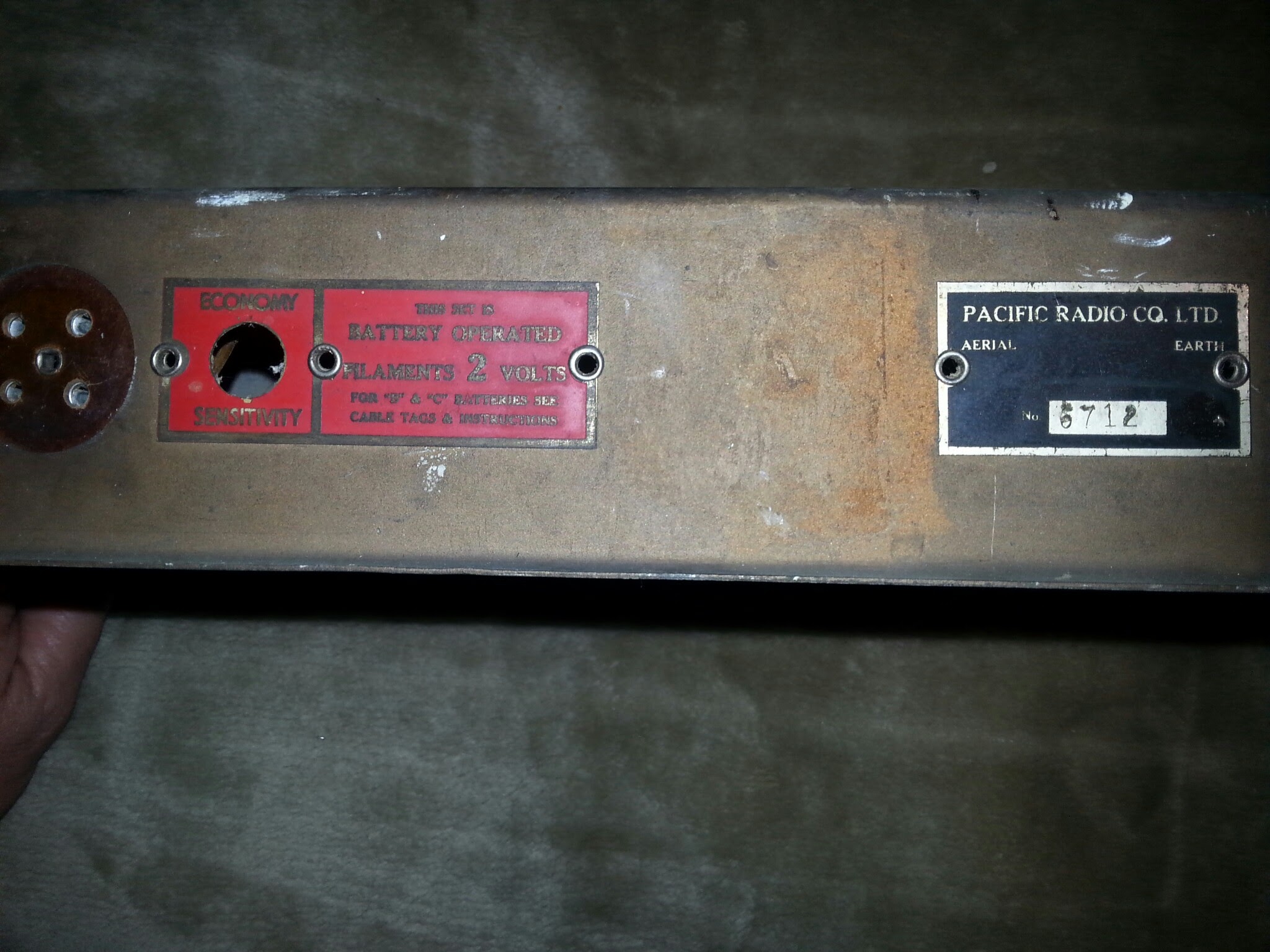

First - I don't think, given the volume of radios that Pacific sold and the quality of them that they would have sold this originally as a battery set. The speaker install is shonky to say the least, with very roughly gouged out timber to make it fit - and that coupled with the valve card... well, I'm just not buying it. I think someone has installed the 7B1 battery set chassis and speaker some time later... maybe it was a city radio that went to live on the farm and had a transplant for that role... until the farm got electricity and then it went for a retransplant - but instead of seeing a doctor they went to see a butcher.

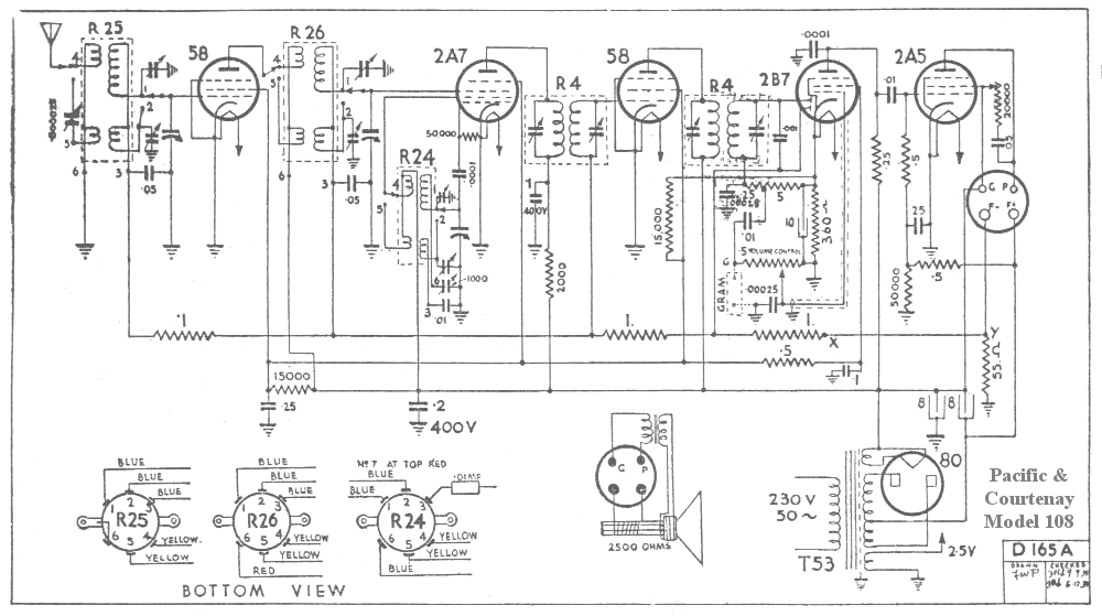

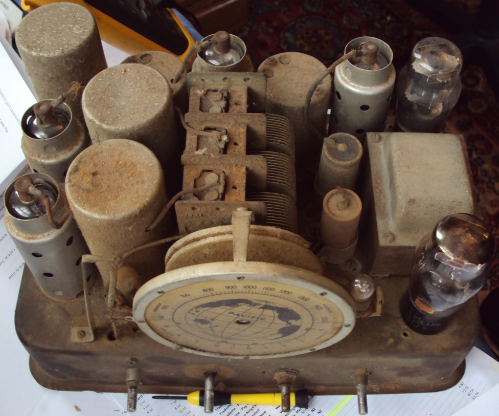

Second - I have a possible schematic. This one uses 2.5V versions of the valves but otherwise seems very likely. I have a RCNZ chart which shows the 108 was the first 'aero-dial' chassis that Radio Corp of NZ made (in 1934). Given that a lot of other sets with RCNZ chassis' still had half-moon dials at that time and even in 1935 then this just seems to be the most likely option based on the options I have. All these valves are direct replacements for the lineup on the card - just lower filament voltages (from what I can tell) - so presumably the schematic would work if I just replaced the valve codes with 6D6 6A7 6D6 6B7 42...
Third - I've found someone... well, not just someone but the actual owner of the Pacific Elite that caused a stir on the ARF when it went up for sale a few years back. For those who don't know - this is the Pacific Elite:
This is important because its the same year, same valve lineup, same dial, same knobs. 99.9% certain this is the same chassis that mine would have had. So I have a 'pattern'.
I was able to track down the owner of the one who's photos are used in the RadioMuseum listing for the Elite using a bit of sleuthing. He lives at the other end of the country but has said I'm welcome any time to come and check his one out and take photos, trace the schematic etc. Awesome. He's also provided me with a couple of photos which help.
This tells me a few useful things:
- The badging I have on my chassis is for a battery set and is not the same as the mains set
- The dial light mechanism is different between battery and mains sets
- The valve shield bases are different to most RCNZ chassis' and look like the Philco ones that get mangled to fit metal valves in (what model do they come from? I wonder if they would be suitable donors).
- My battery set chassis will not do the job.

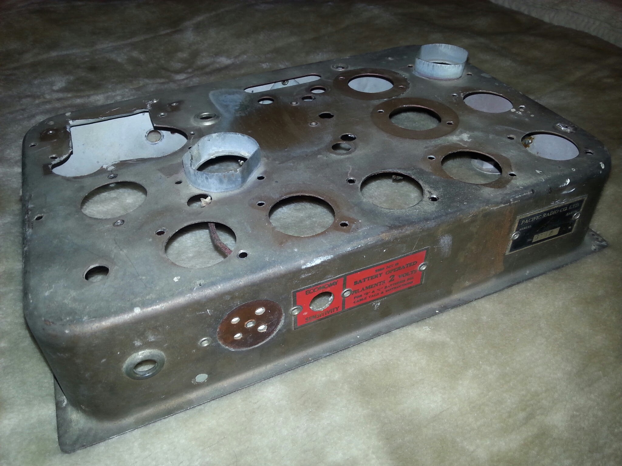

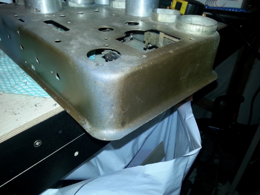

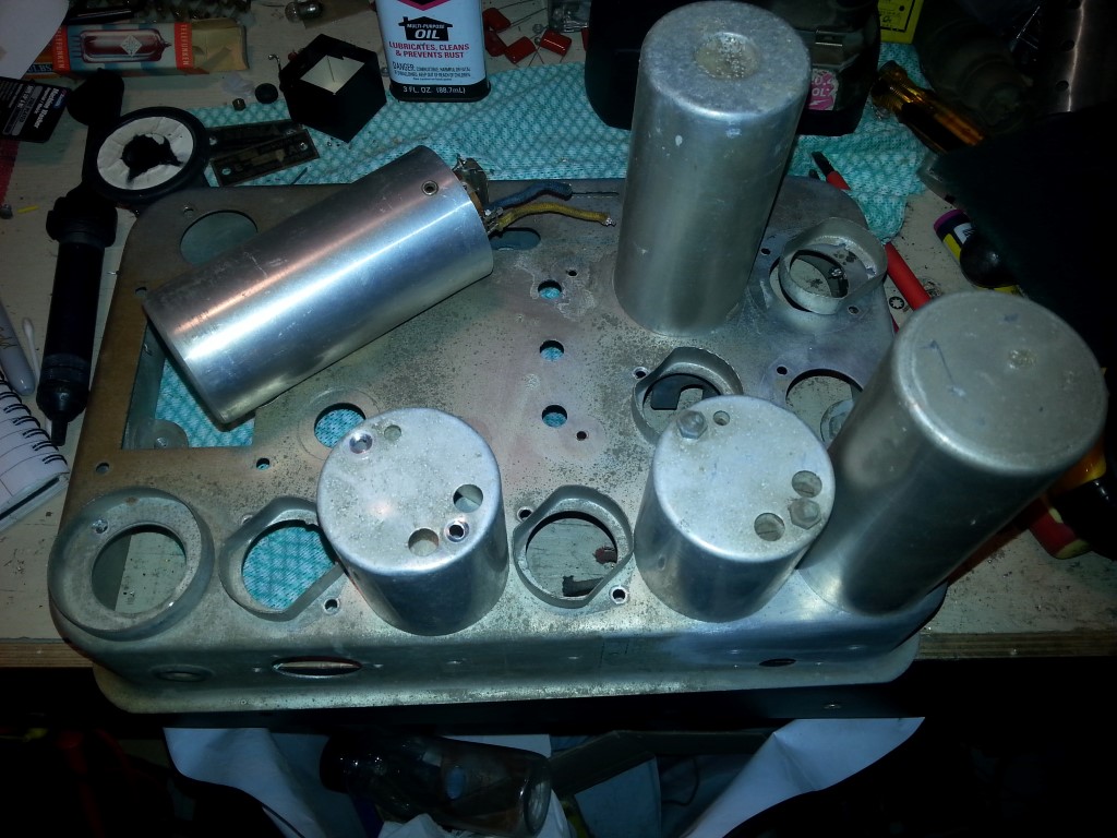

So I stripped out the chassis that was in my radio. It was horribly done... so I feel better now its beautifully undone. And I might build it one day if I can find 3 suitable IF cans and a P-P transformer to suit a 19 tube.
And I bought a can of automotive lacquer that matches the original paint (a metallic dark-ish gold), then tested it on the intended donor chassis (a RCNZ model 18 chassis - relatively common, from a junk radio with a near-destroyed cabinet).

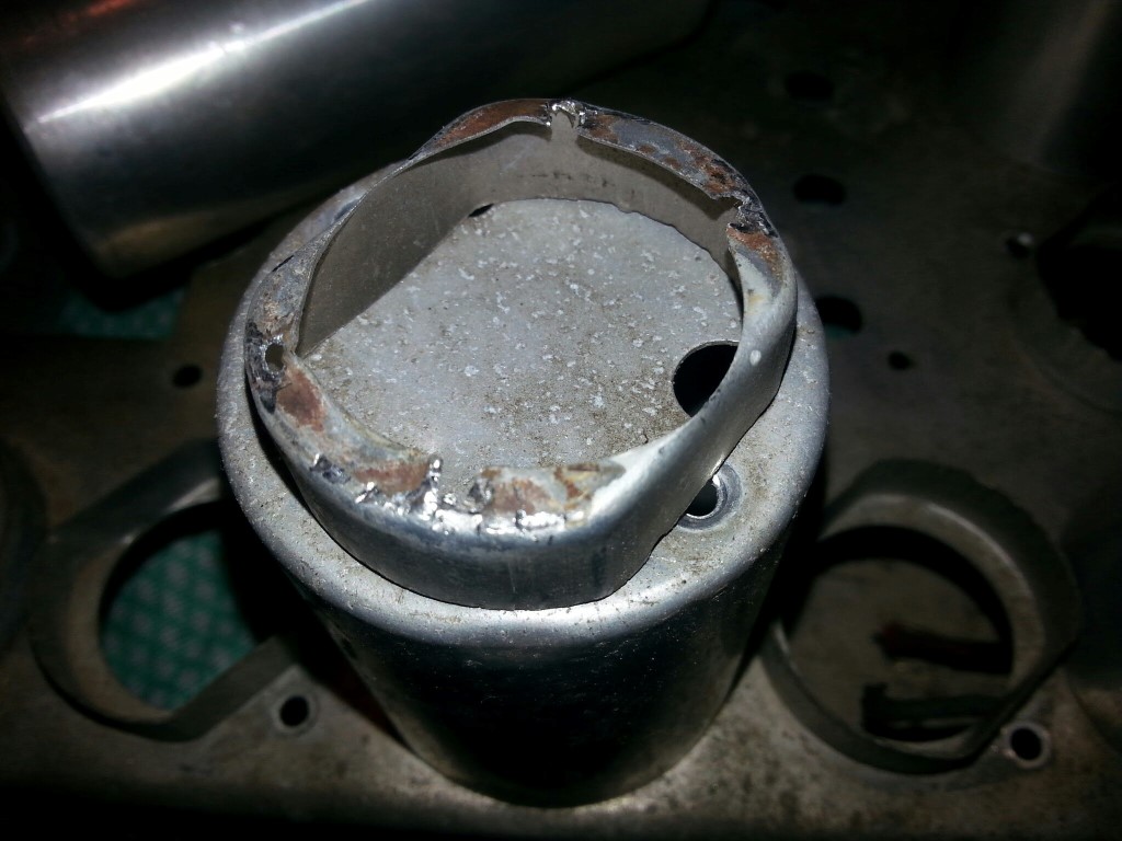

Then carefully prised the 4 spot welds apart to get the valve shield base from where the coil can needs to go, and tried the coils for fit
I'm using 2 old IF cans with the same layout as the originals that I got from an old parts chassis - they're too short but I might have some others I can use that are taller. I only have 2 coil cans that don't have dimples in the top though. Almost all RCNZ-made coil cans had a dimple in the top - but these Pacific ones did not. I'll have to ask around and see if I can find one more suitable can.
Thats about as far as I have managed to get at this point... but I'll keep you posted with progress.

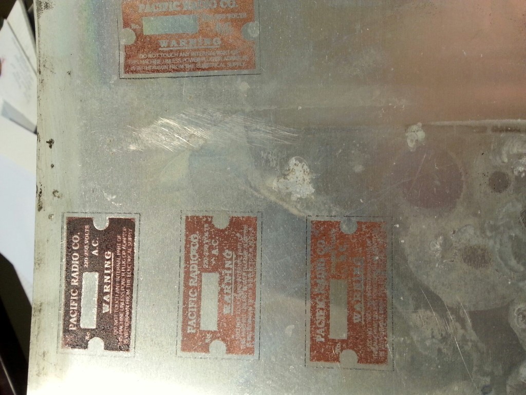

One other thing I have done is try to duplicate the chassis badges.
The best one was done by ironing a reversed colour laser print of the artwork (which I recreated in Inkscape) on to a thin piece of aluminium, then soaking in water and carefully rubbing the paper off... the others were done with various different acetone methods and didn't work that well. I'm still experimenting with this to try and get a good transfer.
