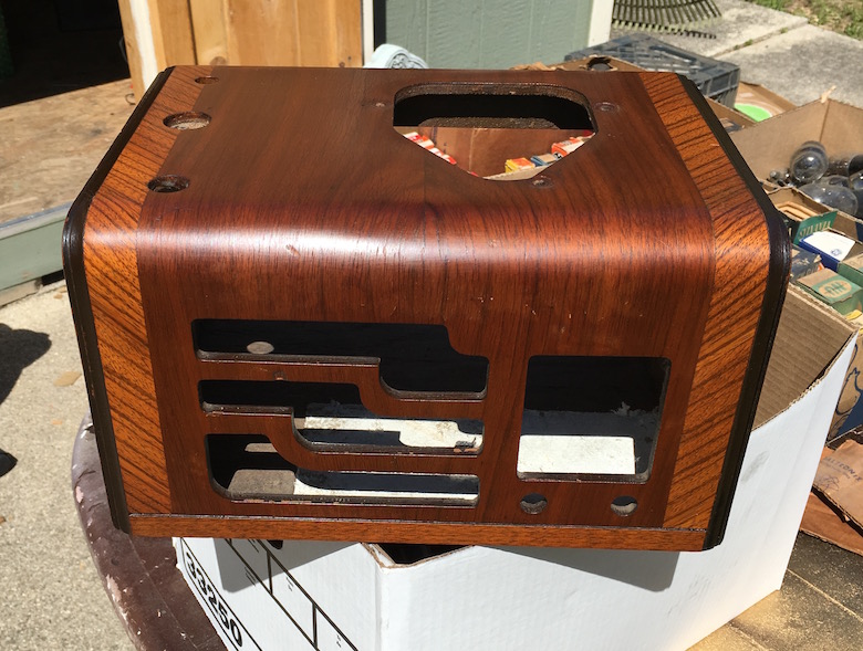

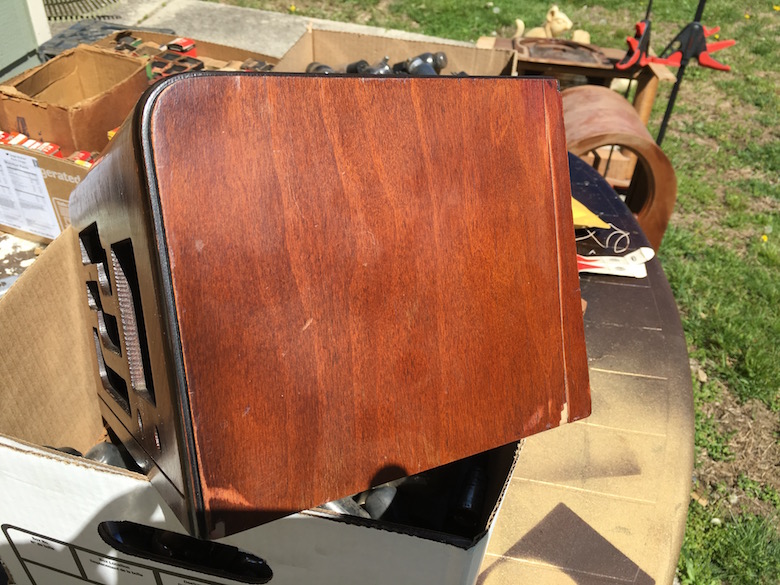

Ok,
The front had a design of flowers but that was easily removed.
The one side has a veneer lift that someone glued but it was not level so it sanded through the toner.
I would love to spot repair it but that is up to Sam.
I will strip it down and re-tone it tomorrow..
See Sam, It's not all about Mike

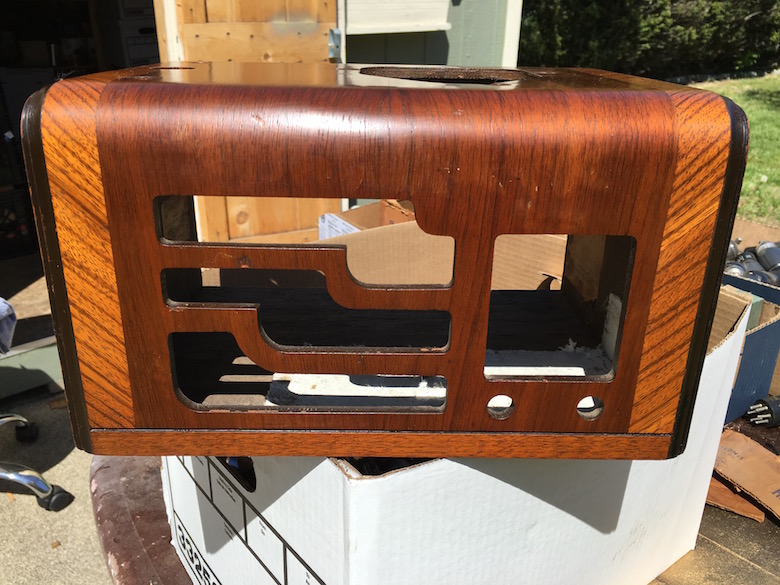

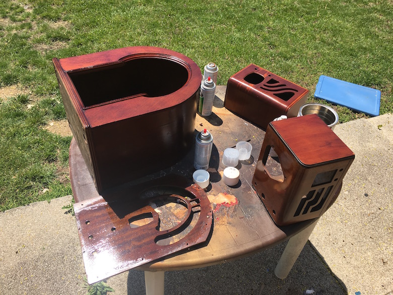

I am taking full advantage of this day!
I got up at the butt crack of dawn and started on these 4 cabinets...
I ended up stripping off the side finish as the sanding was too deep for me to color match.
I re-toned it and am now clearing the whole cabinet!

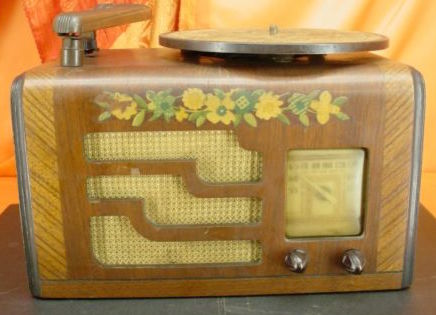

Decal is all gone Sam!
Image(s)
AC: 4 DC: 1
Posts: 7,303
Threads: 269
City: Roslyn Pa
Still looks like it's there???

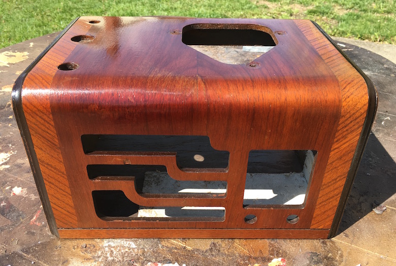

Done 99%
I cant rot or buff out the finish. The curing process needs mucho time so you will have to wax it up in a fe weeks Sam.
