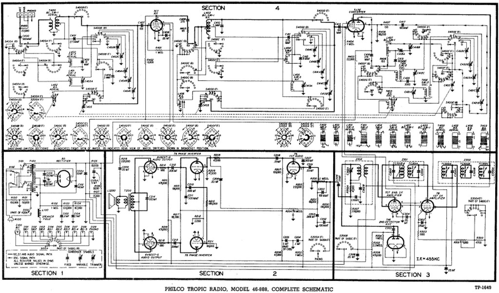

I have attached a copy of the schematic, for those members who are not members of RadioMuseum.
I tried using Photobucket as recommended, but when using a width of 900 pixels, the size was about half the size when using an attachment. If anyone would like a clearer copy, send me a PM or email.
