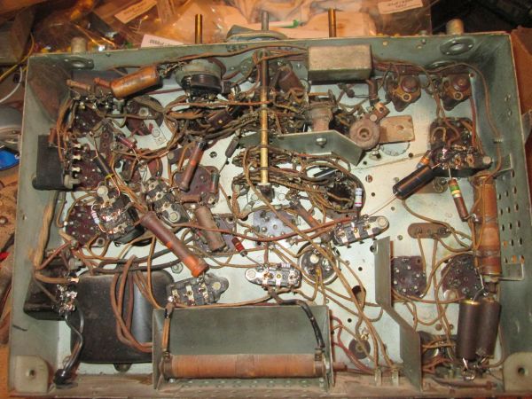

Spent a good part of yesterday melting tar (rebuilding bakelite caps) and measuring resistors. Didn't find many that where within the 20% tolerance. A couple of the paper tubular caps rather than restuffing them they got a layer of Scotch #33. Don't really like the yellow look. For #93 & 94 (plate bypass for the 42 output tubes, .006 @ 1000v) used a couple of .01's in series = .005 @ 1260v. Those I slipped the old cardboard tube over. Have two or three more bakelites to do over in the detector/avc circuit.

Powered it up late last night and found that off/on switch isn't working, was kinda stiff before so will have to give it a good cleaning. Hot wired it and got power. Power supply is working fine but radio has some issues. Volume is low and no reception just background noise. Fed a 460kc signal down the IF and seem to be working. The LO I'm not so sure as I'm getting several oscillation and it doesn't seem to be mixing. Did use the generator for the LO and was able to tune in some stations but where nowhere near where they should be on the dial.
Going to focus in on the audio/det stages to see what is causing the low audio and the osc/mixer. Maybe an out of alignment issues but most of the time I'm not that lucky!

I didn't mention last night I had a little fireworks. 91 the dual mains bypass cap blew it's top BANG!!!!! So that was exciting. I haven't done an ortopsy but I think I may have over heated one of the leads inside the bakelite block when soldering on the outside connections. One of the leads may have been touching the outside of the other cap and with some heat added it could melt the yellow mylar and shorted to the foil innards.
After poking around a bit I found that the plate voltage on the mixer and 1st IF was low like 80vdc, should be 200vdc. Did a little investigation to find that I had done a little miscalculation. #47 is in parallel with the shadowmeter coil and is 2000 ohms. I replaced it with a 2300 ohm resistor. At first thought I was thinking that 47 was used to set the amount of current thought the shadowmeter's coil. Make it higher and you'll get more deflection lower and you'll get less deflection. But upon looking a bit closer it also controls the plate voltage for the mixer/IF amp. With a good coil and resistor you should have about 800 ohms. My coil is open. I had 2300 ohms. Replaced it with a 750 ohm resistor (had it on hand) and did some voltage check, things looked a lot better.
Flipped it back over and realigned the IF stages. Before didn't have much gain, had to crank up the output of the generator to get a signal and the adjustment didn't peak very well was really broad. With the right voltages the peak is much more pronounced and have the generator output all most all the way down. All this is good!
Had pulled the 76 tube out while I was troubleshooting put it back in and hooked my 25ft test ant (cord for the Eletrolux sweeper) and we got stations!!!. Volume is still a bit low and volume control is dirty so it's next on the list for cleaning.
The bakelite block inside was ok no shorts but the outside, one of the terminals was burn off. Thinking it was some solder splatter or something. Put it back together is work fine. Cleaned the volume control and lubed the switch. reinstall and works good now.
But have a couple of other issues. Screen voltage on the rf/mixer tube is low about 45v should be 80v. The dial cord for the dial mask broke and audio has some hum. Pretty sure it's coming from the det/1st audio stage.

Restrung the cord for the arrow mask and started in on the SG voltage problem. After half a day of troubleshooting I found that I had installed a wrong value resistor. Now the screen buss is up to 75v. Hum was found to be a bad resistor over in the tone circuit. Also had an intermittent, volume would change all by it self. Was a bad connection at the ant post. Disassembled the spkr plug someone in the past did a bad job repairing the wiring. Cleaned it up evened up the wires and add some heat shrink tubing to give it a bit of strength. I was playing with it a bit and changed the value of #14 and it improved the high frequency response of the audio. Sound really good!

Turned this set on and got a low hum and after 15sec the 80 tube's plates are starting to turn RED, their not suppose to. Quick turned it off and hooked up the voltmeter to the hv. Should be about 350v was 125v, that's why the 80 was getting an angry red. Personally I like a dead short there much easier find. Ones that have a few thousand ohms across the hv are a bit trickier to locate. Started to disconnect some of the resistors feed the hv to various stages, It's not there. Ungrounded the filter caps and bypass cap, their ok. Next I started unplugging tube all but the 80. Magically the hv jumped up to 350v.Hmmmm.. Reinserting the tube one by I got the last one, one of the 42 output tubes. It sucked the voltage down to 125v again. Replaced the 42 and all is well I though.
I wanted to go though the rf alignment to make sure it's working on all band and such. The BC band was in good alignment. Checked over the police band. Philco sez to set the upper end of the band at 4.5mc (there is no marker at 4.5mc however there is one at 4.6mc) a little odd but I can count. Did the LW and SW bands. Now the trimmer to adjust these are not laid out very logically so I may have tweaked one that I had already adjusted. Anyway went back to the bc band and now at 1700kc I'm picking up a local at 1210kc. Low end is good 600kc is still at 600. The upper end is only tuning up to 1210kc = lo is operating from 1010kc to 1670kc. It should be working up to 2160kc. Somewhere I lost 490kc. After checking connections,bandswitch, trimmer cap and coil. I'm coming to the conclusion that the coil is bad but two things bother my about the coil prognoses. Darn thing oscillates and it has a low resistance (about a quarter what the diagram shows (1ohm verses 4.2) The high end trimmer (29) has very little effect on the frequency about 1kc or less throughout it's range.

The red plate in the rectifier has reared it's ugly head again which is starting to annoy me a lot. B+ was down to 150v or so. This is getting tiring really tiring! But it wasn't the 42 tube it was the tube socket that I replaced, it was arcing though the thin wafer up to the chassis. Found 20 replacement molded sockets for a buck a piece. Should be here by the end of the week. I may do some more work with the coils and just leave the socket disconnected till the replacements get here.

I was right the hole was too small to fit the socket from the top so I enlarged the hole about 1/32" and was able to get it in. But now the issue is that the chassis thickness makes in darn near impossible to fit the retaining washer in place. So now I'll have the enlarge the hole a bit more so I can fit it from the bottom with the mounting bracket underneath. Removed the other 42 socket too so I won't have an arcing problem from the other socket.
