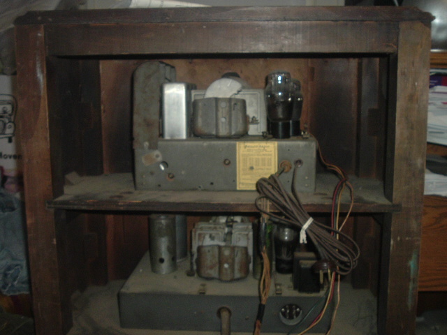

some one over the weekend gave me what is a philco 470. but someone has made some changes to it. they made a new front for it and put a philco 51in it. But I do have all the parts to restore this I just need to make a new front. Dose any one have a pattern or dimension's or may be even a tracing of the front. I have enclosed some phots sorry I am not sure why they are side ways
Ben
Hi Ben,
Are you sure this was done after the fact? There is some possibility that it came from the factory. Before you make the decision to replace the panel and chassis you may want to post some pics of the cables going to each chassis. any tags, power transformer(s) and top/bottom of both chassis.
As Ron mentions the convertor should not have it own power transformer as a stand alone model 4 convertor would. The power transformer in the 51 would be a bit larger because of the higher current requirement for powering both chassis. You say you have the parts to replace the 51 chassis with 70 or 90. But those chassis would need to have the larger transformer too.  I suppose if you had a 70 and a 90 you might be able to replace the 70 transformer with the one from the 90 and use the 70.

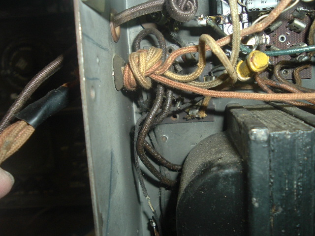

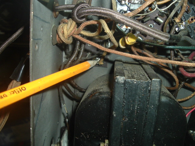

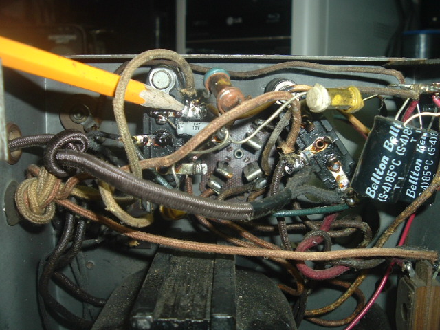

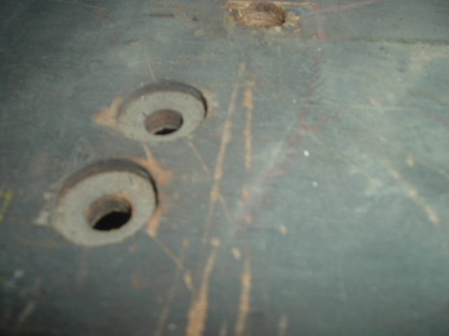

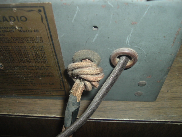

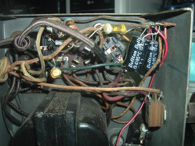

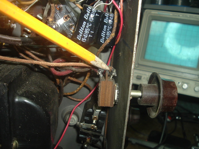

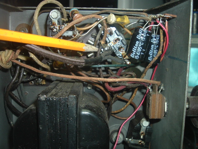

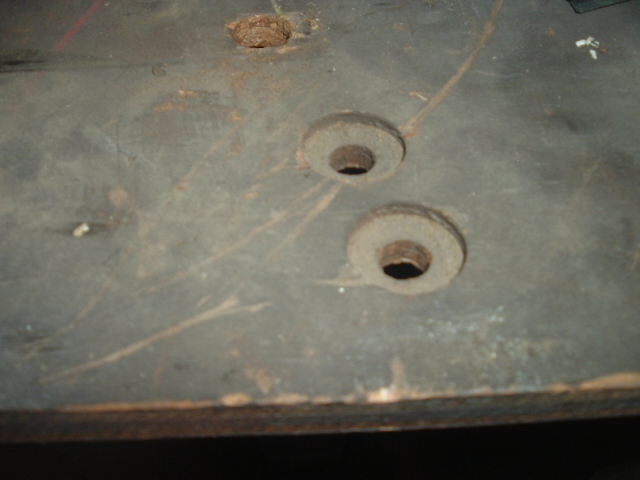

ok every one it looks like this was add I have included photos 1 and 2 show the hole for the model 70 and 90 and then the drilled holes for the model 51. photo 3 the wire form the plug goes to the 47 tube. photo 4 on and off switch. photo 5 goes to the cap number 28 and 6 the wire goes to a bake lite cap that I think was added it goes to the to the power cord and transformer
I had to carry this to a new reply for some reason. I also checked the service bulletins and the power supply for the 470 and the model 70 look to be the same and so do the power supply for the 490 and the 90 and it looks to me that the 490 used the chassis that used the one 47 tube correct me If I have made a mistake I also have the stand alone model four but I need a cabinet should I put a post in the want to buy section
