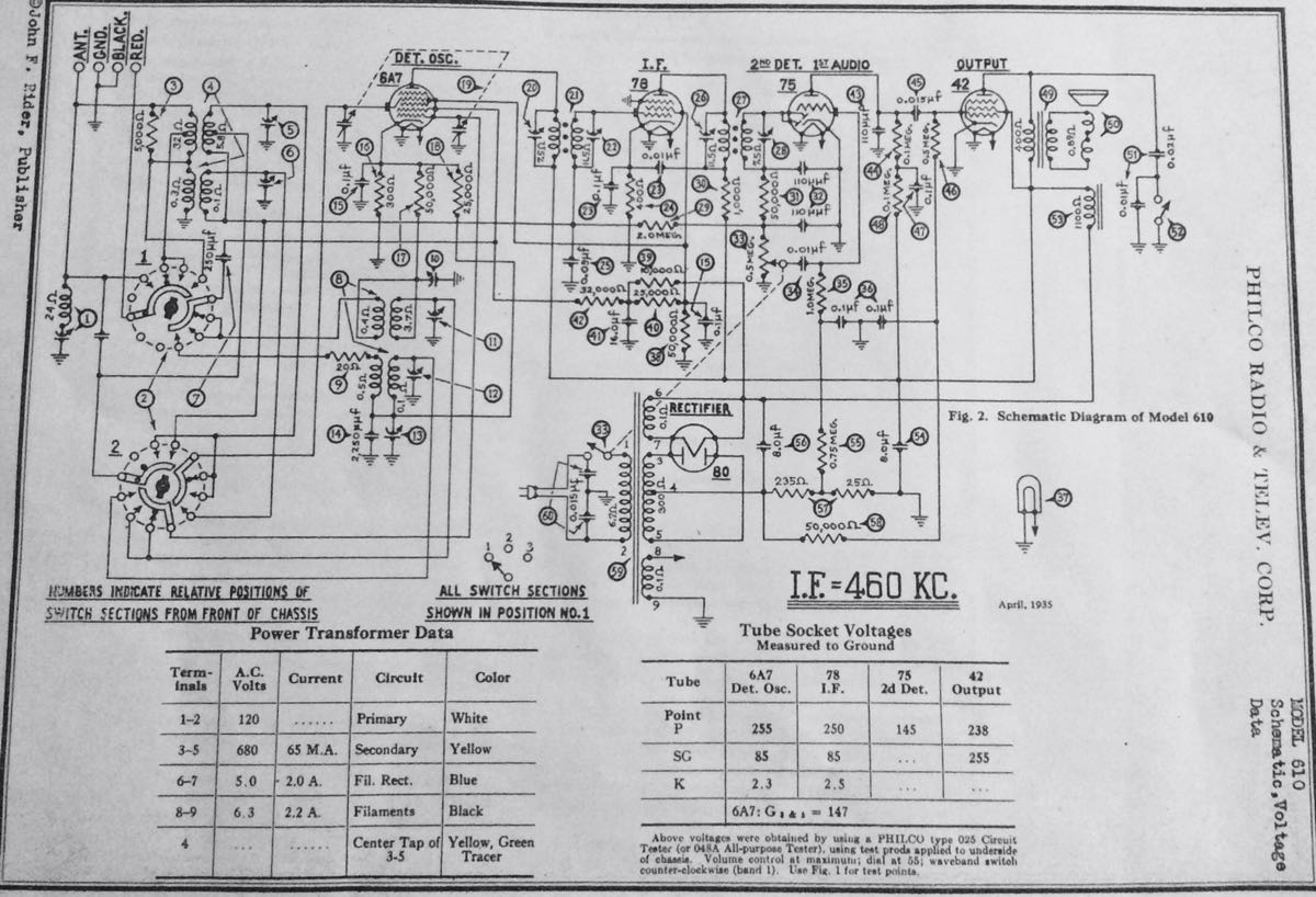

How do I know from a schematic which pins are which on the tube socket sitting in the chassis? The heater pins are easy to identify because of continuity testing and they seem to be larger diameter but what about the others? I can't always trust tracing the circuit because the radio came to me non functioning and the circuitry doesn't appear to be correct in some instances when looking at the schematic. Is there a clock position that's always constant or something? -thanks

Thank you for the education on this. Are you saying with your last sentence that if the schematic, like the one I posted, doesn't have the pins numbered that I can't necessary refer to that layout? Stated another way. If the two fat pins is for the heater and the one thin one to the left of the heater on the schematic shows it connecting to a grid that the socket sitting in my chassis might actually be something like the plate? I suppose I should refer to the materials shared above as the "gospel" truth for that tube pin layout. - This could be why I am second guessing the circuit.

Here's the difference between the Philco schematic you have posted and the pin-out diagrams in the databases:
[Image: https://dl.dropboxusercontent.com/u/5462...UBE101.jpg]
The Philco schematic is on the left and the pin connections as seen from the bottom of the tube are listed in RED numbers.  You need to look at the actual elements in the tube, i.e. the plate (pin 2), the cathode (pin 5), the grid closest to the plate (pin 4) etc.  The grid cap on the top of the tube is unnumbered.
Hope that helps.

Yes that helps tremendously. I see why I was getting so confused. In this example I was looking at the pin to the left of the cathode ground (pin 1) thinking that it was either pin 2 or 6 and it wasn't lining up when I traced the circuit. I guess they laid out those schematics in the easiest way possible and not actually by order of pins. Thanks for the image. That helped clarify things for me.

Well, I spent this evening with tube print outs and the information you guys gave me and all the circuity is lining up now. Bakelite blocks were removed from my chassis and some resistors and capacitors were soldered directly to the tube socket making things difficult for me to follow. With everyone's help I'm able to figure out what's been changed now. Good stuff. Thank you again!
