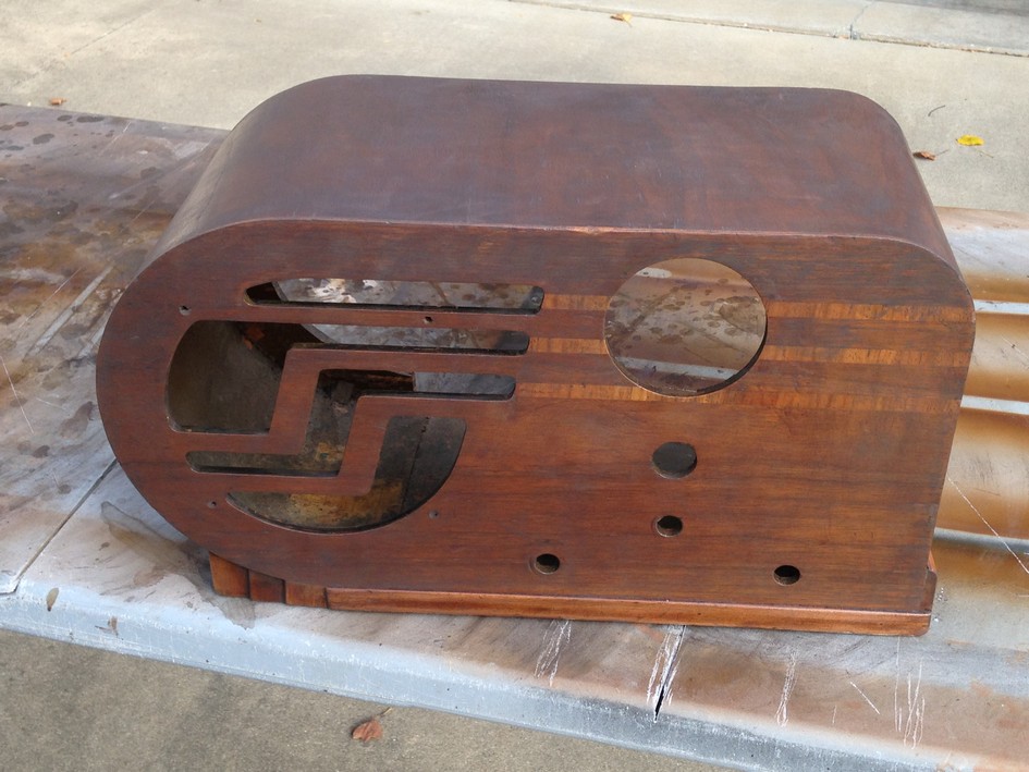

Left side:
[Image: http://www.philcoradio.com/images/phorum/37610_002.jpg]
There was a deep groove in the bottom trim which I filled with wood filler. A small chunk of the back corner of the trim was missing; this, too, was filled with wood filler as you see in the photo above.

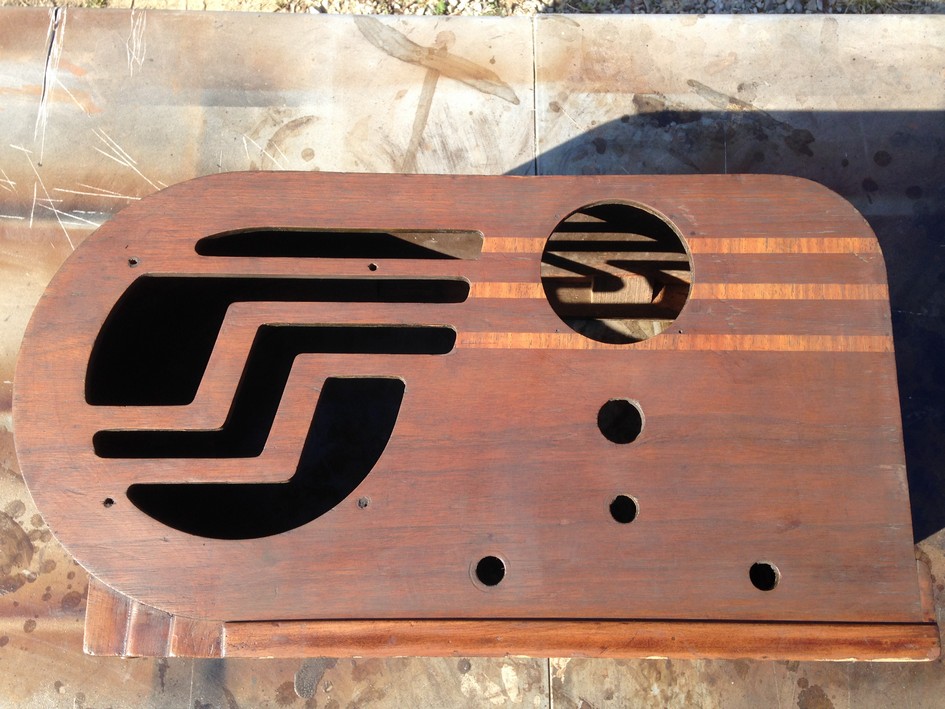

Front:
[Image: http://www.philcoradio.com/images/phorum/37610_004.jpg]
Some deep faults in the upper right corner of the front panel were filled with wood filler. Later, I will attempt to touch up the light areas with some Medium Walnut toner - but only after the cabinet has been stripped, sealed, and grain filled.

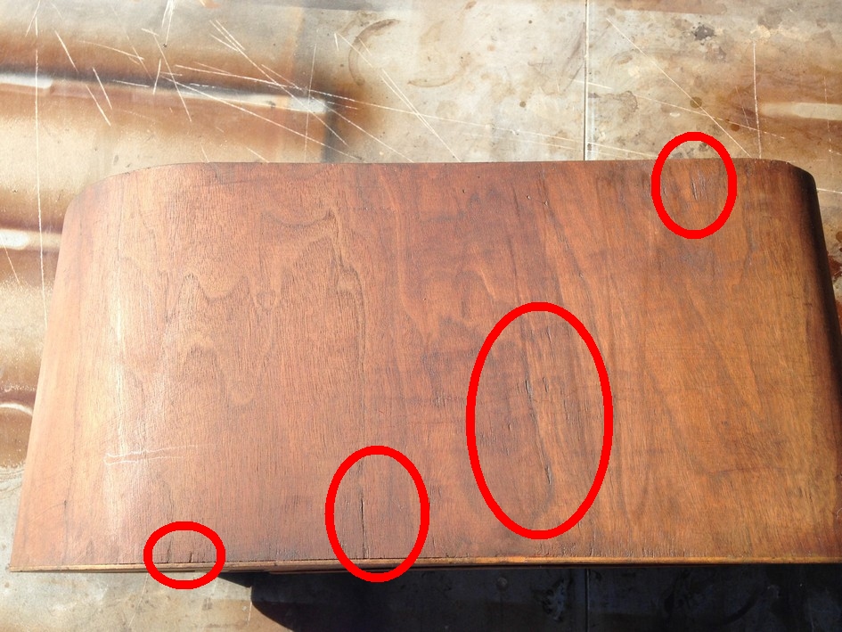

Right side:
[Image: http://www.philcoradio.com/images/phorum/37610_003.jpg]

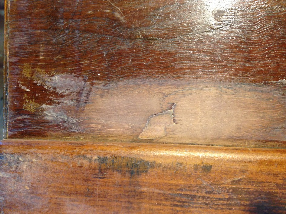

There was a large depression where you see the piece of veneer. The cabinet had been hit with something, pushing the wood in. I thought about what to do about this before deciding to glue on a piece of veneer, and then try to sand it until the veneer patch more or less blended in.
more to come...
Edit: For reference, here are the other two cabinets I worked on this year.
Part I: Bozak E-300 Speakers
Part II: Philco Tropic 42-788

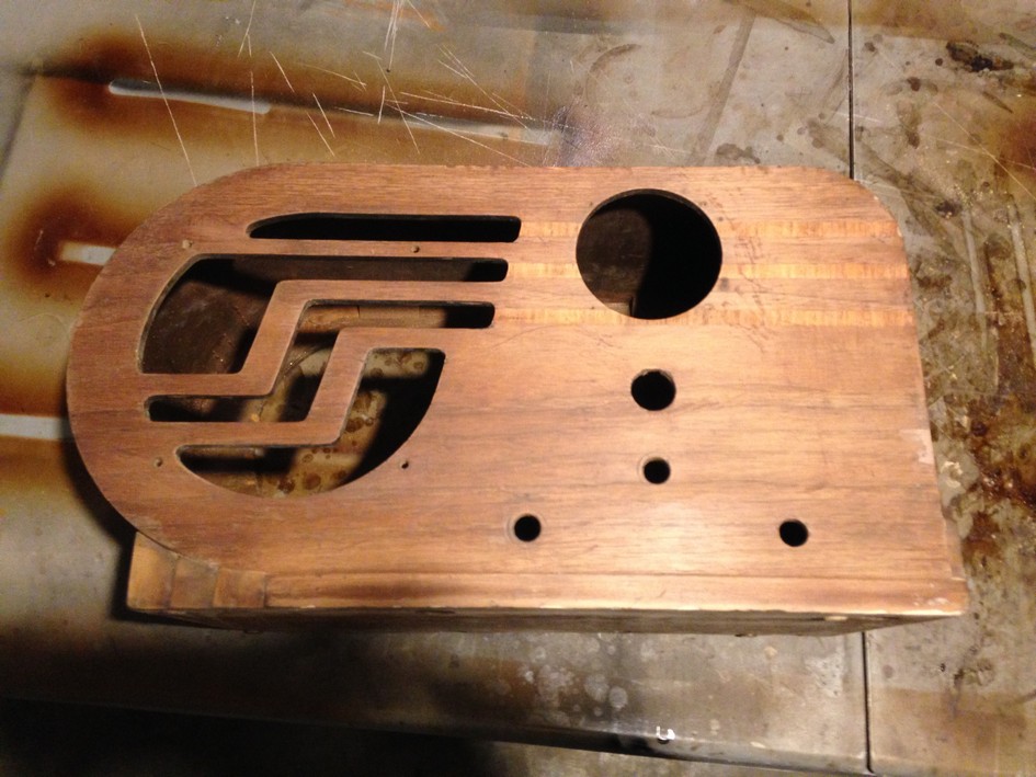

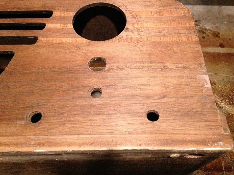

After sanding...and sanding...and sanding...until my thumb was bleeding...
[Image: http://www.philcoradio.com/images/phorum/37610_005.jpg]
Not perfect, but it looks better than it did with the damaged spot.

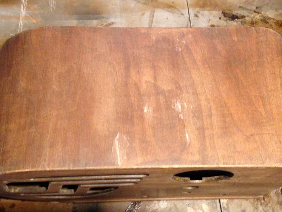

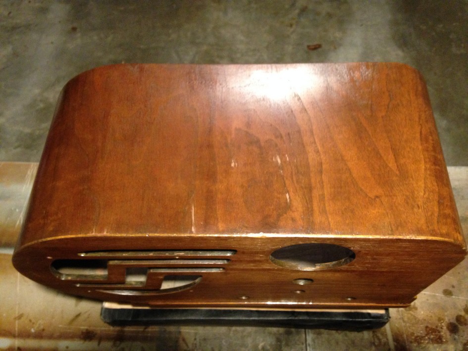

After stripping:
[Image: http://www.philcoradio.com/images/phorum/37610_006.jpg]
Not bad...but stripping the finish in combination with the bright sunshine revealed...more flaws!
Uh-oh! Spaghettios!
[Image: http://www.philcoradio.com/images/phorum/37610_007.jpg]
[Image: http://www.philcoradio.com/images/phorum/37610_008.jpg]
The gouges in top can be easily dealt with by using walnut color Timber Mate...but what about the veneer damage on the front panel?

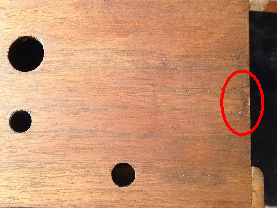

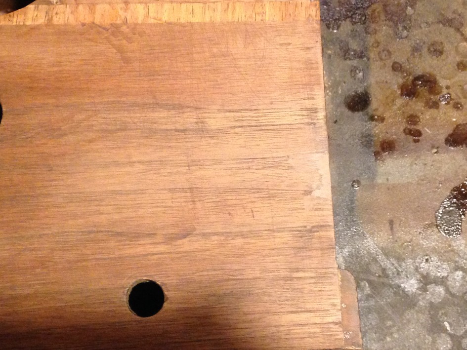

How it looks now:
[Image: http://www.philcoradio.com/images/phorum/37610_009.jpg]
The Timber Mate where the missing veneer was on the right edge of the front panel:
[Image: http://www.philcoradio.com/images/phorum/37610_010.jpg]
I think I might get away with carefully drawing in some faux grain with a black ink pen.

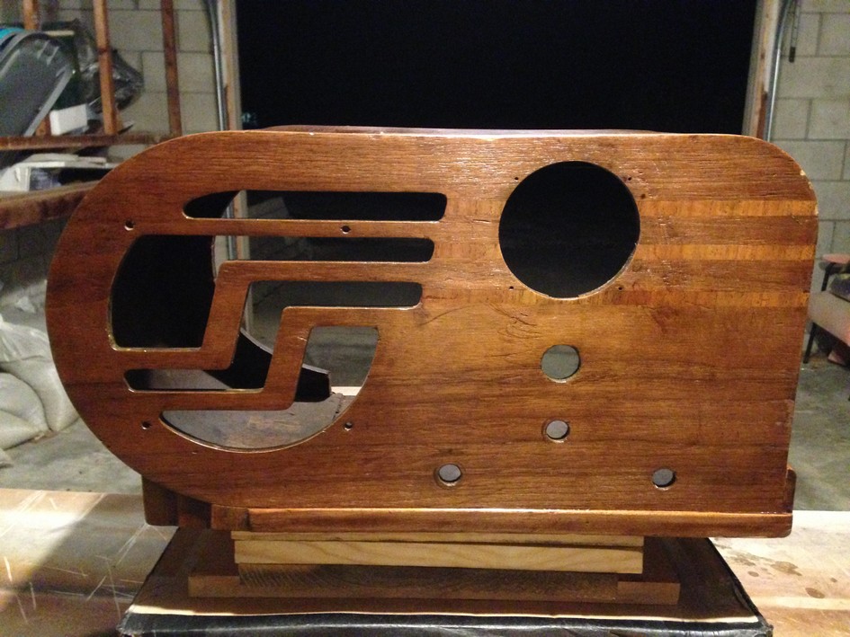

Well...
...let's spray sanding sealer at 10 pm!
[Image: http://www.philcoradio.com/images/phorum/37610_013.jpg]
[Image: http://www.philcoradio.com/images/phorum/37610_014.jpg]
[Image: http://www.philcoradio.com/images/phorum/37610_015.jpg]
[Image: http://www.philcoradio.com/images/phorum/37610_016.jpg]
It was exceptionally...unusually...warm at 10:30 pm tonight. I opened the garage door to let the house garage air out before taking these pictures. After being somewhat cool the past several evenings, it is really warm tonight!
The first coats of lacquer always highlight a cabinet's flaws, and this cabinet has several. However, I think I'll take the flaws over tossing this cabinet in the burn pile at Kutztown. Icon_eek

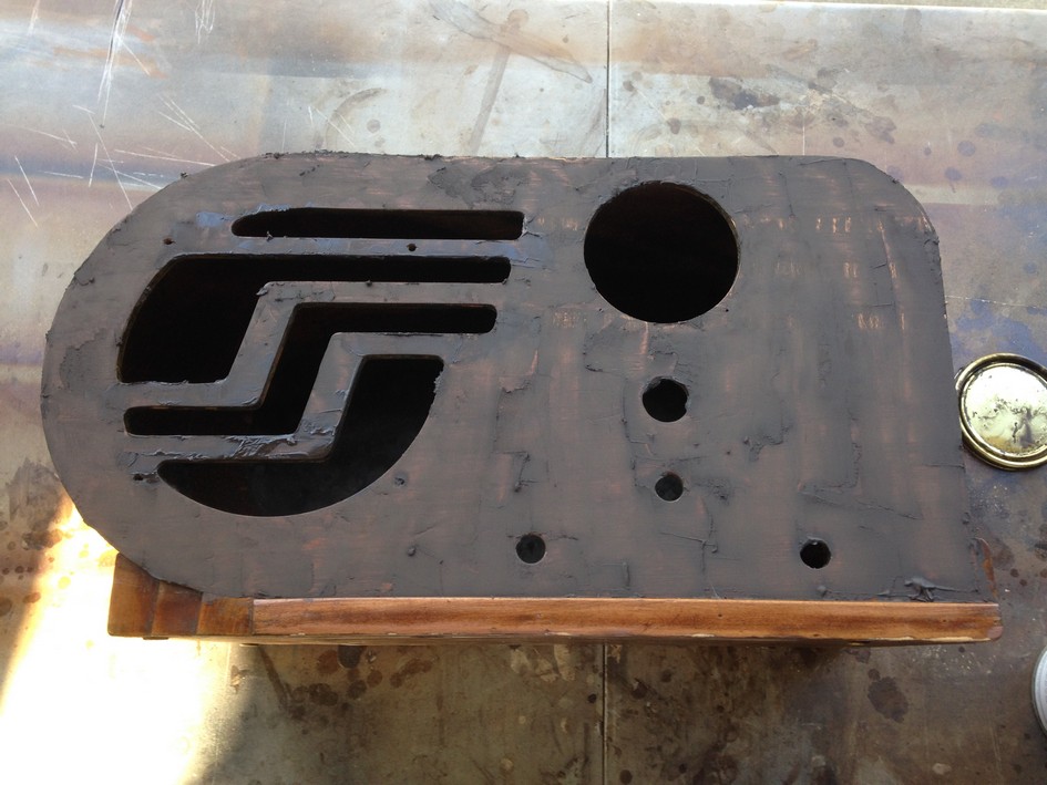

Here's the cabinet after application of grain filler on the front panel.
[Image: http://www.philcoradio.com/images/phorum/37610_017.jpg]
Letting the stuff dry to a dull haze, I then scraped it off at an angle, then rubbed it in with burlap. Sorry, Kirk, but I have lots and lots of burlap that needs to be used up...and it worked well for me three years ago.
How it looks now:
[Image: http://www.philcoradio.com/images/phorum/37610_018.jpg]
It definitely needs more grain filler along the top part of the front panel as well as the left side and some of the grillebars. The rest seems to be OK when looking at it in bright sunshine.
This wood really has large, open pores! Much larger pores than I think I have seen before.

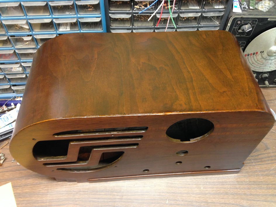

After work and supper, I began to sand off the grain filler residue.
I sanded...
and sanded...
went through three pieces of sandpaper as they kept getting clogged up with grain filler residue...
(yes, I did scrape off excess until the paper totally lost its effectiveness, at which poinit I switched to another piece of sandpaper, and carried on.)

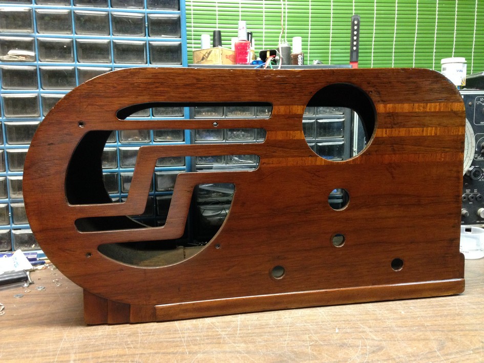

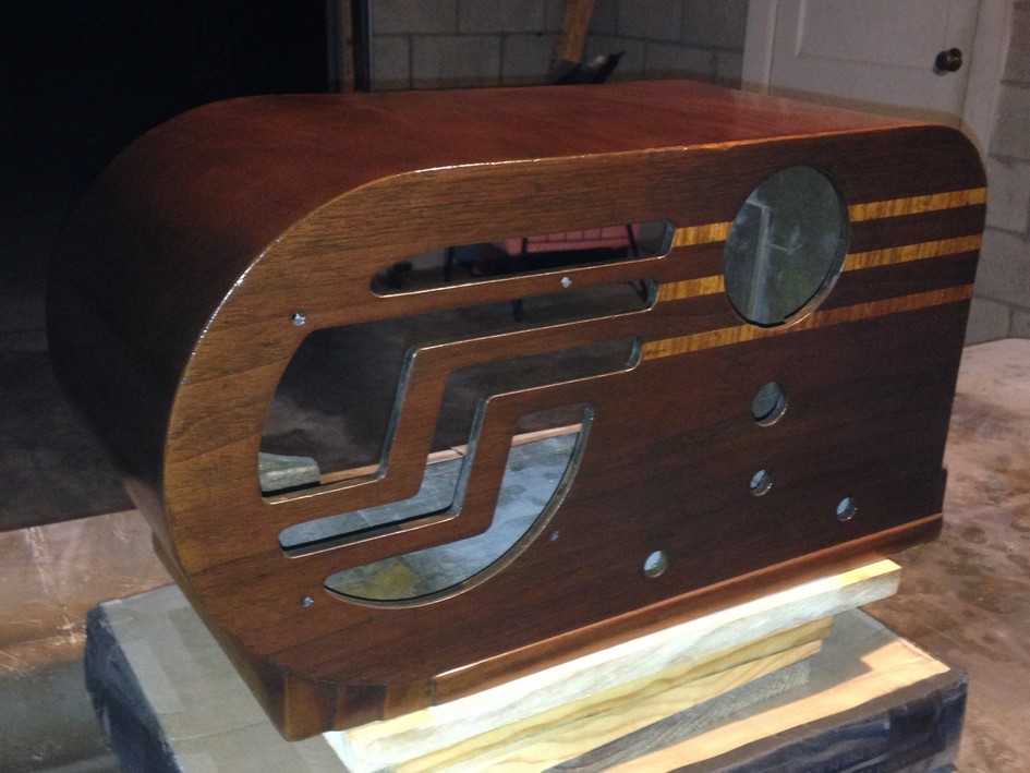

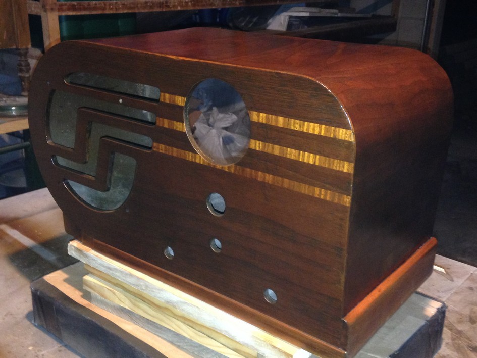

Finally, the cabinet was ready for Medium Walnut toner!

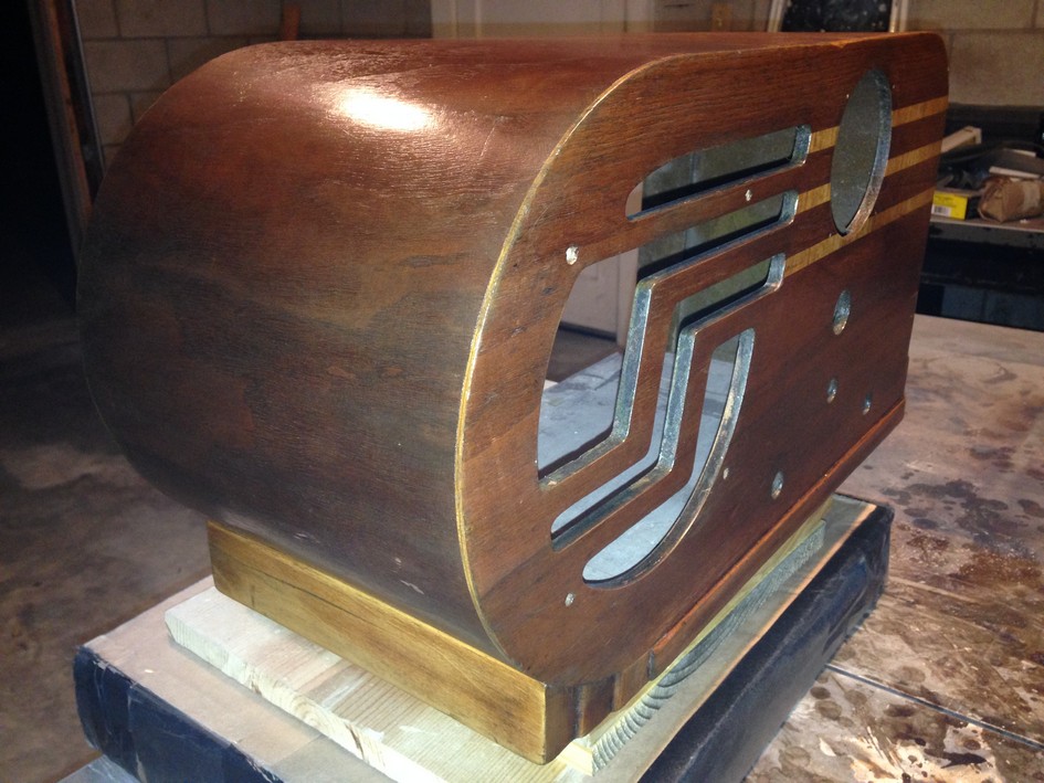

I applied two coats. Here's how it looked right after the second coat:
[Image: http://www.philcoradio.com/images/phorum/37610_020.jpg]
[Image: http://www.philcoradio.com/images/phorum/37610_021.jpg]
A little while later, out of the house garage and back on my workbench...
[Image: http://www.philcoradio.com/images/phorum/37610_022.jpg]
[Image: http://www.philcoradio.com/images/phorum/37610_023.jpg]
A bit darker than I wanted, but the wood was already dark and that affected the final color. (See post #7 above for a comparison.) In person, I think the color is quite pleasing. It will look even better once I get the Extra Dark Walnut on the bottom trim.
The flaws on the front panel do not show in the photos. It looks like some brat whacked it multiple times, and unfortunately that will always show. But as I said before, I consider it a rescue...beats putting it on the burn pile at Kutztown, eh!
On a good news note, the grain on the front appears to be 100% filled! Icon_thumbup I didn't get the grain completely filled on top as there are some areas where I can see some partially-filled pores. But I think after the coats of clear, sanding, more coats of clear, etc., that any remaining pores will be mostly filled and it will look fine (save for the flaws, that is).
