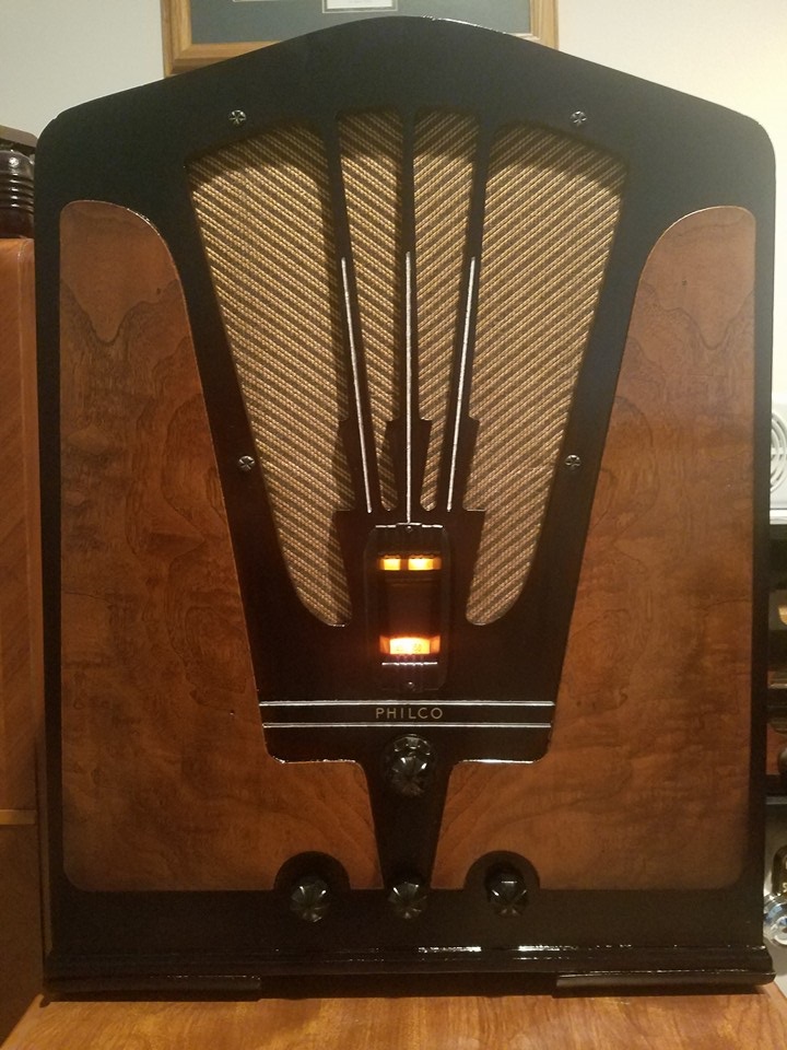

  After decal and 4 more coats lacquer. Don't know if I should just wait a few weeks and rub it out and polish or sand it again and apply more lacquer. Looks pretty good as is.
[Image: http://i1336.photobucket.com/albums/o654...4dknnq.jpg]
  I still have to paint the stripes on the front.
[Image: http://i1336.photobucket.com/albums/o654...6ealcy.jpg]

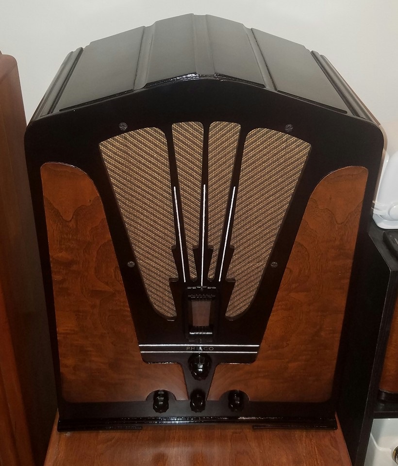

Very nice! Icon_thumbup
Just went through the same process in September on my model 16:

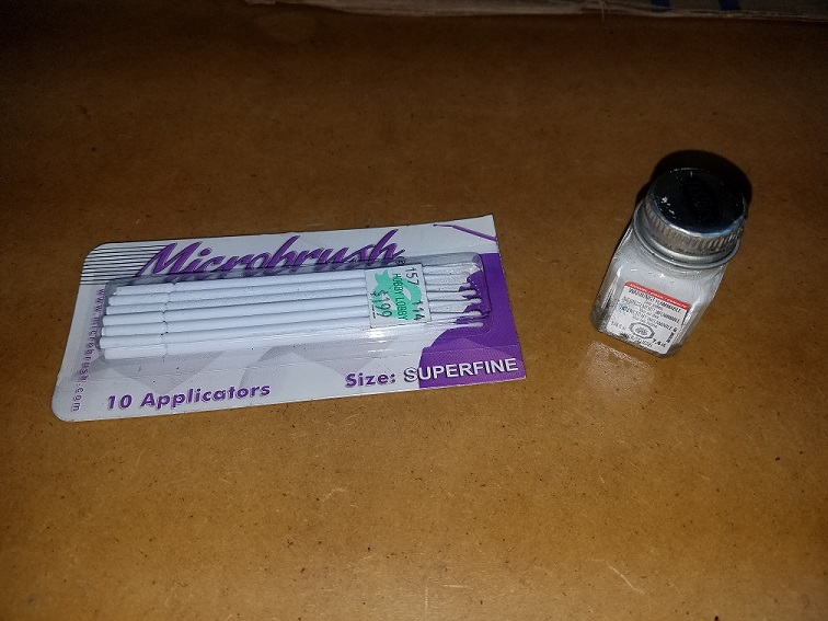

  Very good looking Greg. Icon_thumbup  These big cabinets are a lot of work , but I do enjoy it.  If I may ask ... what did you use to paint the ivory colored stripes with?
Thanks Mike. I actually used Testors gloss white and a microbrush to paint the stripes. Carefully masking the area around the stripes off using Scotch 3M 1/4 wide plastic tape. The Testors model paint 'flows' nicely in the grooves for the stripes with the microbrush.
Greg V.
West Bend, WI
Member WARCI.org
Thank you, I will give that a try.

Thanks guys. Just waiting on some grill cloth and should get it completed.
