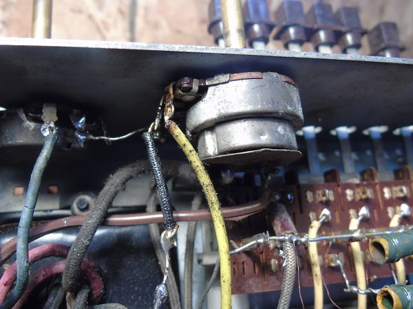

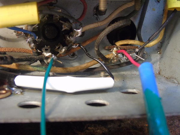

(11-24-2016, 06:03 PM)morzh Wrote:  C19 is from the minus of the battery to the GND, C21....no good way to describe but one end is at the top lug of the volume pot (if you face the rear of the pot and the lugs look down then the leftmost lug, if the lugs look up, then it is the right one) , and the other C21 pin goes between the two resistors on the sch.
here is a pic of the battery the red is positive lead and green negative correct or not
here is a pic of the volume control which one does c-21 connect to thanks
#64
The yellow wire. As I said, lugs looking up, the rightmost one.
#65
As for the battery I am not sure. The minus goes to pin3 which is the grid.
In your case I cannot tell as you have some octal tube in that socket.
It is actually a bit hard to look at photos without knowing what's what and try to extrapolate it to what it is.

(11-25-2016, 12:40 PM)morzh Wrote:  As for the battery I am not sure. The minus goes to pin3 which is the grid.
