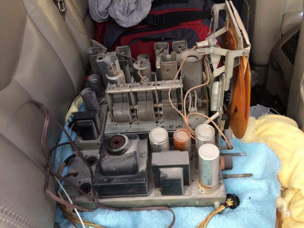

Alrighty!!! She's in the employee's SUV!!! I talked briefly with the seller and he said the radio was electronically restored by a professional in Orange County years ago. The cabinet is apparently all original (I noticed that the back was missing, however). Here's a quick pick of the chassis sans rectifier and output tubes which he took off:
Are the tuning capacitor fins closed, or all the way open? If open, I'll have him turn the dial the other way...

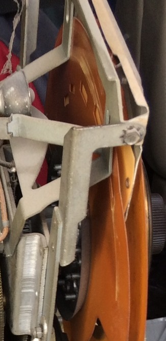

Here's a closeup of the back of the dial:
I'm assuming what appear to be scratch marks is from minor warping of the plastic through the years, and it is brushing up against the frame. Something to be concerned about or try to fix before I put it back in the cabinet in a few weeks?

show thee ,,under side,,,soo,we can tell you if caps,,resistors have been changed
samsdad Wrote:Are the tuning capacitor fins closed, or all the way open? If open, I'll have him turn the dial the other way...
That tuning condenser is turned in the exact opposite direction of what I recommended...see those fins? It's all the way open right now. The fins are at risk of damage. Have him turn it the other way...all of the way in the opposite direction.

Alright it's turned the other way. Thanks, I thought that looked wrong. Any thoughts on he scratching of the back of that dial?
I'll try to get him t get a pic or two of th underside tomorrow. Thanks again.
The brackets, etc. surrounding the dial and the shadow mask (which is the plastic piece that is scratched) may be bent out of shape, causing the scratching/misalignment. Someone who knows what they are doing (no offense intended) needs to look at that before the shadow mask ends up broken from the rubbing.
