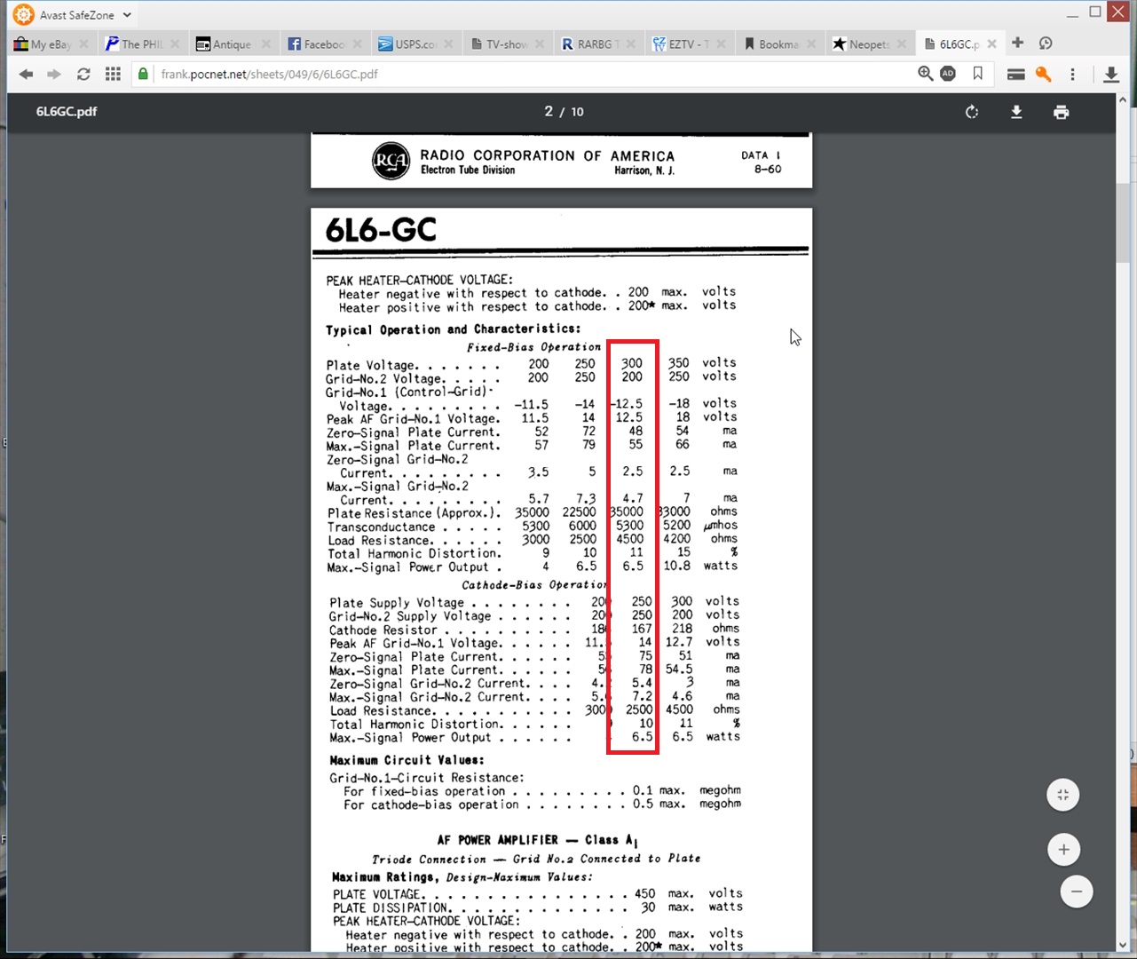

Using the following specs for my output tubes, it says I SHOULD get about 6.5W out with the voltages in this amp, which match the highlighted section almost perfectly.
I'm confused. :/

Brenda, its going to be real difficult to get the 6L6 to clip symmetrically. Typically, a single ended amp has a lot of second harmonic distortion because of the nonlinearity of the tube grid-plate characteristic. The tube gain is highest at high plate current and lowest in the region of cutoff, which is what you are seeing. So the amp always clips on the cutoff side first.
If you look at the distortion vs. power output graph of the link below, you can see the single ended distortion at 6.5 W output is about 10% and almost entirely second harmonic. This is the non-symmetrical clipping that you are seeing. The 6L6 is not really great as a single ended amp.
https://frank.pocnet.net/sheets/127/6/6L6G.pdf
That's precisely the reason the 6L6 is normally used in push-pull. In the P-P configuration, the second harmonic is cancelled out and the load can be optimized for minimum third harmonic, which becomes the major distortion component. Looking at the data, the THD at full output drops from 10% single ended to 2% in push-pull.
You may be able to get the amp to clip more symmetrically by playing with the bias and/or screen voltage. I just noticed that you mentioned that your screen voltage is higher than normal. This may contribute to the clipping if the grid bias is not adjusted accordingly. With higher screen voltage you may need more negative bias on the control grid to center the bias point in the middle of the tube input-output characteristic, making the output clipping more symmetrical.

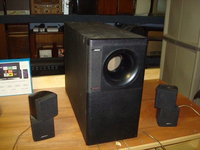

Ok here it is! Icon_razz  I have been playing around with this amp and doing some experiments. I bought a set of Bose Acoustimass 5 speakers and set it up on my shelf over my bench.
I chose this system for several reasons. I didn't have room (or room in my wallet) for a nice set of Bozak speakers. Maybe someday... I know these are really home theater speakers, but I have heard them play and thought they sounded pretty good. I found these for less than $100. The satellite speakers sit on my shelf nicely and take up little space, and the (passive) subwoofer fits perfect under my bench, again taking up very little space. I don't know for sure, but I am guessing it uses a dual voice coil sub (I guess it could have 2 drivers). It worked so I didn't mess with it. But, someday, curiosity may overcome me and I will get out the screwdriver Icon_wink
Ok, so how does it sound? Well, in a nutshell, GREAT! I have it connected to a cd/FM Walkman type player with no EQ or tone control of any kind. I really don't need it with this great little setup. How loud? Well, as I mentioned earlier, this little amp rocks! No, it doesn't bass things off the shelves, but it does thump! Way better than I would ever have expected. Clean? Yep, I don't detect any distortion at any volume level. No, I haven't cranked it to that point either and don't plan to. But, it is loud. I don't detect any hum either, even when I put my ear up to the speakers. I also noticed these Bose speakers don't seem to pull on the amp. It doesn't struggle a bit.

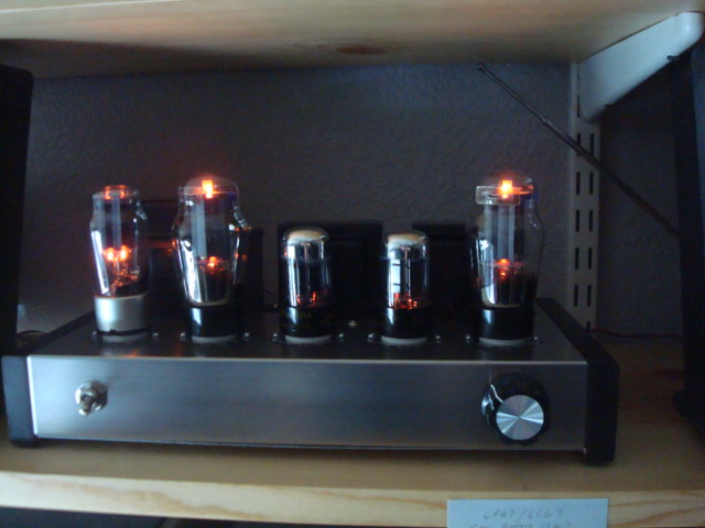

I may eventually get a real preamp, like a PAT4 Dyna or something small and affordable to have tone controls and inputs for testing tuners and such on the bench. I wanted to run it for awhile before doing a write up on it. I do have an audio generator now that I may connect along with a scope and run the ranges to see how linear this amp really is. I am rather curious.
I did axe the original China made 6SN7GT tubes for noise reasons. One simply liked to hum, and the other liked to make funny noises. I settled on a set of older Sylvania tubes that I think sound great. Quiet and clean.
Here are my sentiments so far on this amp project: The good...
1. It is a nice kit, and with a good set of instructions, very easy to build and enjoyable
2. It sounds good and clean
3. Hard to beat for the price
4. Decent output tubes come with kit
5. Comes well packed
6. Simple design, no PC boards
Ok, now the bad...
1. Factory documentation is non existent.
2. Chinese preamp tubes poor quality. You'll want to put in some NOS 6SN7GTs.
3. I don't like how they assemble in pictures (which is why I redesigned it)
4. Lousy speaker binding posts. Get a good set before you even try to install.
Tim
