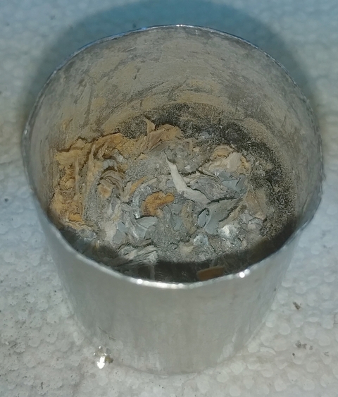

I found that it worked pretty well to try to get a bit of a track cut in all the way around, then focus on one area by rolling the can back and forth on the bench (I had it on an old carpet square on top of the bench) with mild pressure on the knife. I think this rolling action resulted in cutting about 20% of the circumference. Once the blade gets through the can in that area roll it so that you can cut into the next adjacent section. I found that once I got through in one spot the rest went pretty easy. Here's what the larger dual cap looked like when I got it open
And here's what the smaller single cap looked like
As you can see, the smaller one came out of the can fairly easily, but it did leave some black tar like substance in the end of the can.
But the larger one was stuck...tight. I couldn't make much headway trying to dig it out with a knife or screwdriver, and didn't want to risk marring or damaging the can. So I started drilling:

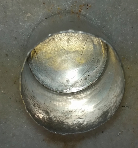

Yesterday I finished restuffing the electrolytics. Here's the Dremel bit I found to dig the 'trench' in the base for the top to fit into.
And here is a picture of base for the dual cap after digging the trench. I also had to shave off some of the aluminum lip where the cut was made in order for the top to fit into place.
Then I drilled holes in the base for the leads and pushed the positive leads through. I make my own circuit boards for small projects so I have a selection of small drill bits and selected one that gives a nice snug fit.
After I spliced the negative leads into one lead and pushed it though the base, I soldered it to one of the tabs on the base of the can.
Then it dawned on me that I'll need to remove the ground lead until I've inserted the can into the chassis. I then applied a few dabs of epoxy in the trench and glued the tops back onto the bases for each of the two cans. I used the epoxy I use when I glue golf clubs heads onto the shafts when I build golf clubs. For some reason I didn't take any 'after' pictures, but I can tell you I didn't do as nice a job on the smaller, single can as I did on the larger one. Around the base where to top and base are glued you can see several small gaps. But for a first effort I'm happy with it. Other than reinserting the cans into the chassis mounting slots this job is complete!
