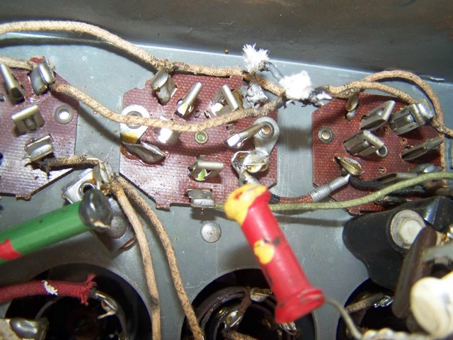

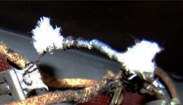

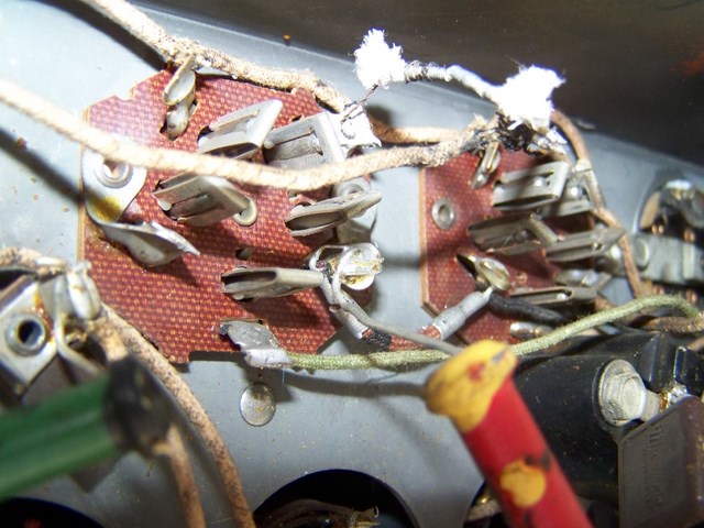

really , indeed , no , not to plug a hole . but as a lamp replacement
I checked under the chassis .
in fact the 56 has been set there, I suppose ,  as replacement of the right lamp , but, we can say ,  correctly .
You can see on the followig photo, one of  the  6.3 V ring wire is not directly connected to the lamp socket , but via a small wired resistor on a steatite rod, so  placed there to absorb the 3.8 exceeded voltage .
you can see this resistor  beetwen the  two white " tassels " on the photos )
It appeared that tis resistor is cut , not burned it seems , but just brocken .
If the radio was used innthat configuration , the limited consumption of this fitting limited the current of the 56 heating at normal valu , so 1 Amp , so only 700 mA more could be with the rignt lamp ,  instead of 2.5amp if the 56 were connected directly to the 6.3 Volt , so possibly not enough to overload the 6.3 V transformer output .
Perhaps also the 56 were under heated , using a resistor of more value il the calculation was made to maintain a 0.3 Amp consumption
#41
Yeah, I was about to ask if there is some dropping resistor, but then I did not see it there, (given the size and the resolution of the photograph, though there was something there...whitish), plus it would need to dissipate quite a bit of heat (3.8W, that would require a 10W-capable resistor there, which is quite large) so I did not think they would do that.
They probably did not have a 37 so this is how they worked around the problem.
The sch shows 37, so I would restore the circuit to the original and buy the 37 tube.
