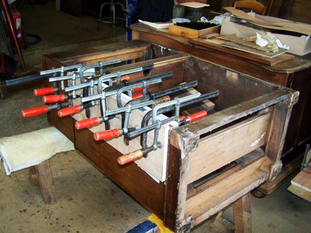

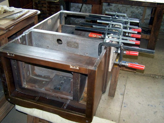

hello Sirs
Last saturday I continued to restick the veneer on the left bottom side of the console.  It takes a lot of time , as it' s not possible to work on both sides at a time , due to lack of clamps !
Next step on the other side , next wednesday !

hello Morzh
The word " pince " in french is used for smaller objects  , like those used to hang linen outside on a cord to dry
For my use , the right word is " serre joint  " , that is ti say to " squeeze seam "
a " pince " is only to attach , a " serre joint "is used to " squeeze very hardly " to pieces
In that application , after gluing the veneer , or the support , you have to squeeze very hardly the two surfaces to throw away the excedent of glue or air bubbles, and everywhere , and also to get the veneer very flat on the support , driving the tolls the manner and order you drive the screws when you change the gasket of the motor of a car

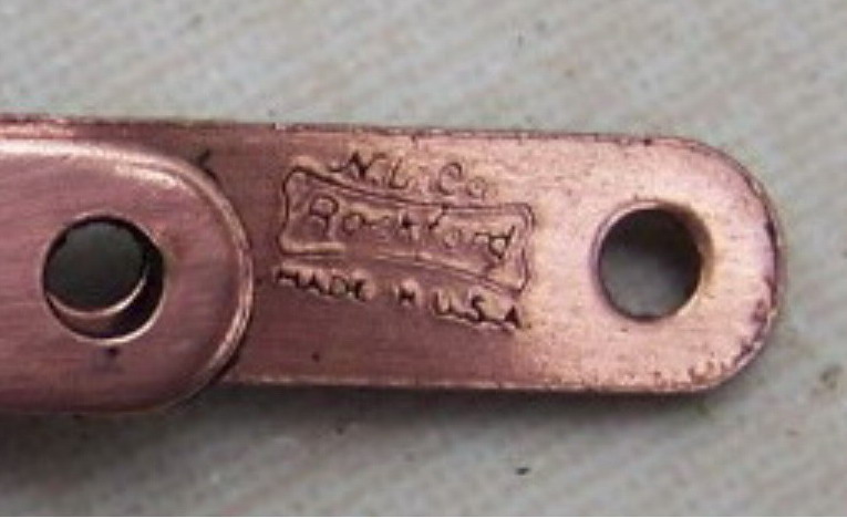

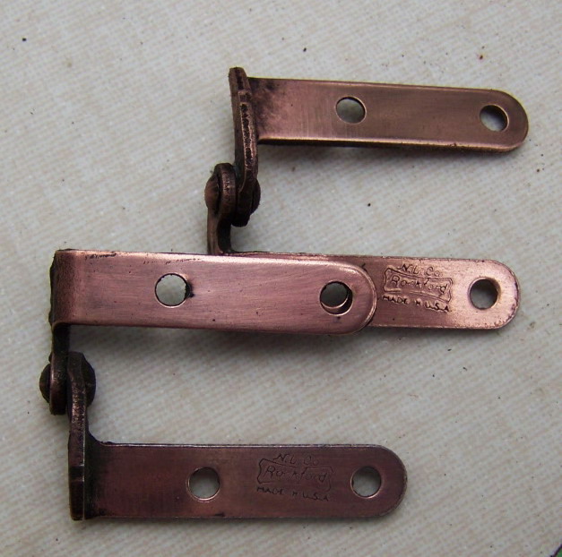

I was this afternoon cleaning the four small  hinges of the little doors to of the console  I can notice  inlaid incscriptions  io them
#56
N. L. Co, Rockford.
I don't know if this is the same company, but there is that Rockford Process in IL, USA, who still make hinges Icon_smile
http://rockfordprocess.com/hardware/
And they are in...surprise, surprise - in Rockford, IL.

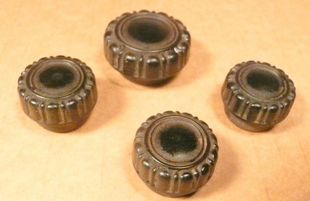

Dear friends
Before asking you a question , I would like to send you my best wishes from France for this new year ! Icon_biggrin
My question is following
I was still remaining searching for the missing knobs for my console 23X I am restoring and could perhaps I have found ones
Do you think the following knobs are really the genuine original ones , or at least Philco ones suitable for the radio of my console ?
Thanks a lot for your kind reply   Icon_e_wink
