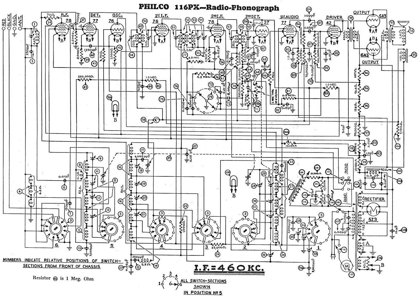

1. I found a film cap not in the parts list: 30-4334-S. I can't find it in the Philco Parts value listings. Anyone know what value it could be?
2. A multi electrolytic can has 4 caps: 1, 3, 2, 1ufd. I have 2.2ufd, and a 4.7ufd. Can I use the 2.2 in place of the 1's, and the 4.7 in place of the 3 without going too out of spec?
3. Looking over the schematic, I can find all but 1 of the electrolytics. I can't seem to find the 3uf from the 4-section can (C83). Is it possible it wasn't used?

I believe it is probably the unlabeled 3uF cap circled here:
(schematic from Ron's annotated schematics in the Tech Section, with the circles added)
[Image: https://www.dropbox.com/s/0bnycedv0xr41i....jpg?raw=1]

(07-15-2017, 10:44 AM)klondike98 Wrote: I believe it is probably the unlabeled 3uF cap circled here:
THERE it is! Thank you! Sometimes another set of eyes helps. Thanks!
