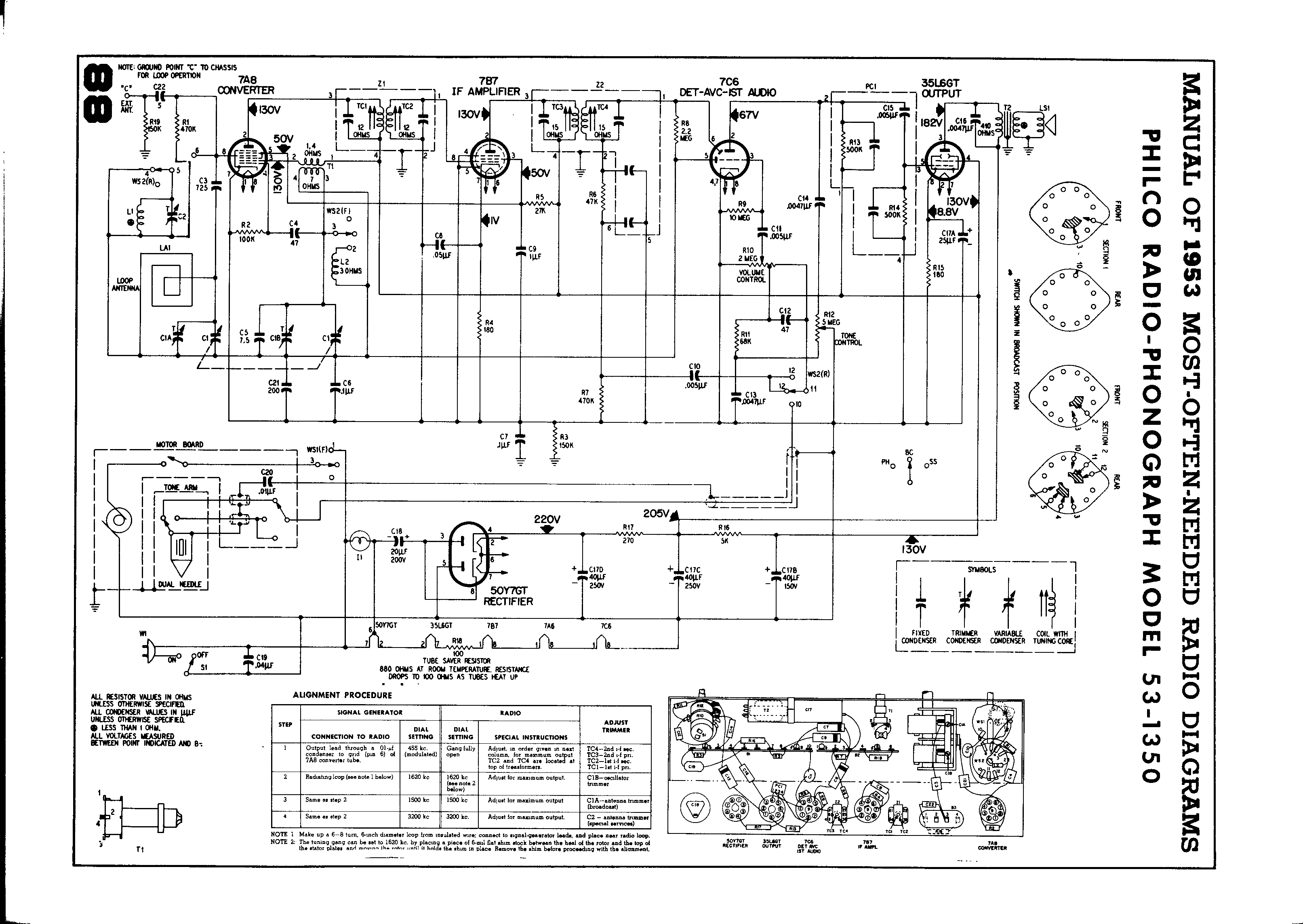

Now - do you have the schematic for the radio?
Second question - and I am not trying to be condescending in any way, merely asking to find out - are you well versed in reading schematics and troubleshooting techniques?
You need to find out what is causing that resistor to overheat. Something is likely shorted causing that resistor to draw way too much current. Without a schematic (and Nostalgia Air doesn't have the 53-1350 schematic), I would say it is not likely a power transformer causing a resistor to overheat.
http://www.rsp-italy.it/Electronics/Radi...n/1953.pdf
Pg 88.
AC set series heaters voltage doubler p/s.
> I would say it is not likely a power transformer causing a resistor to overheat. <
I would concur as there is no power transformer.
If you haven't already replace C-17 and 18.
What resistor are we talking about?
Where exactly is the transformer in this radio?
And, what Ron said. (About sch reading).

Yes, we ordered/received the schematics.  I failed as my dad's son, when it comes to electronics!  He BEGAN the only radio/tv repair/sales business in our hometown in the mid-40's.   He bought all the Radio-shack testing equipment kits, and made his own.  He hand BUILT the first tv in our community.    I spent countless hours helping him, and didn't learn a darn thing!   Very frustrating!  Our son is repairing this radio, and he understands the electronics.    We'll check in to the parts:   C17 and C18, as we haven't changed these (or any other parts, besides the one resistor.).

[attachment=14455]
Beitmans has a nice clean copy David
[attachment=14456

If it was my radio would replace all paper caps and out of spec resistors. David
> We'll test C-17 and 18, and see what we find.
Would bother just replace. I'd be willing to wager that C-17C is shorted and that's what burning up your 270 ohm resistor. It's common practice to replace the electrolytic caps (C-17 and 18) when servicing. Nowadays the 40uf and 20uf caps aren't standard values anymore now their 47 and 22uf. The 150v caps are now 160v. For the five caps your looking at abt $5+shipping.
There also are wax/paper style caps that should be replaced. Over time the internal paper insulation breaks down and causes them to become leaky, electrically leaky. Again nowadays standard voltage rating is 630v, in your set you will probably find ones that are 200v, 400v, and 600v. Instead of paper new ones use mylar film which is much better insulator.
With capacitors you can always go up in voltage rating never down and with resistor you can always go up in wattage rating but not down.
http://www.tuberadios.com/capacitors/   Has caps and such @ competitive prices.
GL
(10-09-2017, 08:53 PM)David Wrote:  If it was my radio would replace all paper caps and out of spec resistors. David
Ditto. All caps, not just paper, except mica if present. Then you won't have to think about why things smoke.
