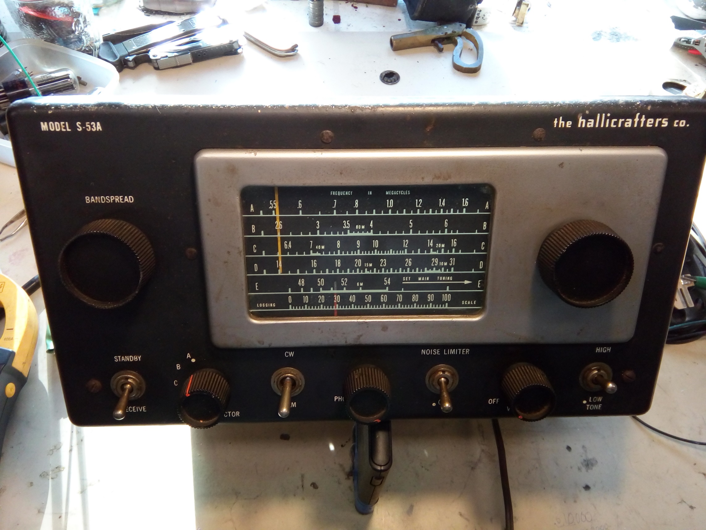

Hallicrafters S53-A
Got this free a week ago.
Will be a christmas gift to my youngest boy but.........
owner said he messed up the speaker wires,, i fixed that and went over it some.  Its all original except tubes.
this is an 8 tube radio by the way. it looked so nice and nothing to worry about under the hood i opt'd not to recap or anything. it looks like its been mostly just stored and such, with some minor exterior scratches and such.

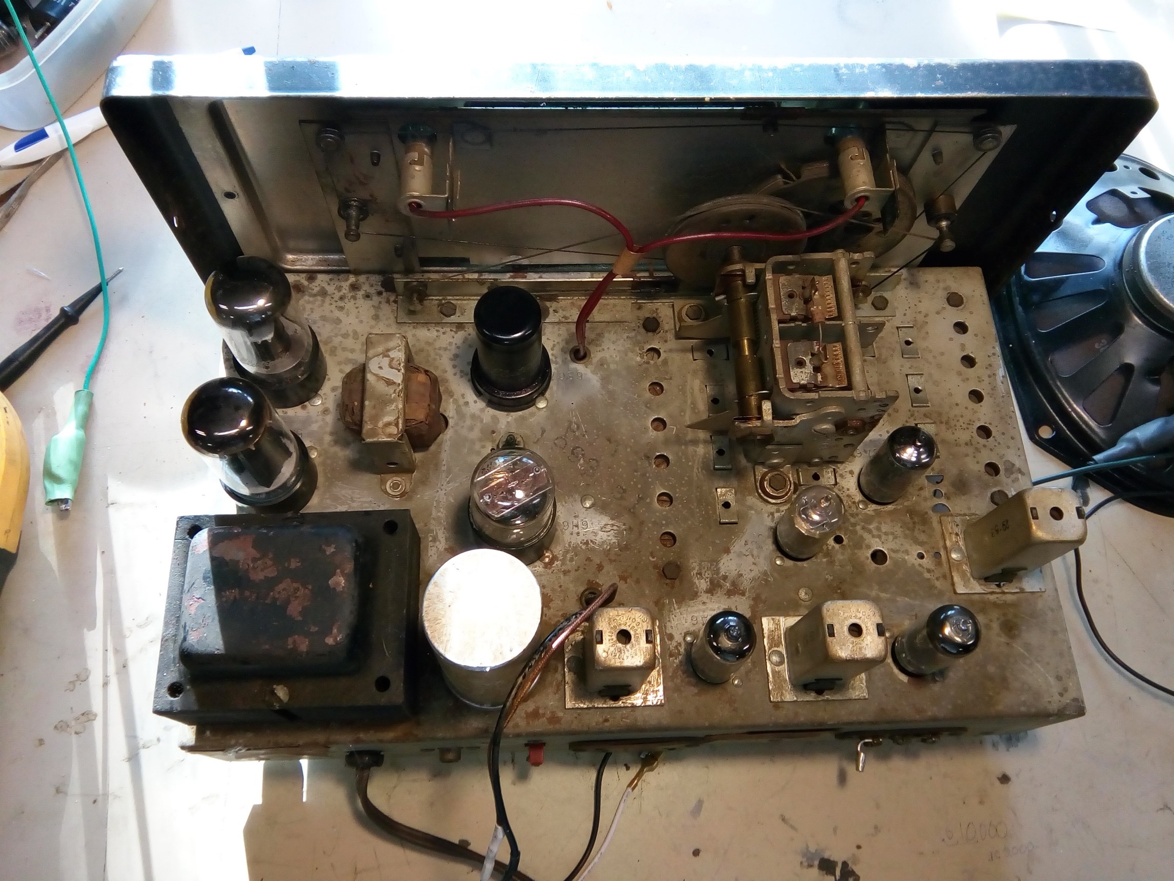

powered up and it worked fine.  Since i disagreed with the design, I took the set out of the cabinet and did a mod.  I  cut the bottom open and made a non-conductive plexi-gllass cover to go on to make it easier for future repairs plus its really neat to see all the parts.
I did notice during my power up over a few days that the radio acted like there was an intermittant connection but it seemded to go away on its own.  the speaker would sorta cut out or pop.
I installed the radio chassis into the cabinet and powered up tonight.  The left 75% of am band was absent but slowely all AM band was absent,, all gone with some slight noise from the speaker.

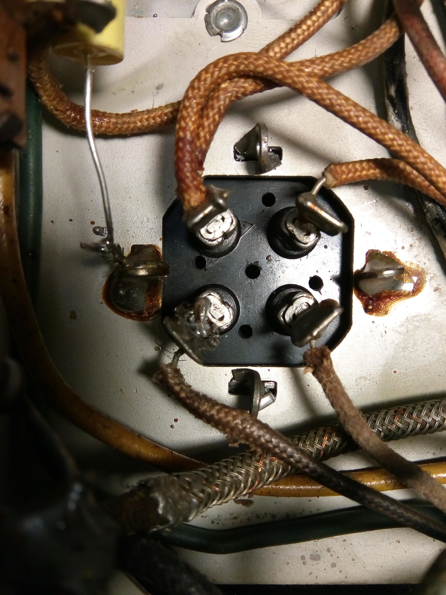

there is a 1000 ohm reisistor across the filter cap that gets hot enough to let off a certain smell we all know.
do you all think the filter caps are drawing down my speaker volume and such?

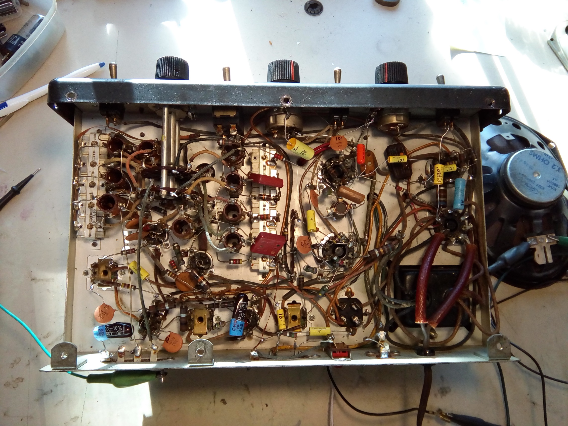

a few pics of this radio
this is after i redid all the caps, excluding the filter section.

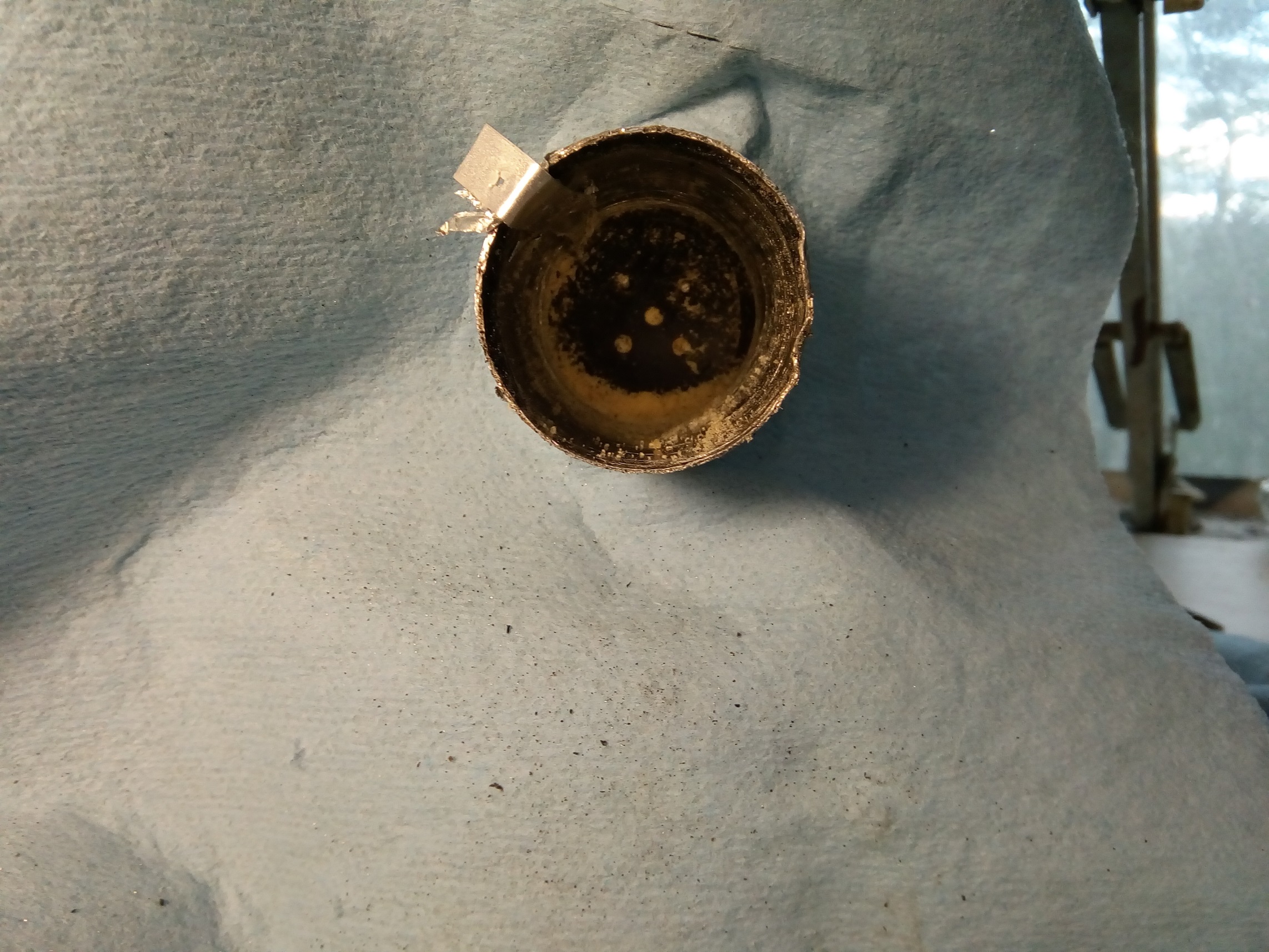

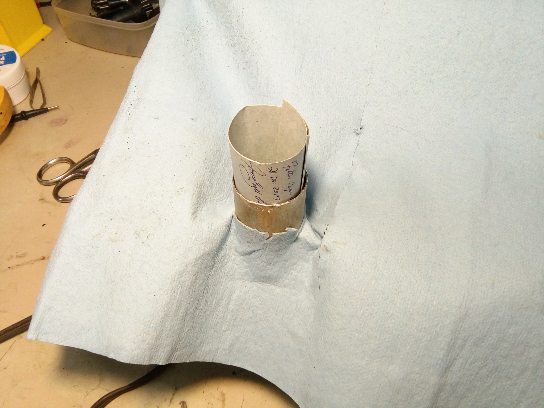

prep'ing the filter cap replacement the Radioroslyn way!
clean the muck out, drill some holes for the new leads,  then add some fish paper insulation with a note to my son he will find one day in the future,

the 1k ohm resistor across my 6k6 is still getting hot and can not power on for more than 20 seconds.
yeah,,, im pretty much lost. just knocked off the the day, hope to have this working for christmas.
i see a bunch of dog bone resistors.. since im shot gunning things.. do those generally go bad?
Go over to C37c (last 10mf filter) and disconnect wires from the terminal except for the 1K resistor. Check the voltage at C37c w/those other wires disconnected. Should see abt 200vdc there. If so then connect the disconnected wires one by one measuring the voltage each time you reconnect one to see which wire causes the voltage drop. This will sort which section needs going over, the osc, the 6SC7 audio stage, or the mixer screen grid circuit.
