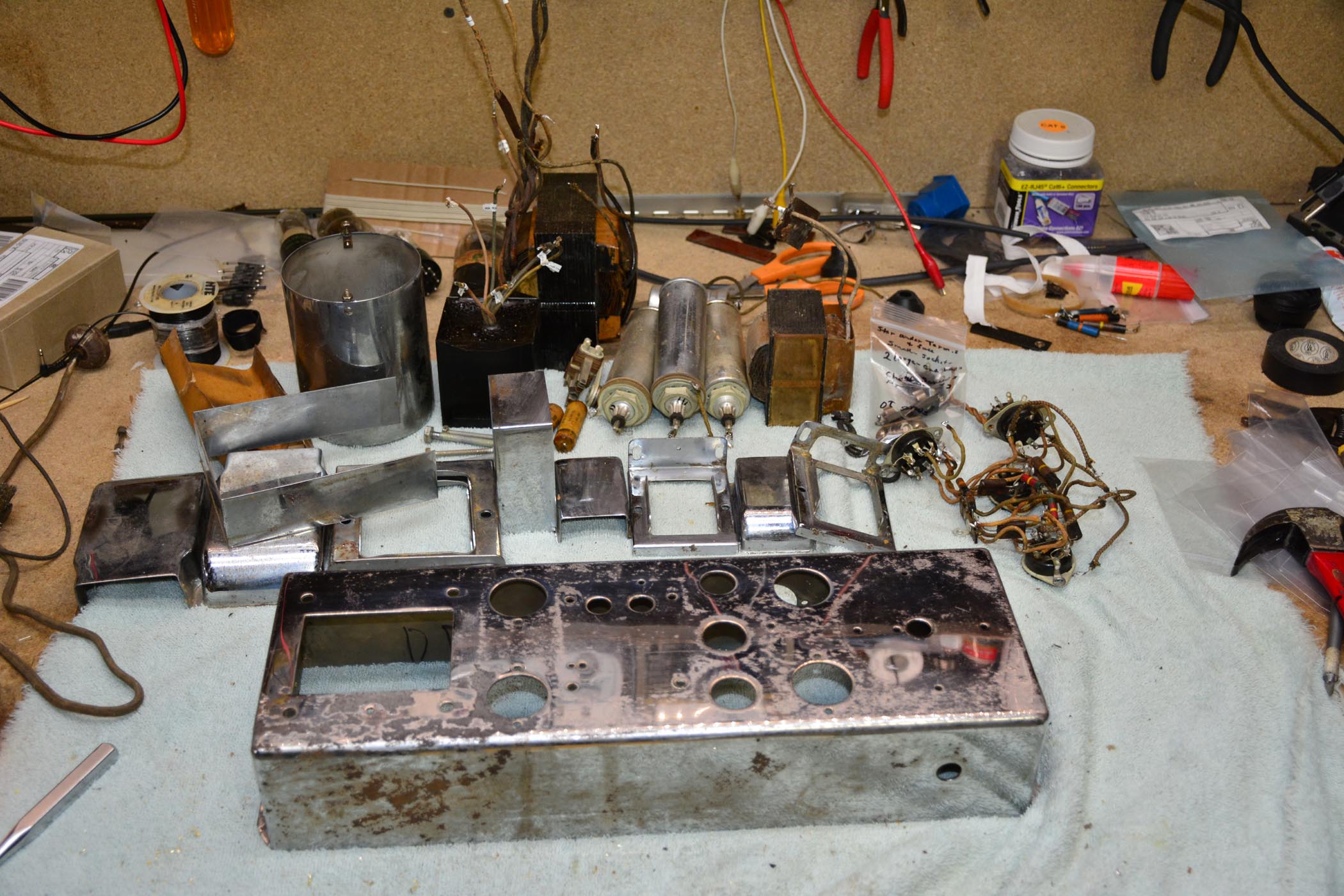

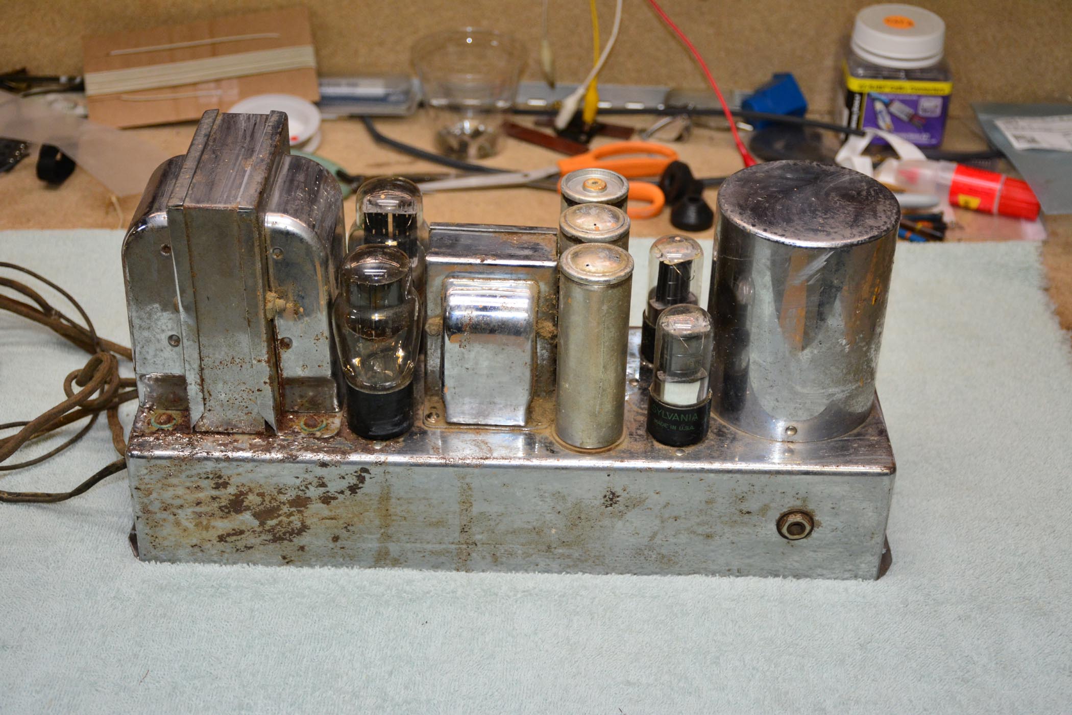

Yikes! What have I gotten myself into?!  I decided to start on my E.H. Scott 16.  The Amp/Power supply was the least intimidating so I started there.  Now to check out re-chroming businesses in the Grand Rapids, MI area.

I'll check them out.  One of the problems with the Scott re-chrome process is that the shields are aluminum and require special handling in the chrome stripping process.  People have had the shields destroyed by plating companies who did not know what they were doing with these thin aluminum cans.

I got my 16 ps/amp back from the re-chrome shop.  I did not have the cylindrical can redone as it is aluminum and I've heard too many horror stories of them being destroyed in the stripping process.  All  electrolytic caps and tubular caps were re-stuffed.  I'm saving the old resistors and the 2 mica look-a-likes to make molds of and molding new resistors and mica's to look original.  Couldn't tell the color of the wires so I used Radio Daze's suggested color code.
Once again - Yikes! What did I get myself into?
My intention is to strip the chassis and have it re-chromed.  A lot of rivets, as Russ pointed out.  A little intimidating to say the least.  I hope all of my pictures during "deconstruction" will help in the reconstruction.  Lots of places to make wiring errors in that process.
