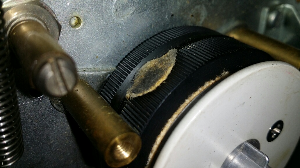

Really the only remaining issue is a clunk clunk in the take-up real. Which I am sure is a belt/ roller that has taken on a flat spot in storage. It does not noticeably affect playback audio.
Well, that is fixed too. Turns out a felt had slipped out of position.
ATP (all tests passed) and ready to go.
