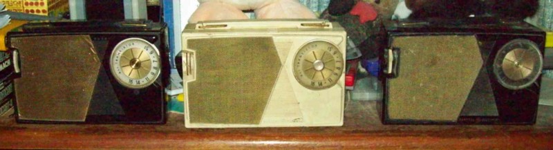

I think we have all seen this particular series of GE transistor radio over the years. I used to run into them all the time at resale shops, but had always heard that they used an odd-ball 4.5 volt battery, so avoided buying them. Now, after the past few days, I have three of them!
Left to right they are: Model P-807A in good shape, no cracks. The white one has no model tag, but seems to be a bit later than the first one due to smaller IFs and using the reed speaker. It HAD a prefect cabinet until I dropped it! My dad has gotten a bad habit of popping up out of nowhere and actually spooked me when I got home with the white radio today. Icon_sad  Probably should have carried the radio in separate from the pack of batteries. Now has a tiny crack on a bottom corner. The third radio is a late production P-807J that was found laying in the dirt in the garage at my late friend's place when we were cleaning up. Basically, kicked into a corner and forgotten about as he didn't like transistor radios. Has a crack on the top, light rust on the speaker, and the grill cloth was falling off when I found it.
After swapping over the modern nine volt batteries, all three of these radios still work and not bad for five transitor units. Only complaint I have is that since GE snapped the speakers right into the plastic cabinets, they do get a bit of a cabinet rattle no matter what. I have $20 each in first two, finding them the past few days. The P-807J was a freebie and was forgotten about for three years in a drawer until yesterday. Now, to clean them all up. Even got an old Mallory 9 volt with the white radio. Still has the Radio Shack price sticker on it. If I had known these simply used over-sized 9 volt batteries earlier, I would have had some super cheap ones years ago.

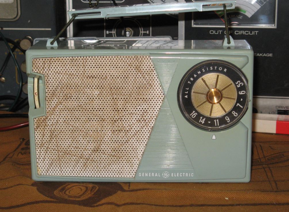

Aqua .. P806A - 1959
White . P808E - 1961
Black .. P807J - 1963
Apparently GE upped the letter suffix with each version update, aqua version deleted early in series run...  Was also a green P809 for a couple years...
Not mine but here's the P806A, one I have is missing center trim on dial scale otherwise VGC... My White 808E doesn't appear to have been used...

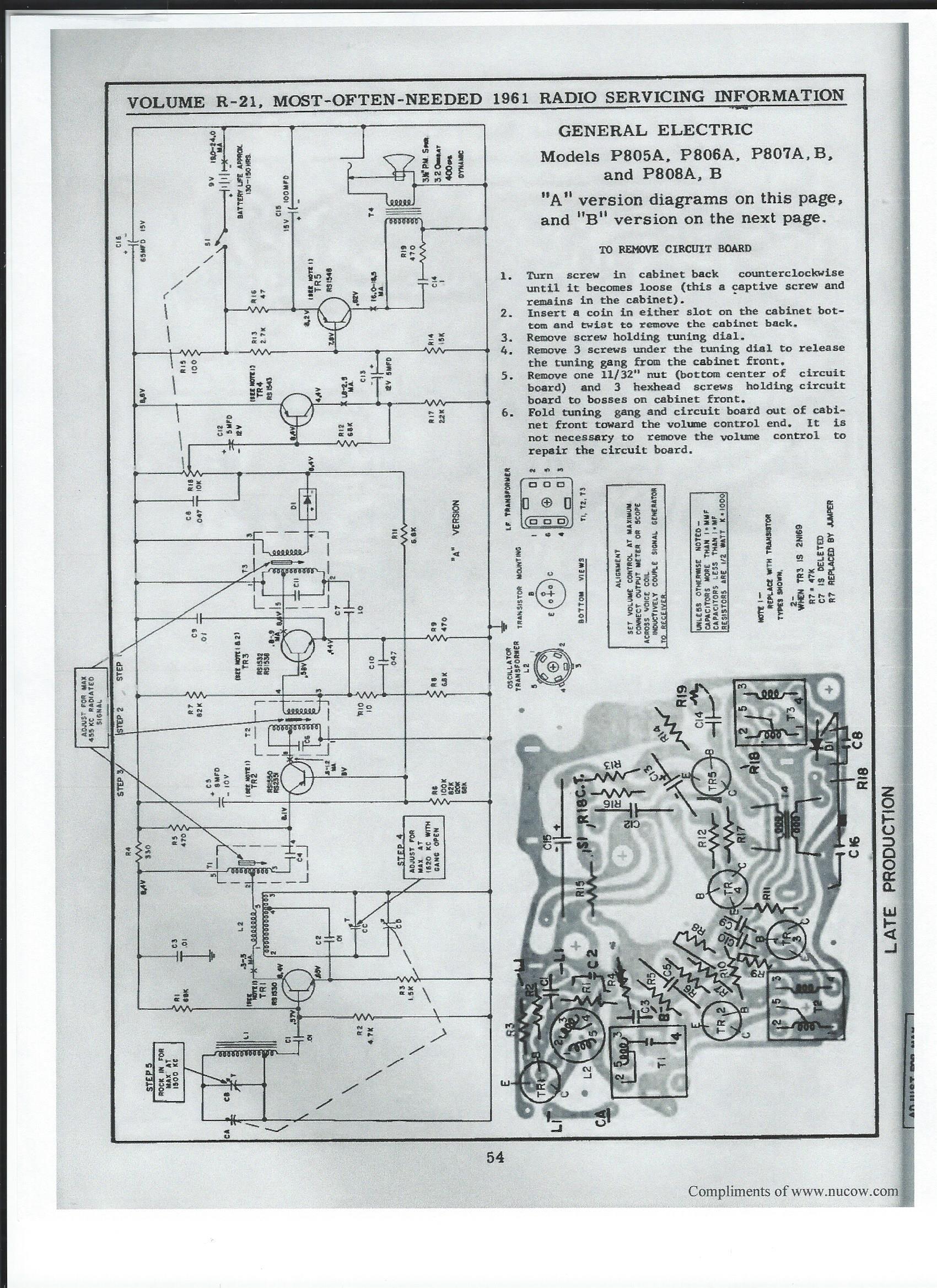

The schematic says current draw is 19-24ma, battery life 130-150 hours, that's for both A & B series... I'd guess a modern alkaline battery should come close to that...
My White P808 draws around 17ma and plays quite well, the other two are only drawing 6-8ma and are sorely lacking performance... None have been recapped and as I won't be playing them, likely never will be...
Here's the schematic for A series, apparently only version to use a conventional speaker, B has a pin speaker...

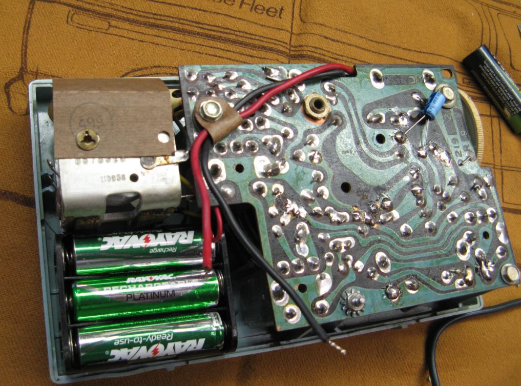

I was looking at my Aqua radio again and noticed screws in chassis were loose, ummm someone's been tromping around in here... Lifted it out and behold, the small coupling electrolytics were new but ones in P/S and audio orig, ummm... So I replaced C16 and walla it sprang to life... Also replaced C15 which made a small improvement... It's still only drawing 13.5ma but is far improved, mebby I'll check the audio output bias resistors...
Not stated on A version but B with pin speaker says current reading taken at minimum volume... Current drops slightly at higher volume on both my A & E versions... The J is still sick...
I dunno if it's available but a battery holder for six AAA batteries would probably fit in the A version... With smaller chassis and mini components, the J has room for the Goodyear blimp inside, a long holder for AA batteries arranged 2X3 would likely fit with ease...
BTW I tried operation on 6v, performance is all but nonexistent...

Fitting a double layered battery box for six AA into the A version is a piece of cake, if were necessary there's enough room to stack three deep... A piece of 1" foam glued into back would prevent box from shifting...
