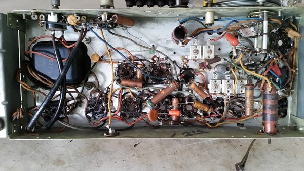

Here's a pic or two of the underside:
And here is the tangle around the bandswitch.
