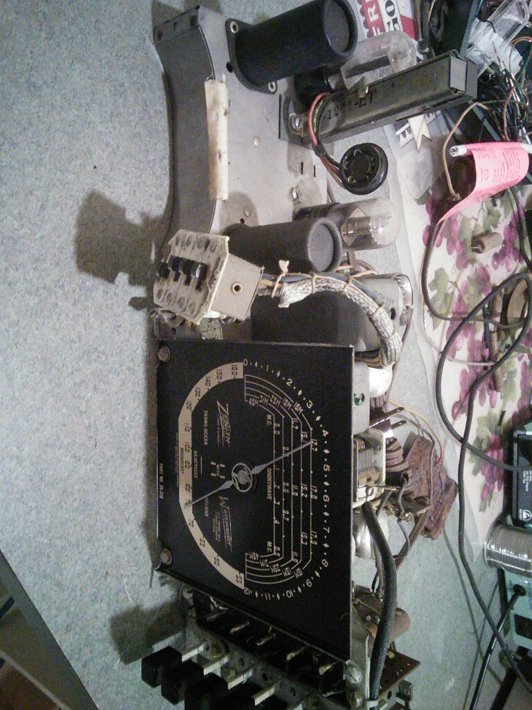

Pulled the chassis out.
Wasn't too difficult.

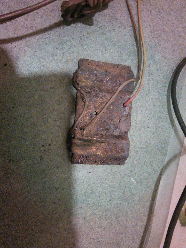

The battery holder rusted out. Not sure I'll need it, as in case I make a battery it is unlikely to use it. Or not?

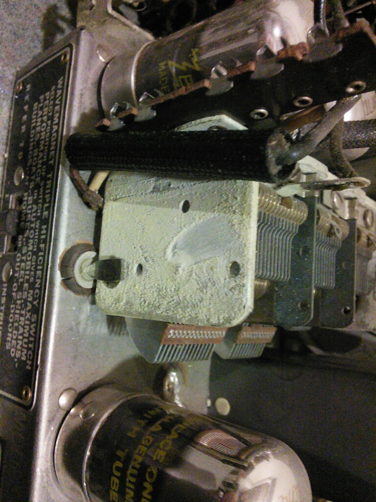

The tuning cap is covered with something that looks like lithium grease.

In terms of health hazards I would be more concerned about that substance on the back of the tuning condenser frame, it may be cadmium sulfide or cadmium oxide, neither one is good to ingest or inhale as it is a heavy metal much like lead. Fortunately you can clean it off using mineral spirits or a metal polish, which will allow you to contain the dust.
Only some asbestos is water soluble, so when it gets inhaled, it is dissolved and creates no problems; it's the other one that is not soluble which will create problems as it stays lodged without being dissolved.
The stuff on the cap.....it seems greasy, not dusty. And it is on one side of the cap. If it is cadmium-based, where did it come from and why is it there?

that thing looks complicated!!
Well, this is the first ever multi-SW-band portable radio. Has to be somewhat complicated.
But in reality it is not that complex, other than the connections to things around the chassis; the chassis itself is no more complex than any comparable tube count radio with more than one band.
Bought the fully assembled battery from Ed (with WWII) logo.
He has it down to an art and I would have to do this...with less spectacular results and for many hours. Considering there are still expenses, not a huge price to pay.
(07-05-2018, 08:03 AM)morzh Wrote: The stuff on the cap.....it seems greasy, not dusty. And it is on one side of the cap. If it is cadmium-based, where did it come from and why is it there?
This is what happens to cadmium plating when it deteriorates over the years. I think it usually occurs as a result of the radio being stored someplace like a barn or basement.
For the sake of your health, put on a respirator and gloves, get some suitable cleaner for metal and get that stuff off your tuning condenser! (And do this outdoors!)

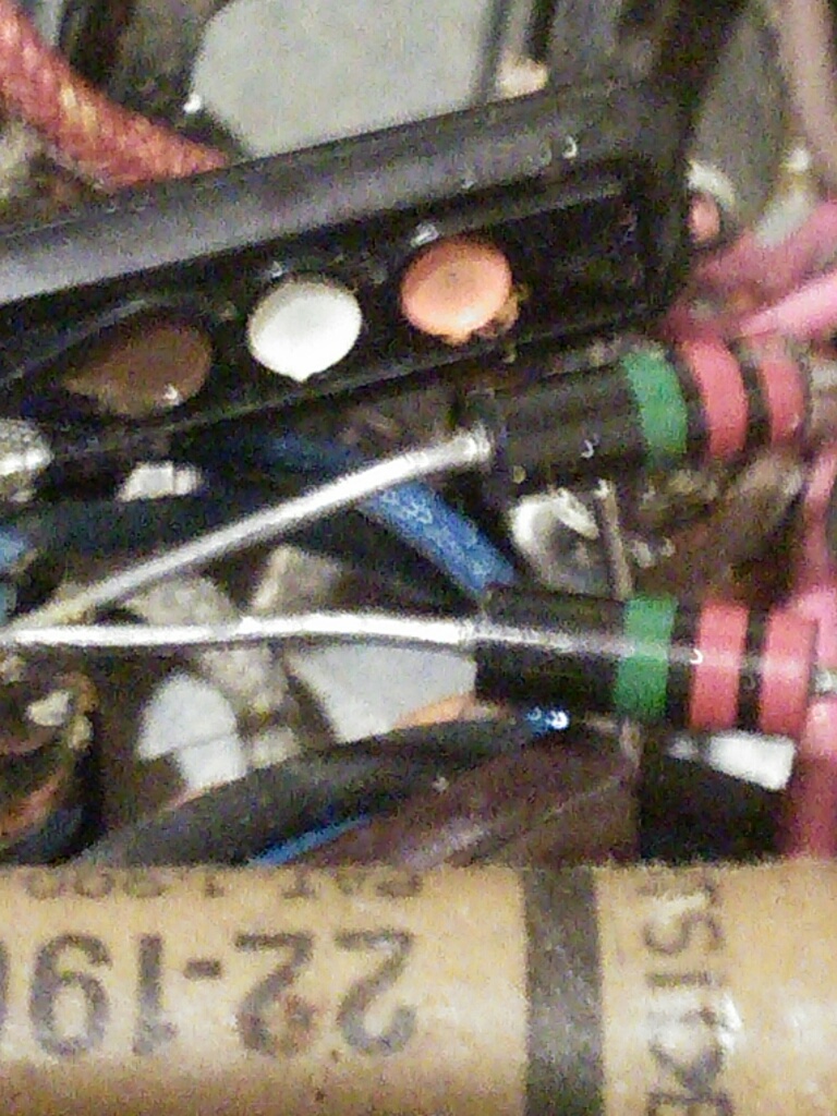

What part is this? A resistor?
The colors are Brn-Yel-Org.
By its length, I would guess it is a resistor. I have seen resistors which looked like that before.
Posts: 2,128
Threads: 18
Joined: Oct 2008
Well, measure it and see if it is a resistor. Can't be sure but looks like 310 ohms if the arrow is the last digit.
There are 330 ohm on the list but I can't place it: there are discrepancies with the schin how it's hooked up.
340 ohm then. But it measures 24 ohm. In circuit. Maybe due to filaments.
