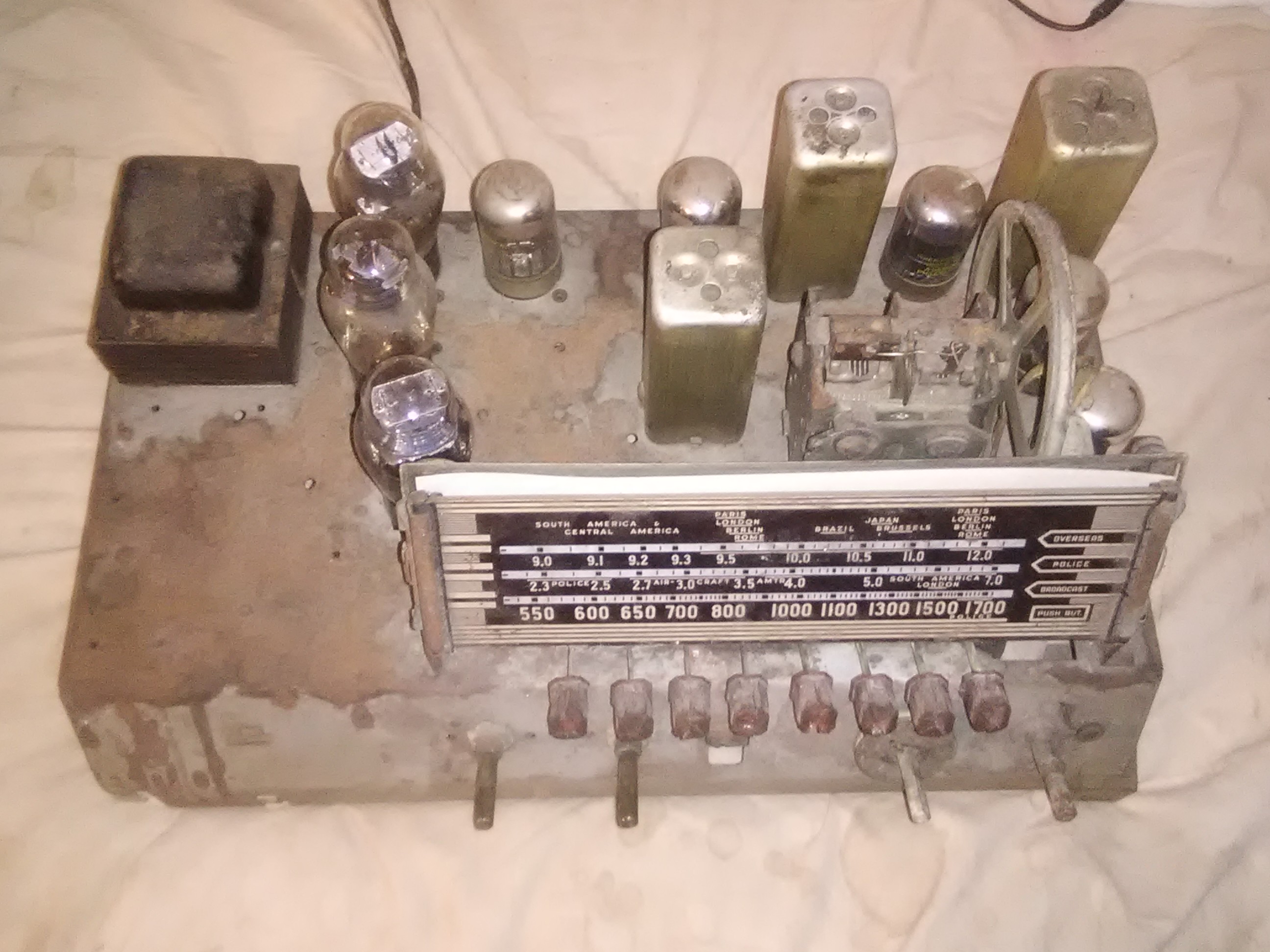

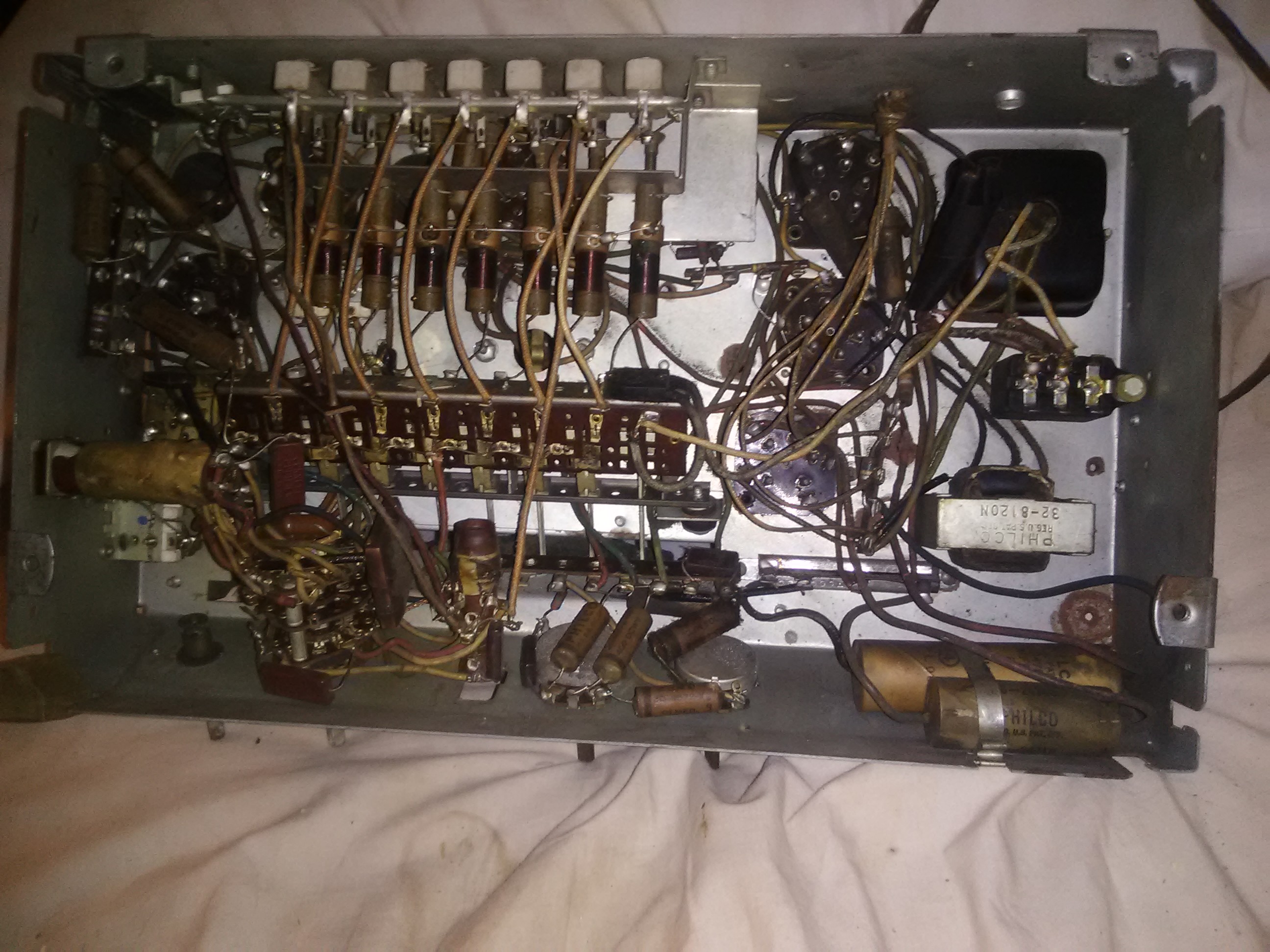

I apologize for the mis-wording I did mean radio. I have acquired the meter and the iron. I have also taken pictures of the chassis and the cabinet. The knobs and push buttons are in horrible condition and the face plate seems unrecognizable,  but it is otherwise complete.

If wires are not cracked, the restoration is pretty simple: change all caps.
If you don't feel like doing what I did, meaning re-stuffing the caps, it could be very quick. Bite out the old, solder in the new. When buying the caps, opt for axial type, this will be easier.
Thank you for your feedback Morzh. I would like to go about it the classier looking way. I will check the wires and get back to you.
Looks like you may have had some rodent action in the past. Hence the rust on the top of the chassis.
The inside is very clean. The outside of this chassis lends itself to easy cleaning once all the tubes have been pulled.
