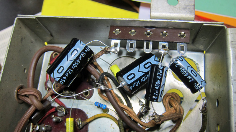

Maybe my forthcoming comments aren't needed; but, it looks like there are 3 capacitors in the can.  #21 is an 8 mfd, #21A is a 16 mfd, and #21B is a 12 mfd.  There should be markings on the side of the can that identify the internal caps.
My preference has been to add the new caps under the chassis (I'm more a refurbisher than a restorer).  I sometimes will add a terminal strip and mount the new capacitors to it (see photo).
