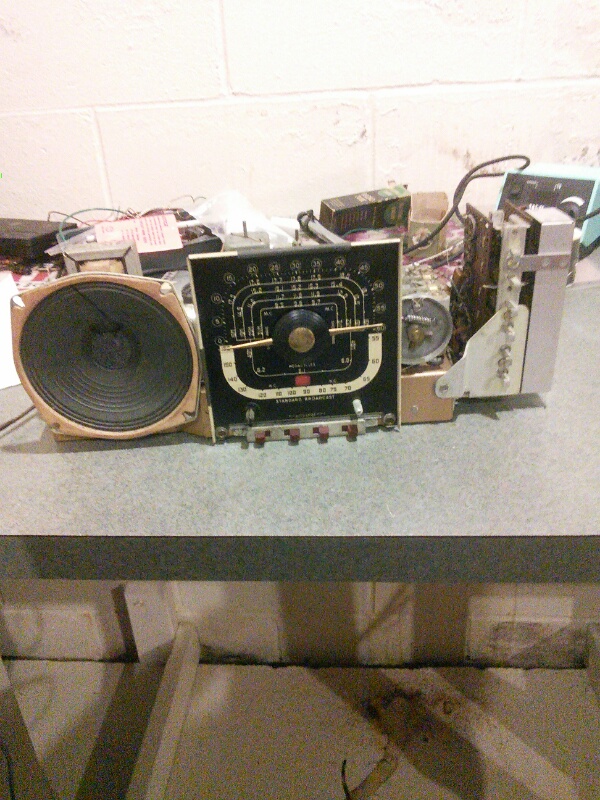

Just put it on the bench and took the chassis out.
Clearly, the battery umbilical will have to be reworked.
