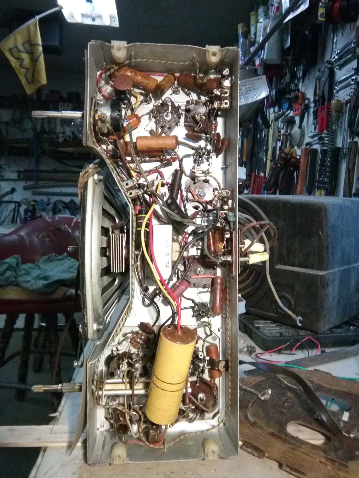

i took it apart to inspect and found out it looked pretty clean underneath... and the caps dont look like your usual blistered bunch of misfits.
I noticed some round disc type mica caps and wondered if those were original or not.  i will use the parts list in the manual to verify this.
i totally dislike the tone control location.. its just plain stupid- it prevents easy access to the speaker.
All the tubes were in place so that seems to be a plus if the fire up!
It appears someone has installed a filter cap over top the original filter cap terminals... this makes no sense!!!
if you have a can that has a 4 section filter cap and it goes bad... why would you replace it with a 2 section dongle aftermarket,,**AND** parallel it (or should i say "series" it with a bad filter cap?

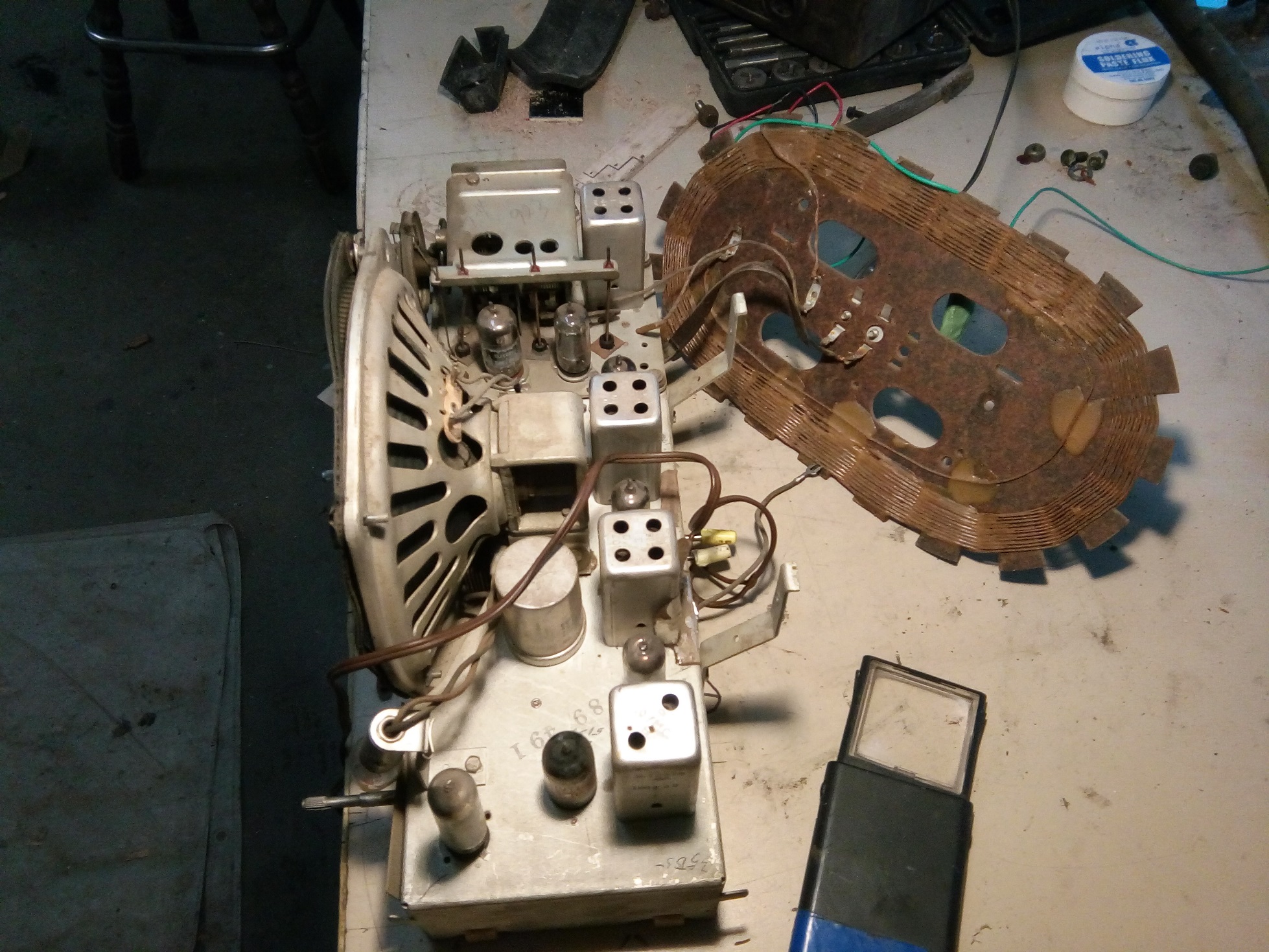

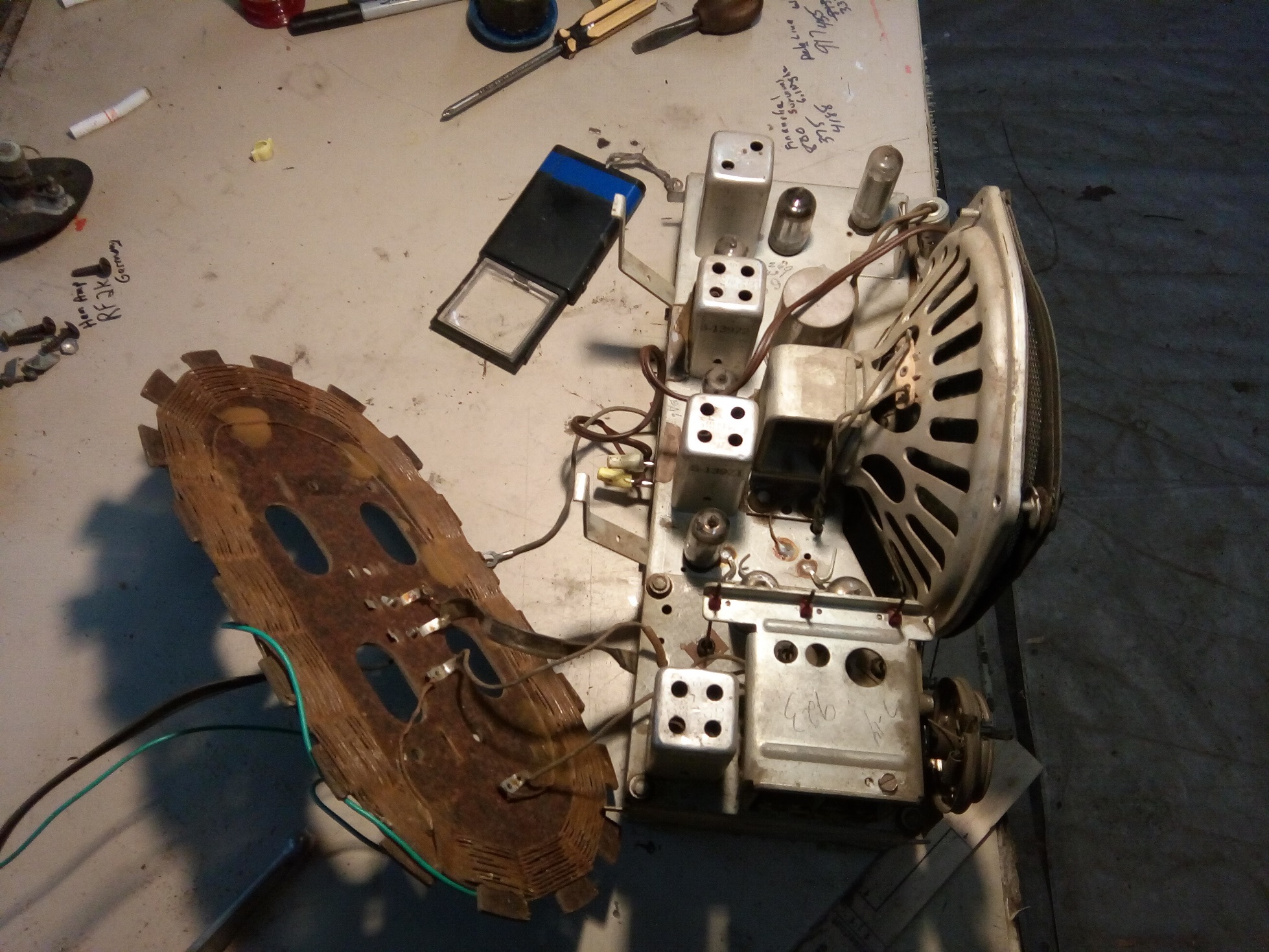

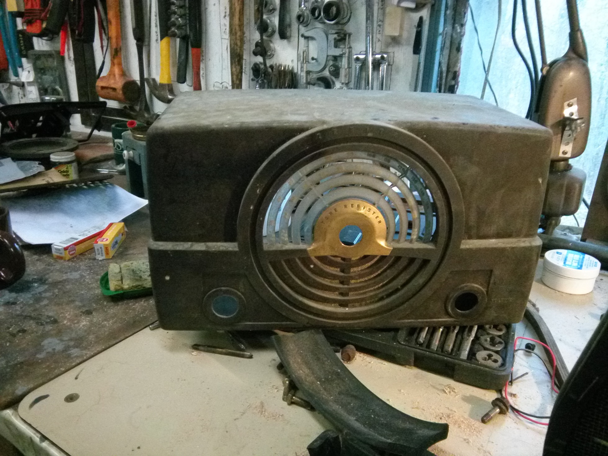

so here are some pics.
apparently this radio was sold in the same town i live in,, and has a service sticker of the former repair shop where i live as well.
a few pics..........
more pics
and another
