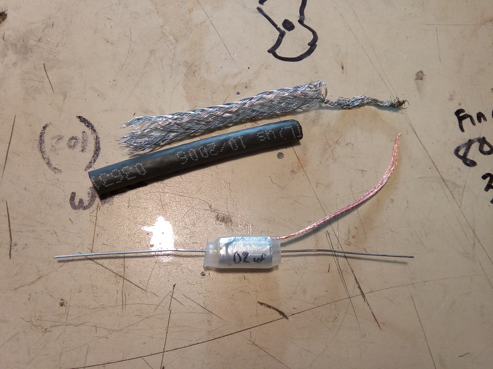

here is my down and dirty rendition of shielding a cap.
automotive aluminum sticky back muffler patch repair tape.
a short section of de-soldering wick.
if this does not work well enough, i will move up to something i pulled from some coax cable i laid out next to the cap shown.
that coax braid is aluminum though so i would need to do a tiny crimp to transition in a copper leg.

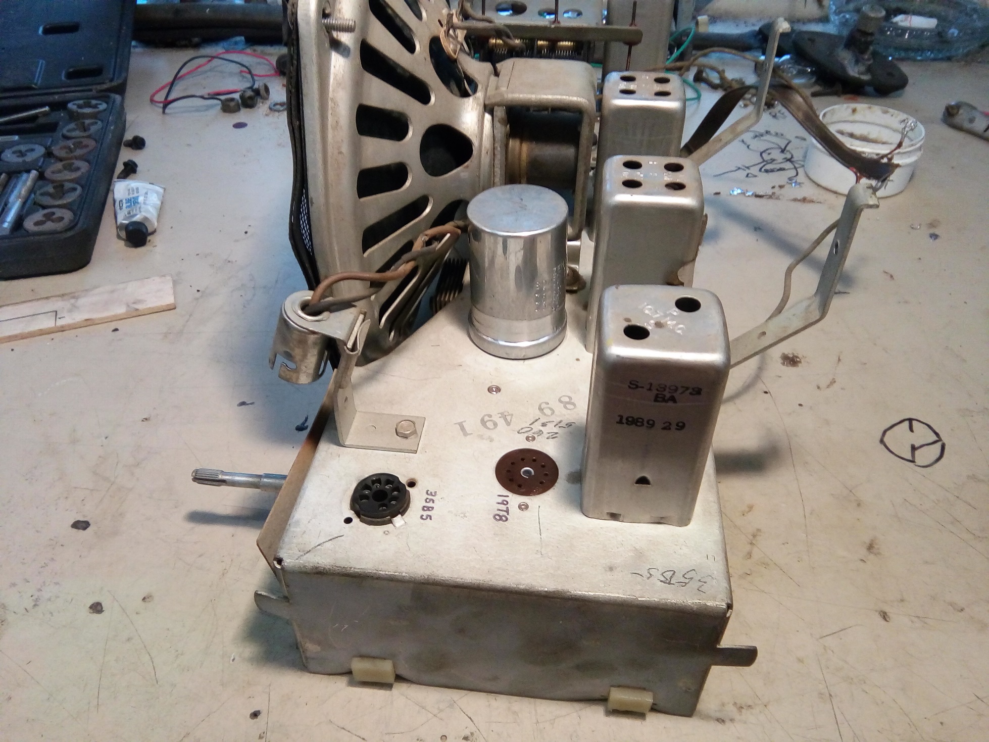

all caps replaced and finally i moved on to demo of the filter cap can.
i removed the dual section 80/40 that was installed by the previous repair and measured it.
the aftermarket dual section cap measured as follows:
the 80uf was reading 3uf
the 40uf was initially reading about 10 then to 11 then 13.2, 14.2.... it was charging up but no where near 40
so not only was the original filter caps diagnosed in the past as bad but this aftermarket one is to.
hopefully this ends up being the source of the gargle noise i hear.

just got the filter cap section re-canned up.
i ended up using all 160v because of size,,,, but the 160v ones i used are all 105degC rated which should help with the possible inrush and our modern utility potentials but...... if it does not, i have it set up so that from now on i can come in from the top and replace with some of those fancy shmancy tall skinny reditions that have higher voltages.
i used 1) 160v 100pf & 3) 160v 47uf caps to fill up that short but wider can.

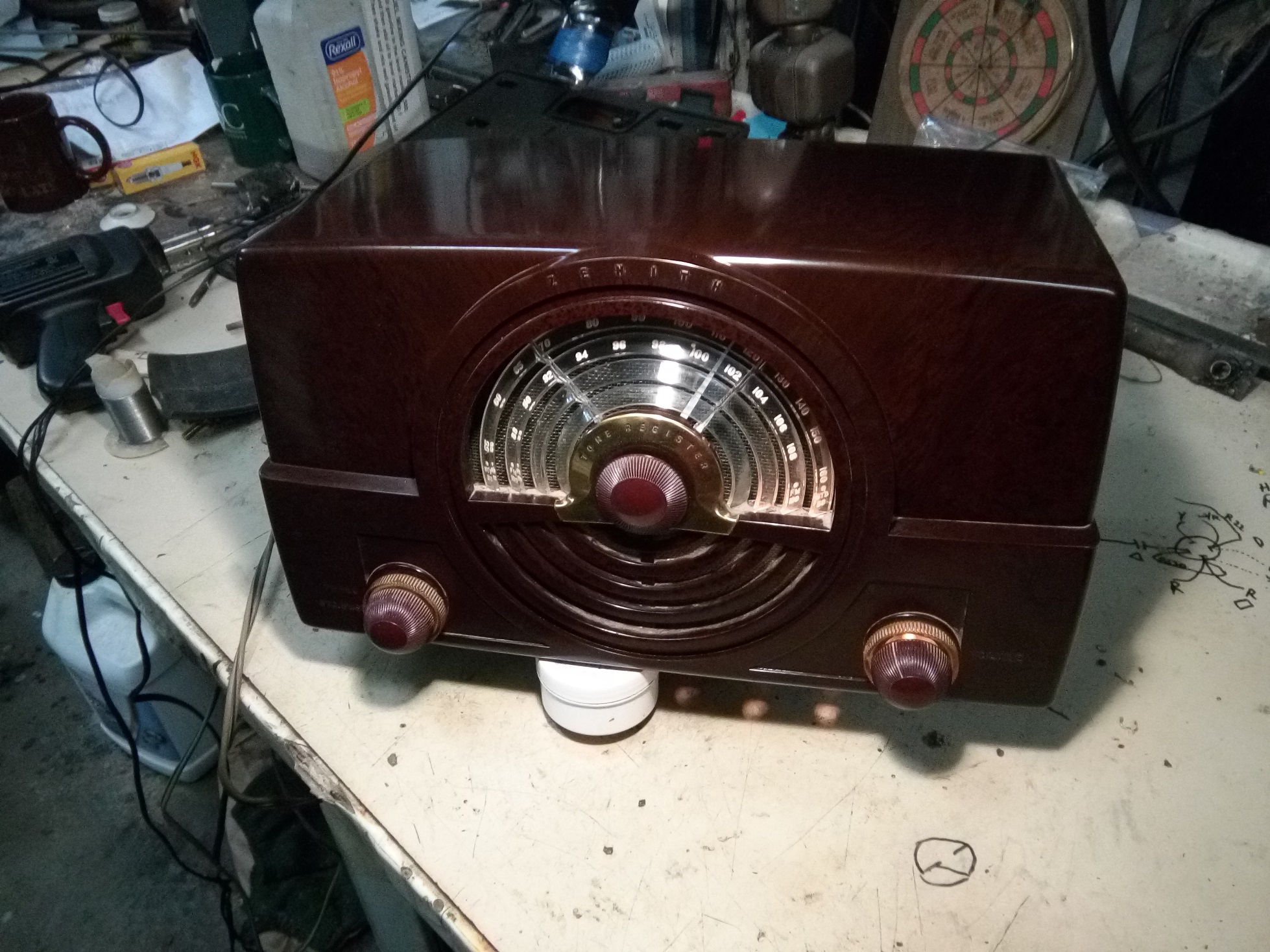

put it all back together and works great.
she cleans up real nice and to be honest,,, the sound out of this thing fills a room!!!!!!!!!
its hard to describe but for a single speaker it sure does sound like stereo to me.
FM works great without a rabbit ear antenna and i have no idea why. ,,, however, fm is broke from 94 on down... no biggie.
here's a pic of it all cleaned up.
here is a video of it playing with no gargle.
