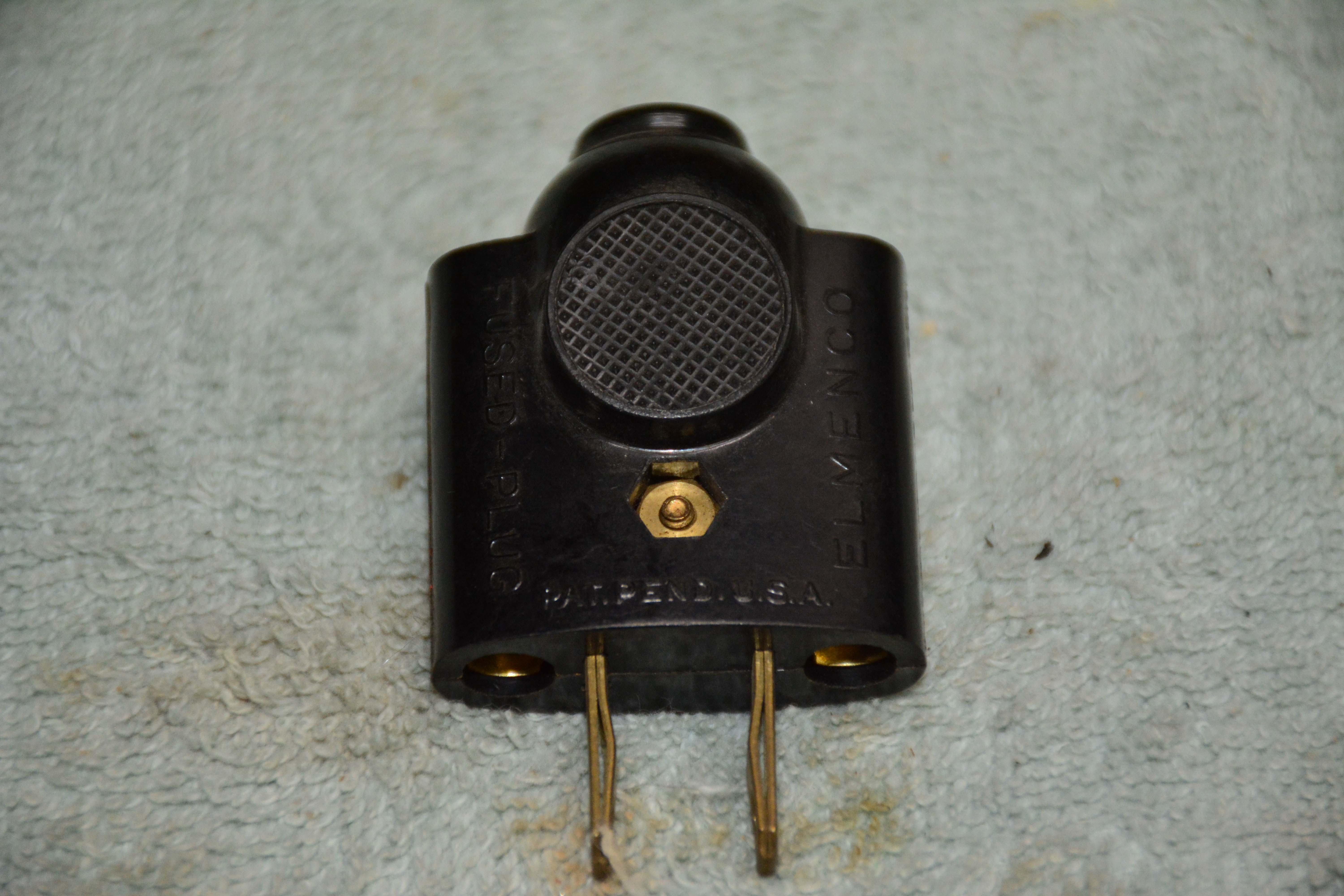

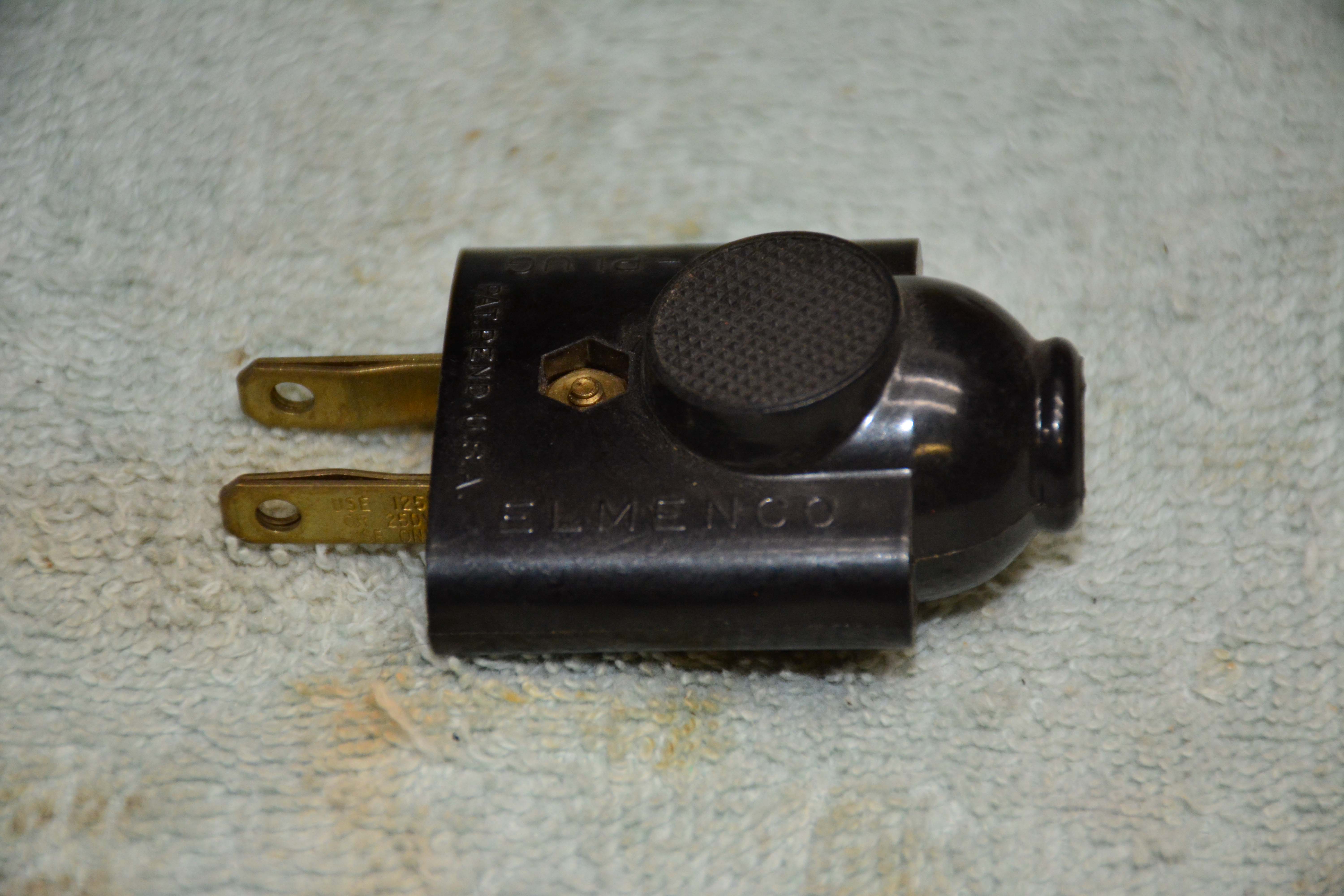

I have a few Elmenco fused plugs. Are these at least similar to what were used back in the day? Made in the USA.
37-116, 37-690, 38-116, and 38-690 used those Elmenco plugs.

I'll start using these instead of putting a fuse holder under the chassis. I've got 20 of them!
