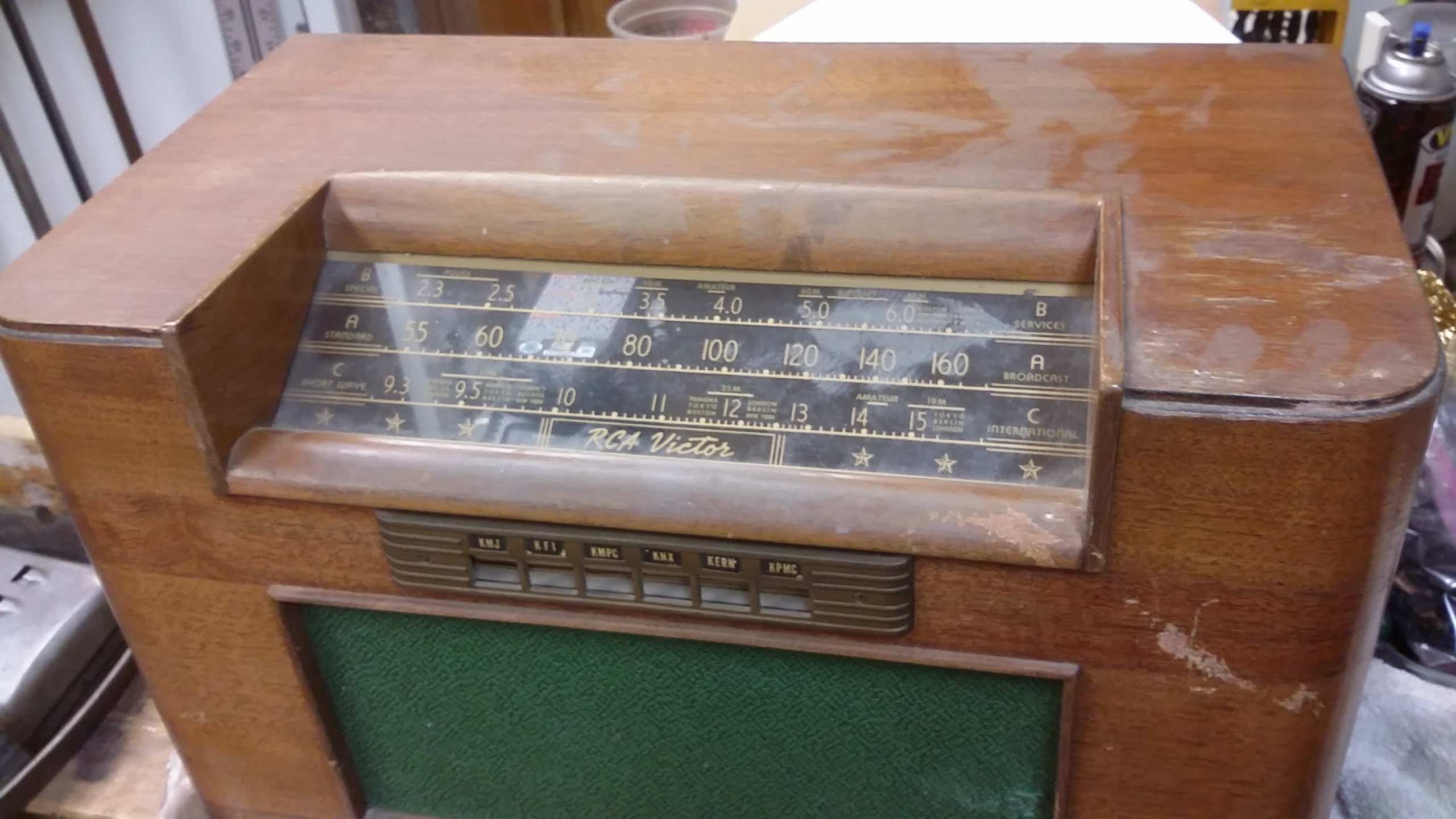

New project RCA 28T

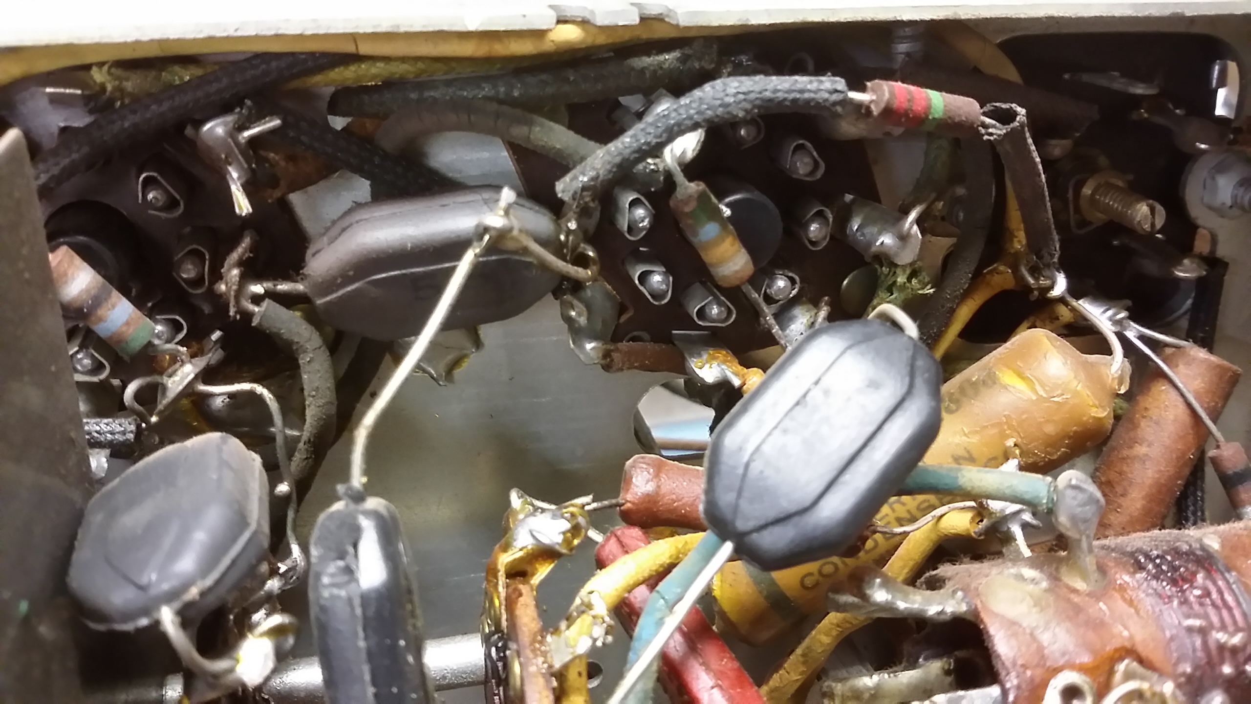

Do these cough drop looking caps have any reputation for being bad or good?
And I found a little surprise.

And to answer your question about the mica cap - The "cough drop" mica caps can and do go bad. They are often cracked open, or swelled up and about to crack open. Replacement is the cure. Icon_smile
I had some bad mica caps in my RCA 6T2, and I just replaced all of them as it did not have that many.

I have an 18T which I restored. It is very similar to yours, just a few years older, just before WW2. check the schematics, they are practically the same. They even look like siblings.

Some of those mica caps are dependent on the casing to keep the capacitance @ a fixed value. If it's cracked I'd replace it.
