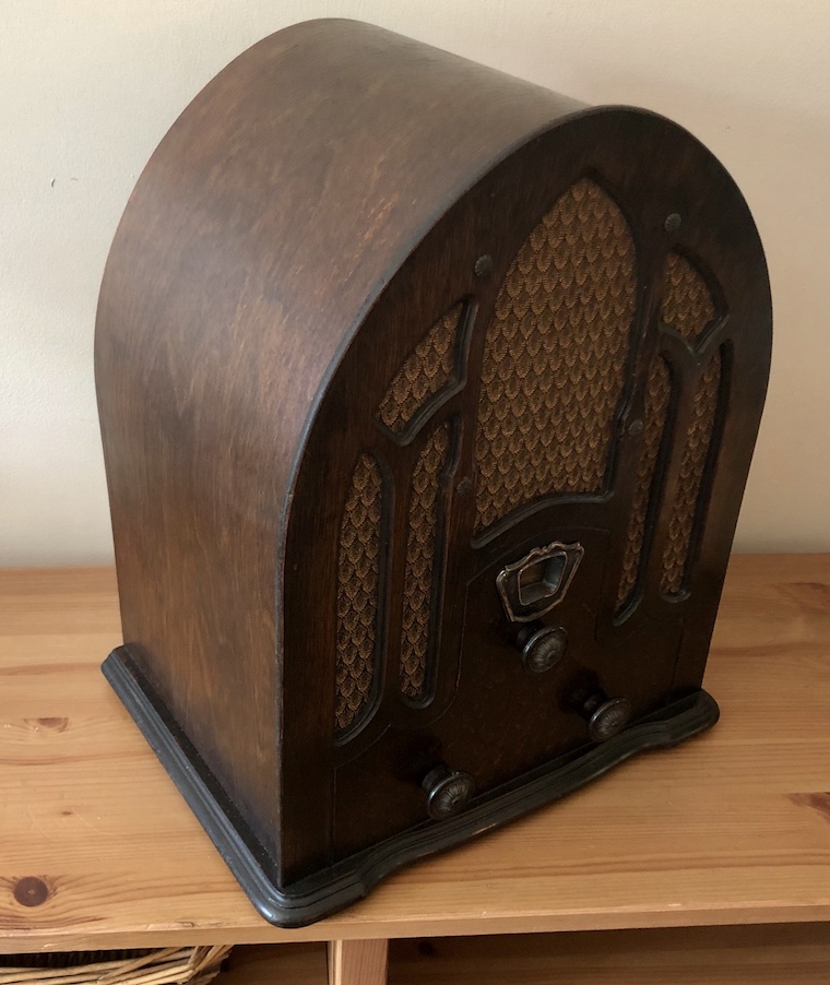

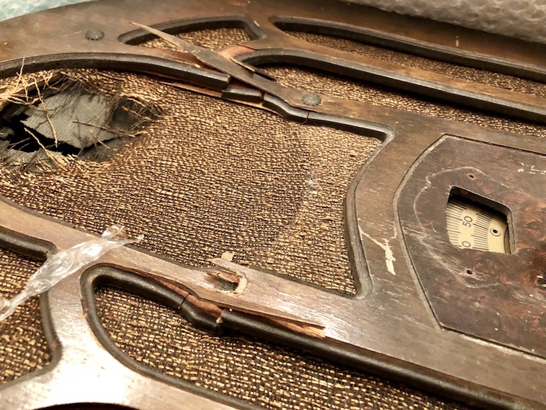

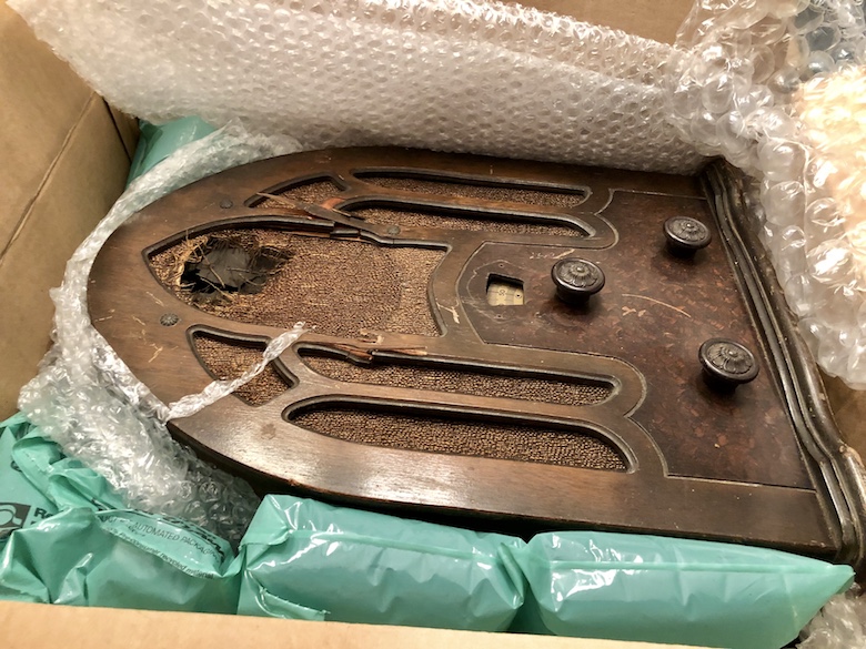

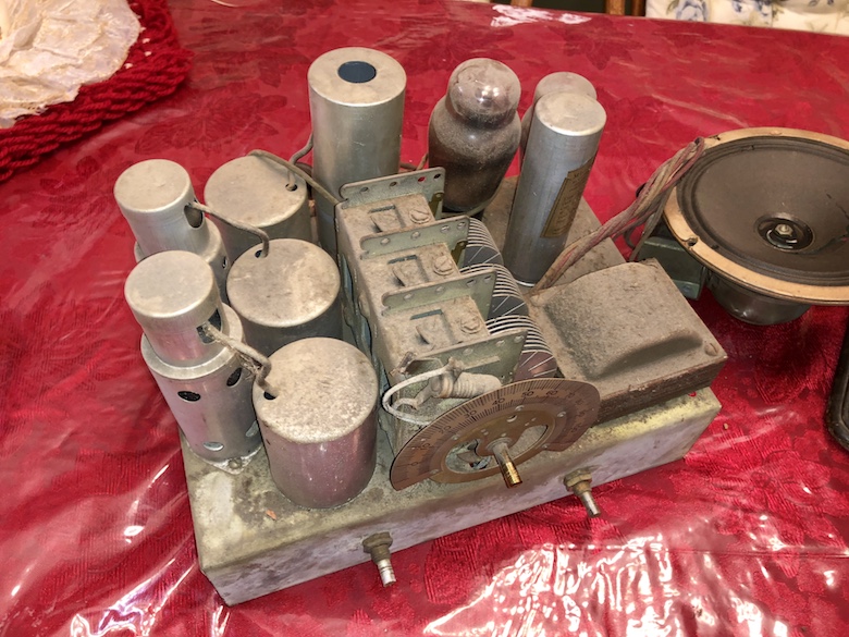

I bought this 3 weeks ago and it was shattered in shipping. It had no name and no bezel. Everything was crusty inside but I liked it. I am stuck watching dad during the nights so I need projects. I figured this one would be good since I could do it in the house.

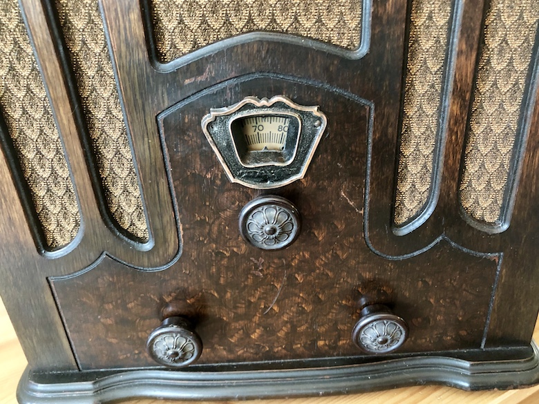

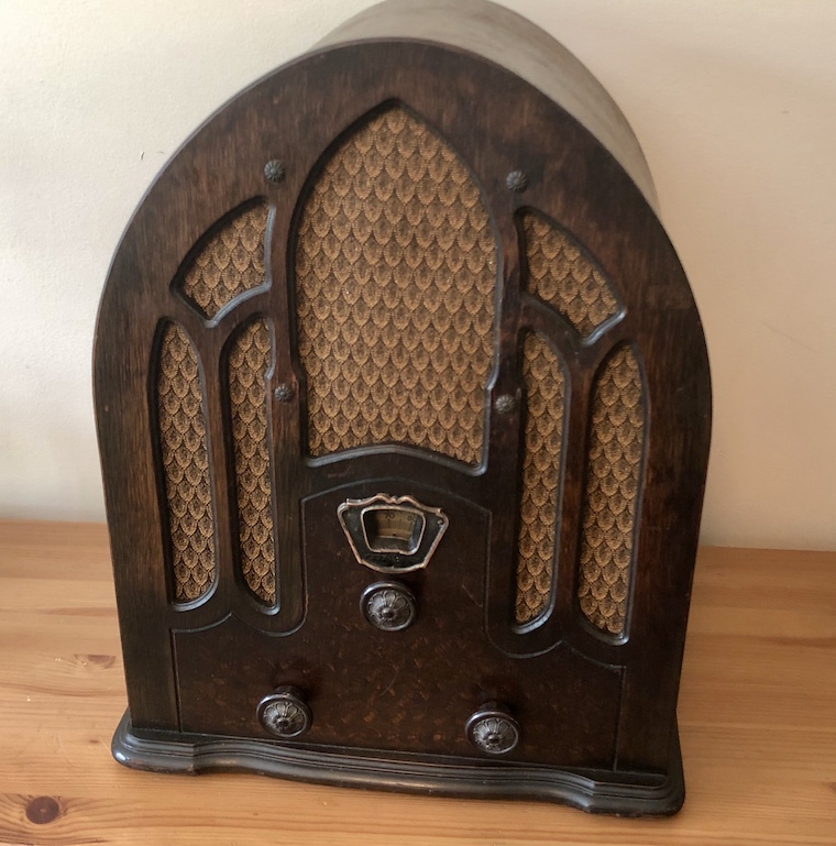

 I actually saved the original finish with some paint matching and color sticks. She is not perfect but she is a beauty to me.
Kenny Richmond provided the Grill cloth.
Julie N Marty McCall provided the perfect escutcheon. It was a Stewart Warner but I shaved off the name and matched the original patina.

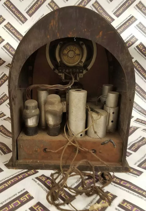

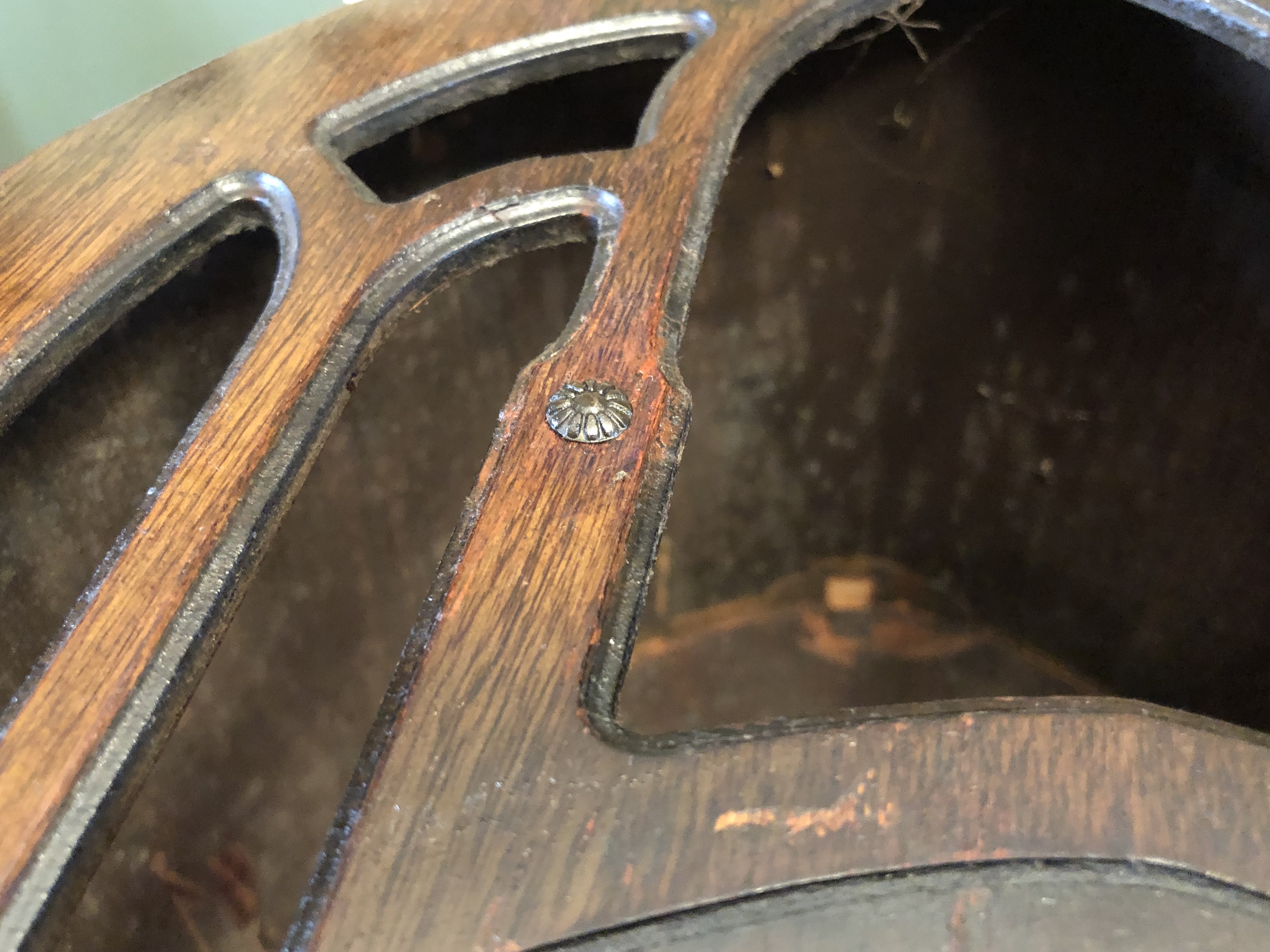

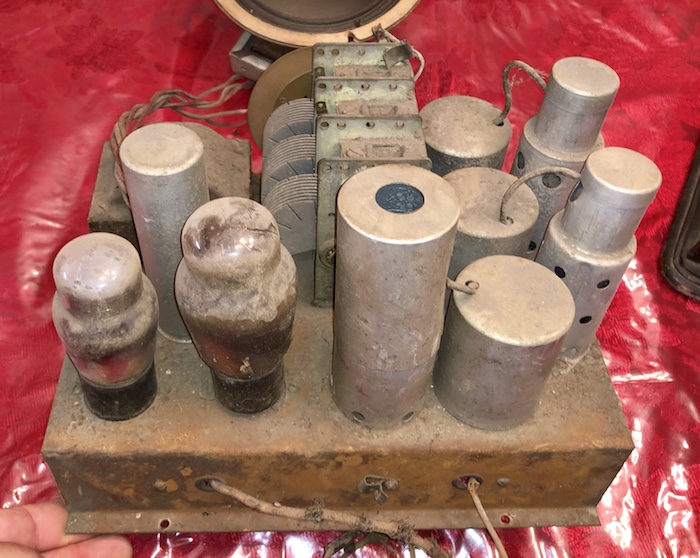

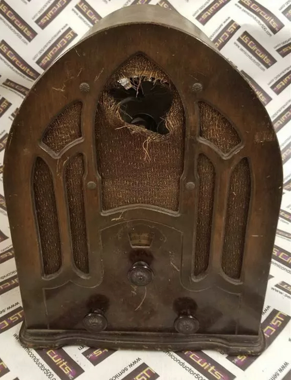

   From the eBay listing

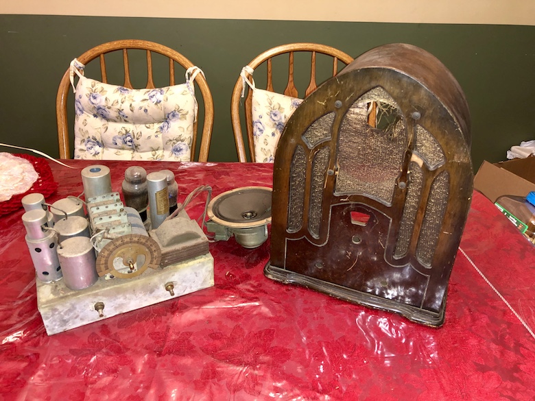

How it arrived:
Getting Started!

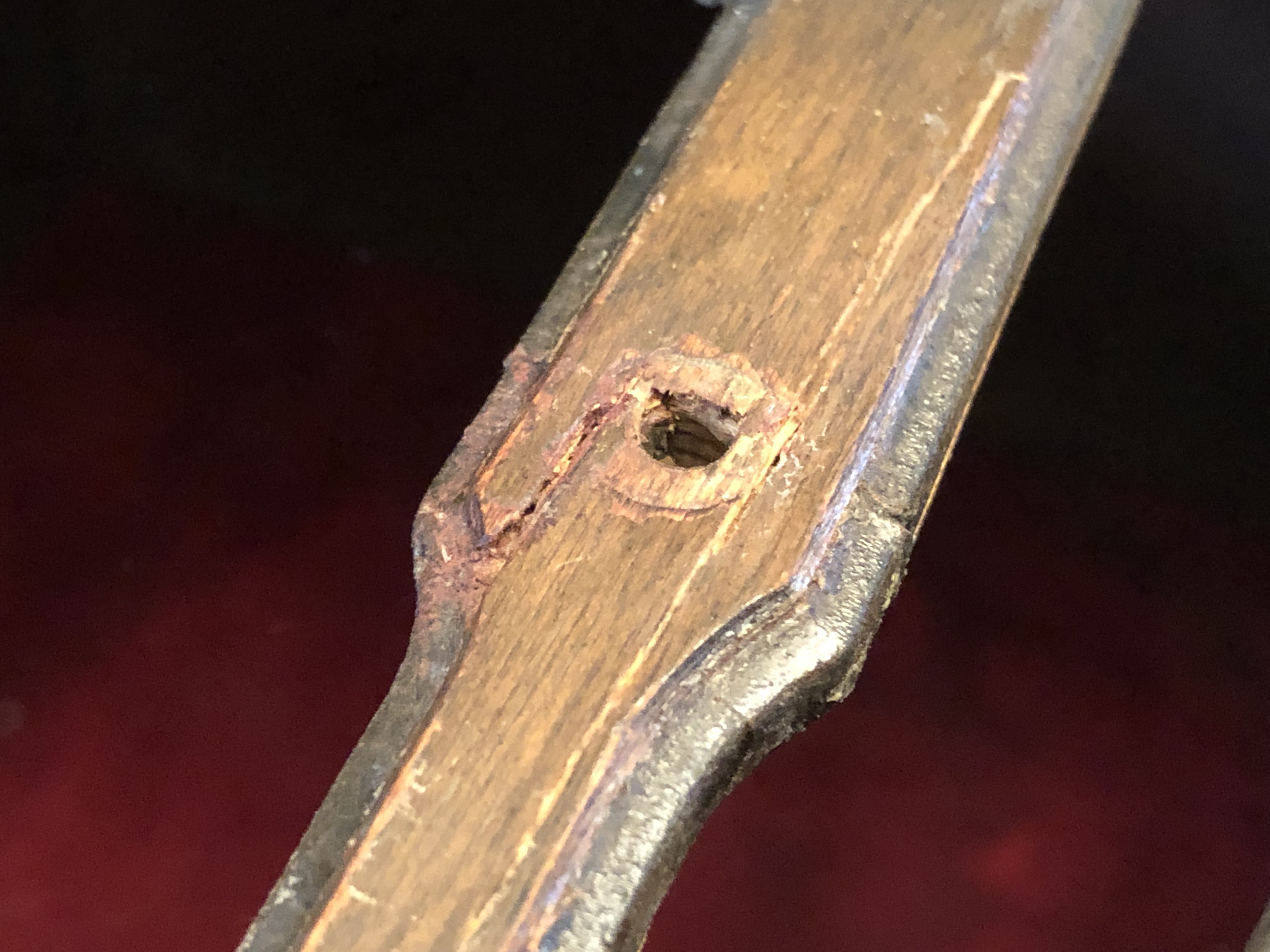

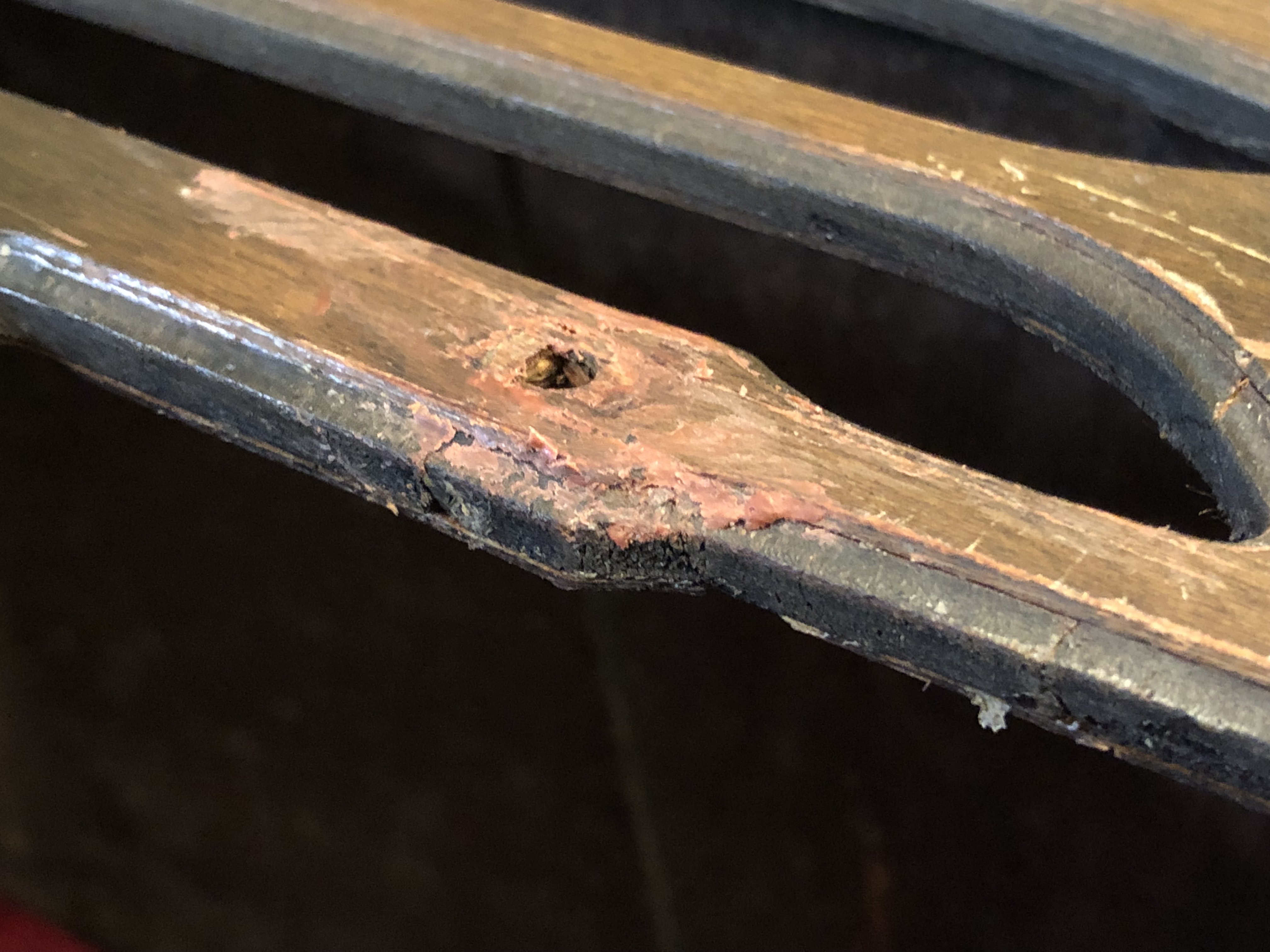

Gluing was a fun process. filler sticks for my moms wood floors, popsicle sticks, paper clips, and glue.
Great save! Icon_clap Icon_clap Icon_thumbup Icon_thumbup

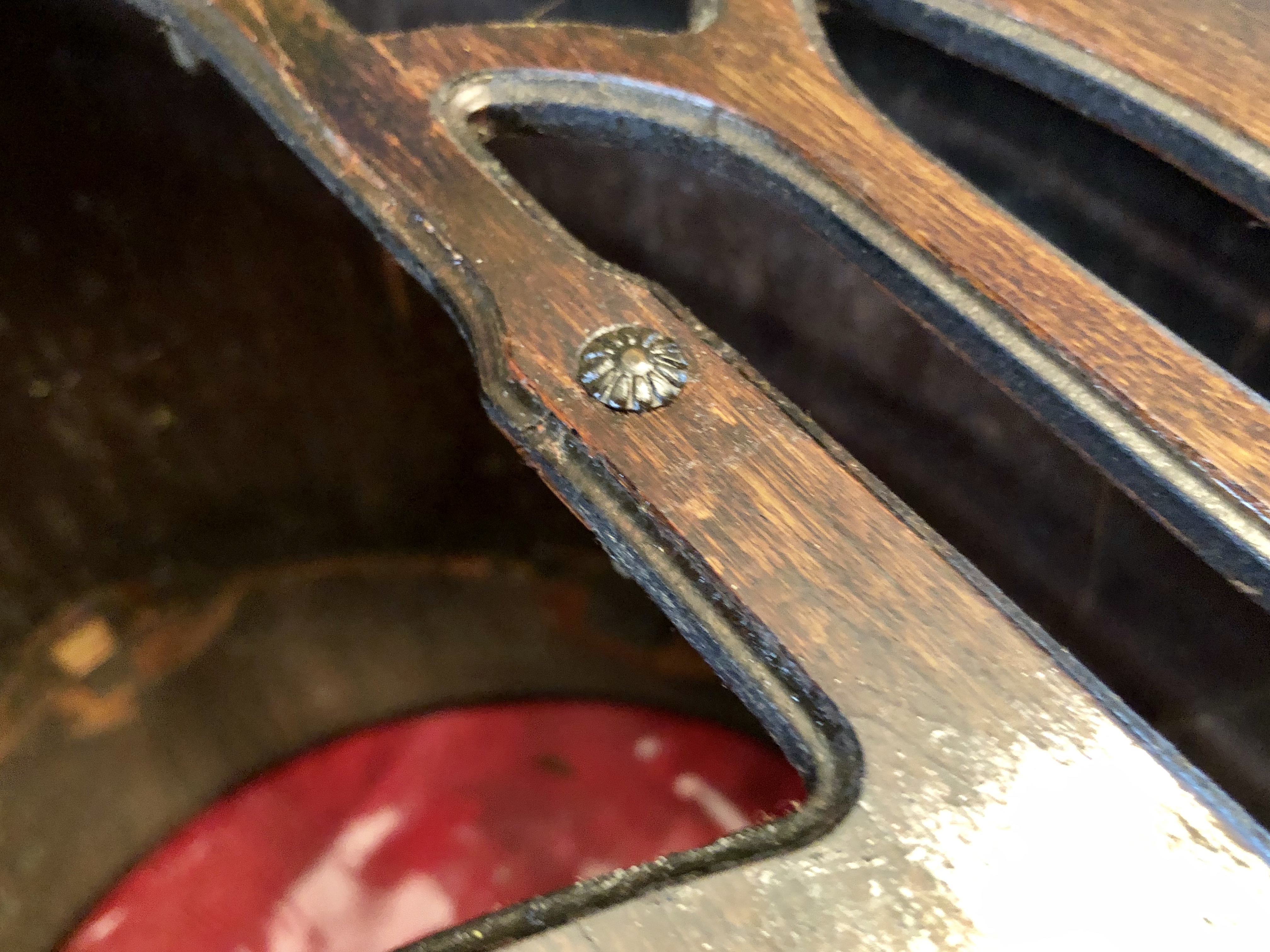

Color matching and touch up

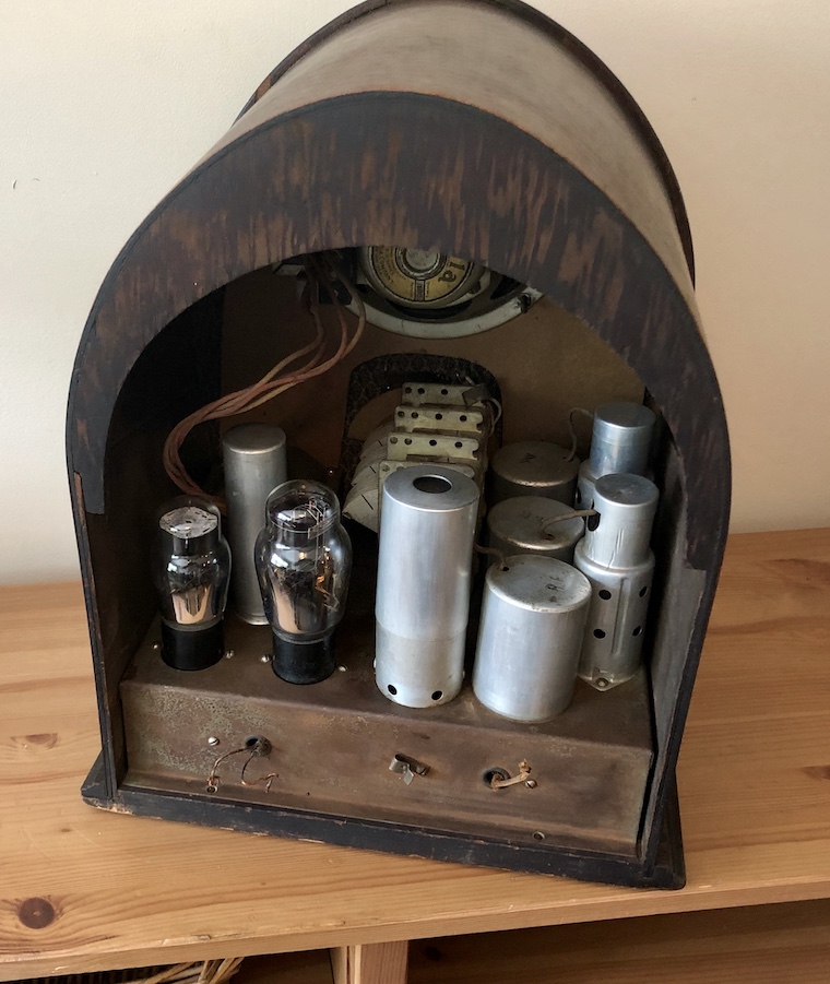

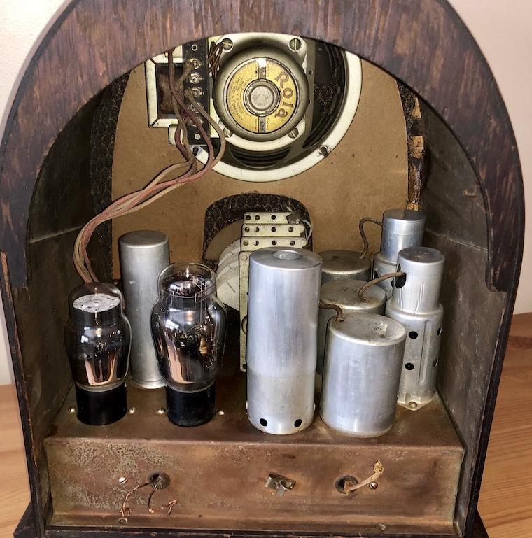

Chassis clean up.
All washed...
Cabinet wash and touch up.
Looks similar to one of those gothic GE J-series models.
Nice Work!!!!
Great save Kirk     Icon_thumbup
Outstanding work. Also a very nice-looking model.
I'm glad you didn't paint the chassis. I don't think I would ever do that, ( with all due respect to those who do or have and have turned out some great-looking chassis'. )  They do look nice, but I would always worry about poor ground issues. And there's that authenticity-thing as well.
Nice one Kirk!
Excellent!

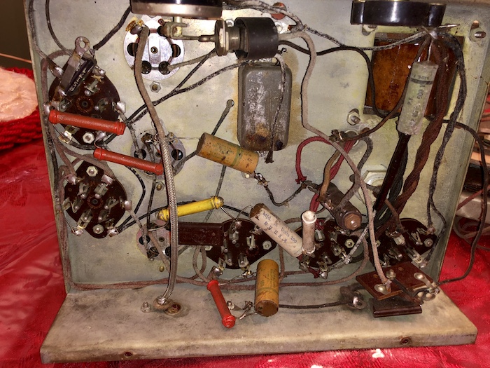

So far still no broadcast, I am posting pictures of #14 Oscillator and also a resistor #27 which connects to an XXL tube...osanders0311 — 04:02 PM
