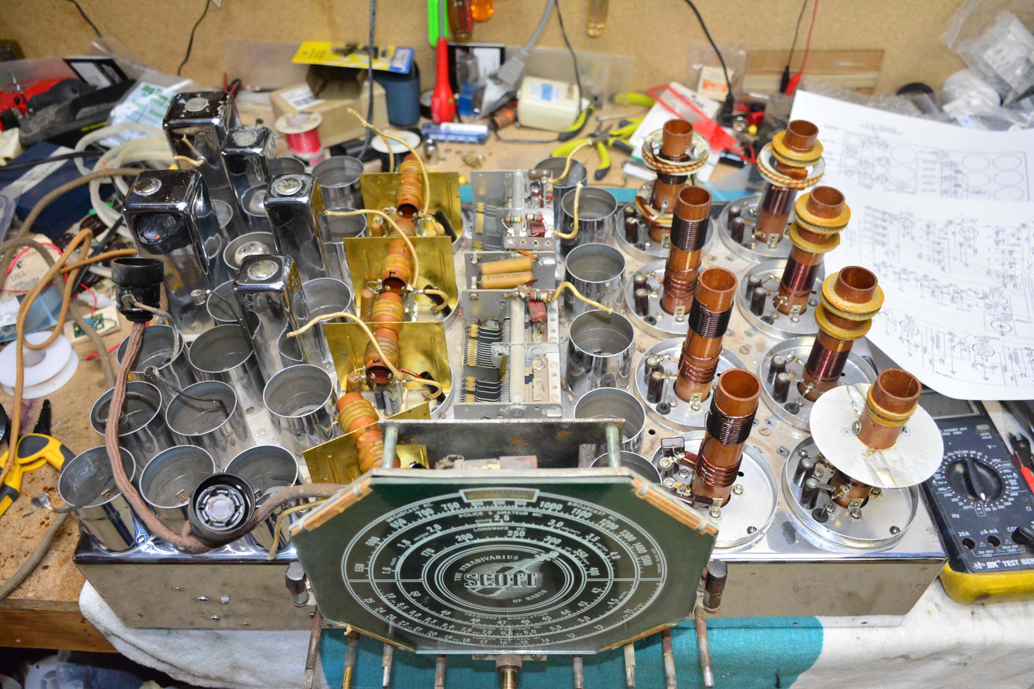

Well rats! My local chrome plating shop went out of business. Went to take in the power supply chassis and all the parts only to find the doors closed with no new address. One of the guys on the EH Scott forum uses a shop in Wisconsin that I'll have to try. They even did the very thin aluminum coil shields. So maybe this is a blessing in disguise.

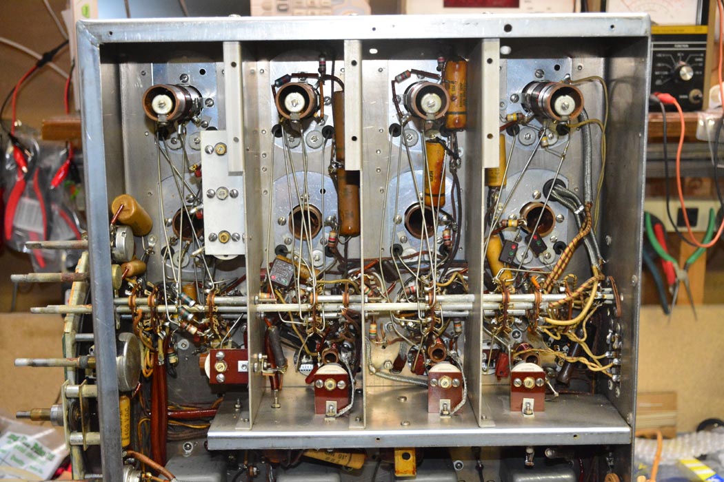

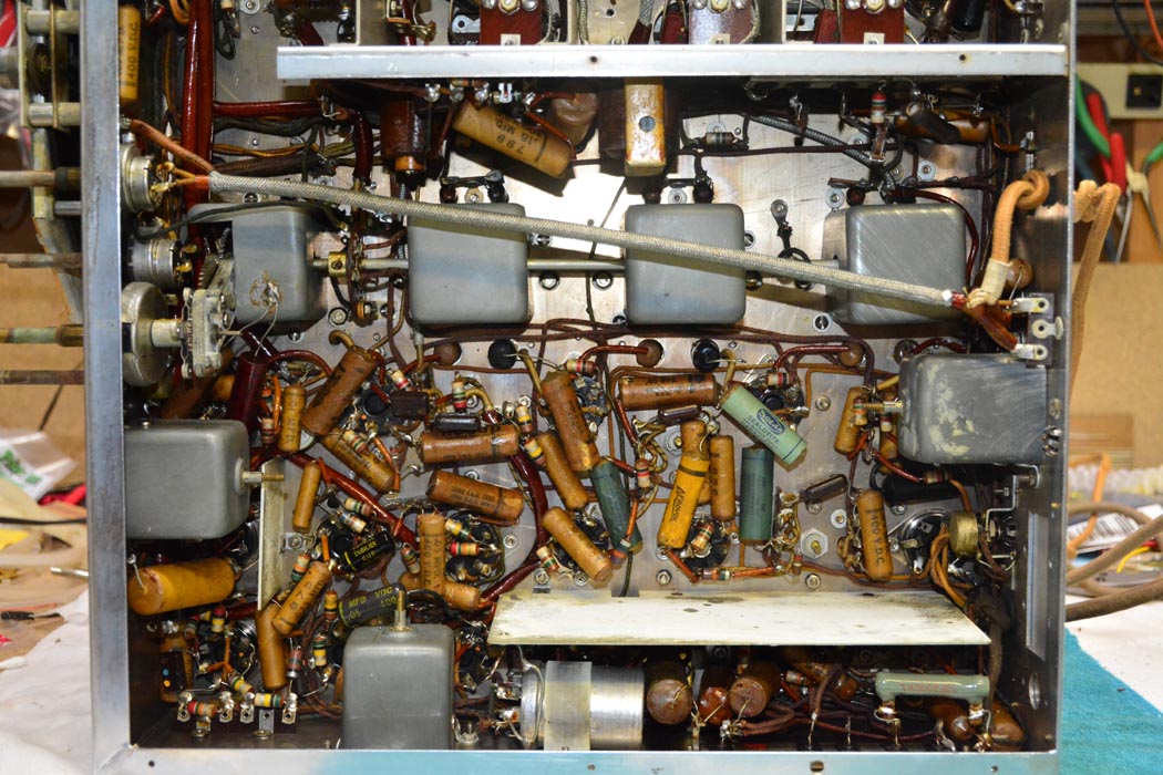

Parts for the power supply have been sent off to a shop in Wisconsin. They'll also do the thin, aluminum shield.
While those parts are gone, I decided to take a closer look under the tuner. A few caps have been changed, and the candohm is obviously bad as there is a resistor soldered across one section and another section is out of the circuit. Otherwise, not messed up. However, I'm beginning to agree with morzh: Night Mare! Stripping this chassis completely and then reassembling will be a LOT of work and full of miss-wiring possibilities. And I thought the EH Scott 16 I did was bad enough! I said I liked complicated radios. Well, this is it.
