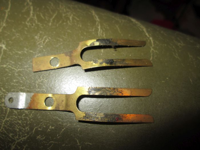

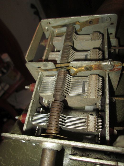

Yesterday I jumped in with both feet and removed the tuning cap. I was quite surprised how dirty it was even though I "cleaned" it while it was in the set. Lots of q tips later it was reasonably much cleaned. Didn't do much with the two back sections just cleaned around as much as I could without monkeying up the the trimmers. Did drill out the  rivets that hold the rotor forks and removed them for a clean. They had this hardened black crud on them that was a little difficult to remove. The two oscillator trimmer came apart which was part of this operation to see if I could get bands 4/5 work properly. Was using MEK for this job and was still a bit of a job. Replaced the rivets with small screws and solder on the pigtails to reconnect the cap to the set.

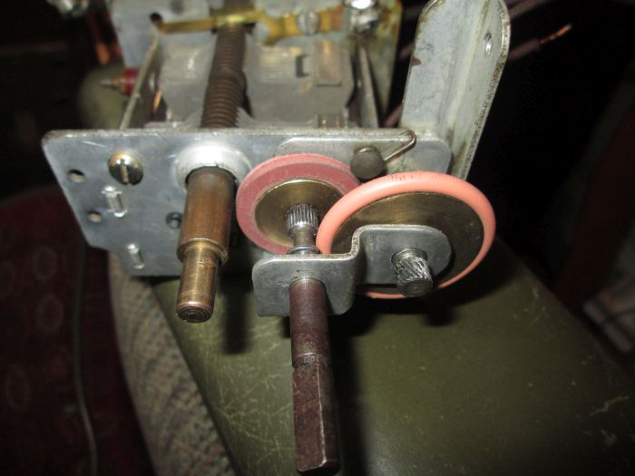

Still had the problem with 2nd gear on the dual spd dial drive. 1st gear was ok when I got it with a new o ring. The small o ring someone tried to "fix" it by slipping a larger o ring over the bad original one. That had to go. I found a little box of o rings and found one the fit just dandy, but it wasn't tall enough to meet the drive shaft. Hmmm... The only other ones I had that were close were these red garden hose washers. Too thick and too tall. It met Mr Dermel. Was able to narrow the inside lip to fit the hub and then mounted it and spun it on my drill up against a piece of sandpaper to decrease the height. Now both speeds are working swell!

I find Dills pipe cleaners very useful for cleaning the plates of a variable condenser.

Nice fix on the two speed tuning drive. When it works, that feature is one of the set's many real assets.

Kudos on getting the rotor forks cleaned up! This shows you are determined to get this unit working right. I have seen this type of problem on many radios, including some manufactured much more recently. Did you also clean the mating surfaces of the rotor too? I expect you did. I have had a few stubborn cases where I had to put a small amount of silver paste between the rotor forks and the rotor surface they mate with in order to stop drop-outs at particular points of rotation of the tuning capacitor. I used some silver conductive heat sink compound made for CPU mounting. I applied it using an Xacto knife blade with the capacitor reassembled, carefully working the compound into the space between the forks and the rotor shaft.
Another possible trouble is when one of the capacitor vanes comes so close to the vanes it meshes with and shorts out at a particular spot. Those can be difficult to spot. Bright light and a magnifying glass can help spot the offending section and vane(s). Repeated careful moving of the vanes with the Xacto knife can usually clear the short. Watch for corrosion on the vanes. Some radios are known problem units in that regard.

The "black crud" you mentioned is something I have seen on most of these tuners.  Is it possible they used grease mixed with graphite to improve conductivity?  I was going to experiment with that sometime, but haven't yet.  The silver paste sounds like a more modern solution.
