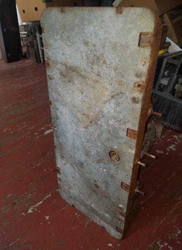

Chassis ID...
A 9 tuber with a c7 bulb under the chassis.
Any ideas?

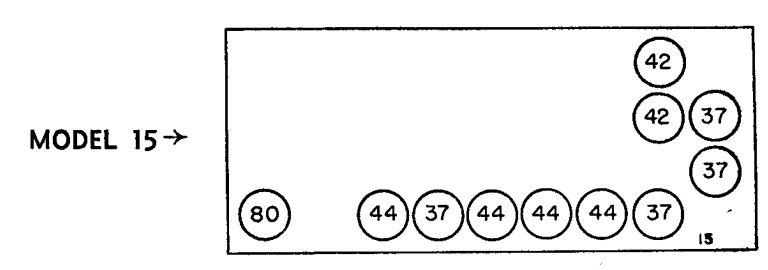

Sure sounds like 15X. At least that's the only one I've seen with the light under the chassis.
https://philcoradio.com/gallery2/1932b/#Model_15X
Are you sure it's only got 9 tube sockets?
P.S. - Don't take this the wrong way... but the condition looks a little rough. Icon_razz
Haha,
It is not mine and its parts only Icon_lol
He said 9 but I will ask...
Thank you Sir!
Kirk
Nathan is correct. Only model 15 has the light receptacle under the chassis.
Also notice the shadowmeter. The only chassis of that style which has a shadowmeter is model 15.
