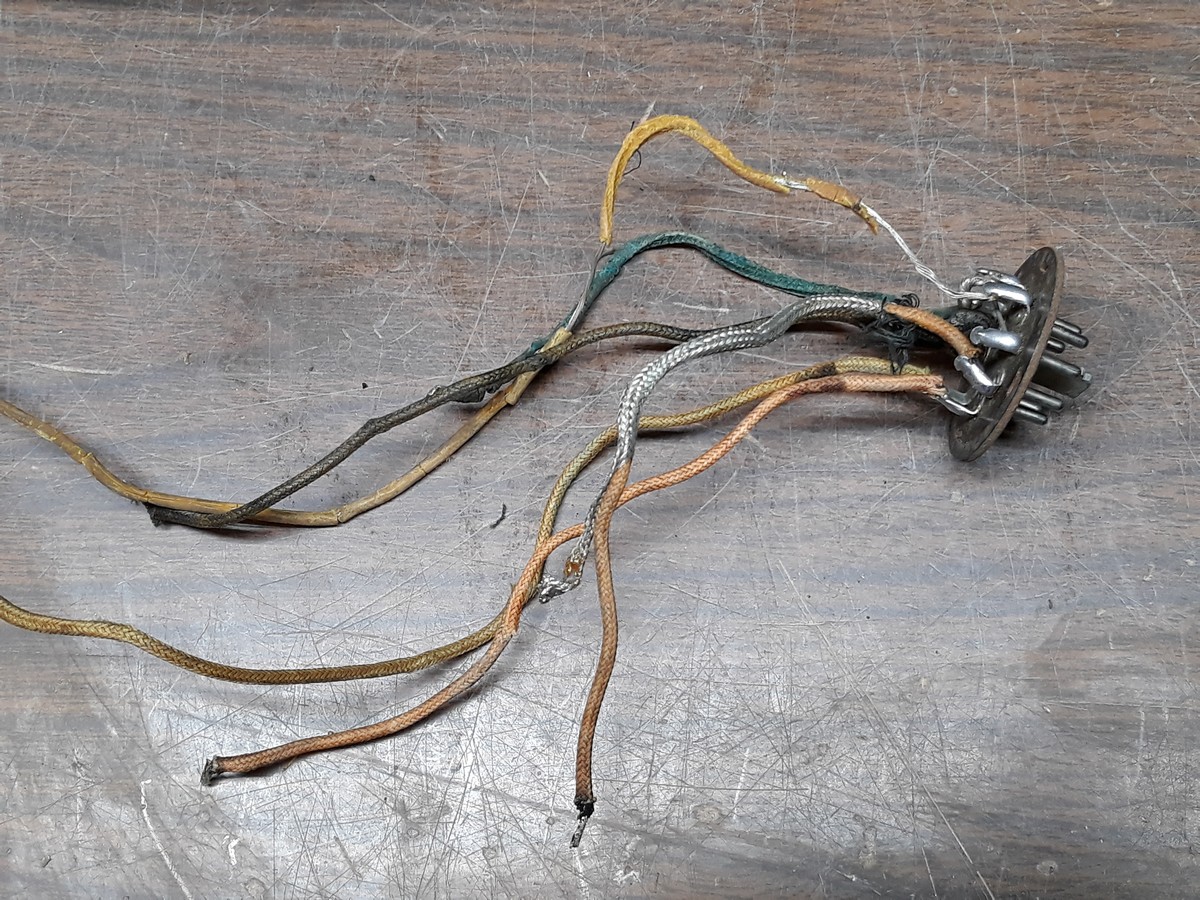

I also removed the interconnect cable which terminates in an octal plug in preparation to replace the individual wires with new ones:
I don't feel very comfortable running the heater supply through the 22 gauge shielded wire that came with my Mouser order. One side of the heater string runs through the center conductor...the other through the shielding.
I do have some 20 gauge shielded wire coming from a different supplier, but it won't be here until Saturday at the earliest. But still...both sides of the heater supply running through a shielded wire. Hmmm...

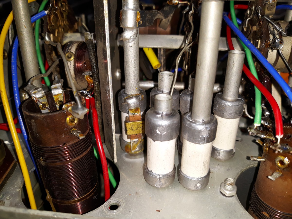

There are a few mica capacitors which are soldered to the trimmer capacitors, such as this:
I decided not to replace these, since those metal rings you see around the trimmers are made of solder, and I didn't want to mess them up.

Here, I have removed the covering from the interconnect cable. This will help me to determine how long each individual wire was, so I can cut new ones to the proper length.
New interconnect cable.

Somehow I managed to make the interconnect cable slightly longer than the original.
I guess that's better than having it too short.

Edit: I forgot to mention that the 20 gauge shielded wire arrived today. This is what I used as part of the new interconnect cable.
