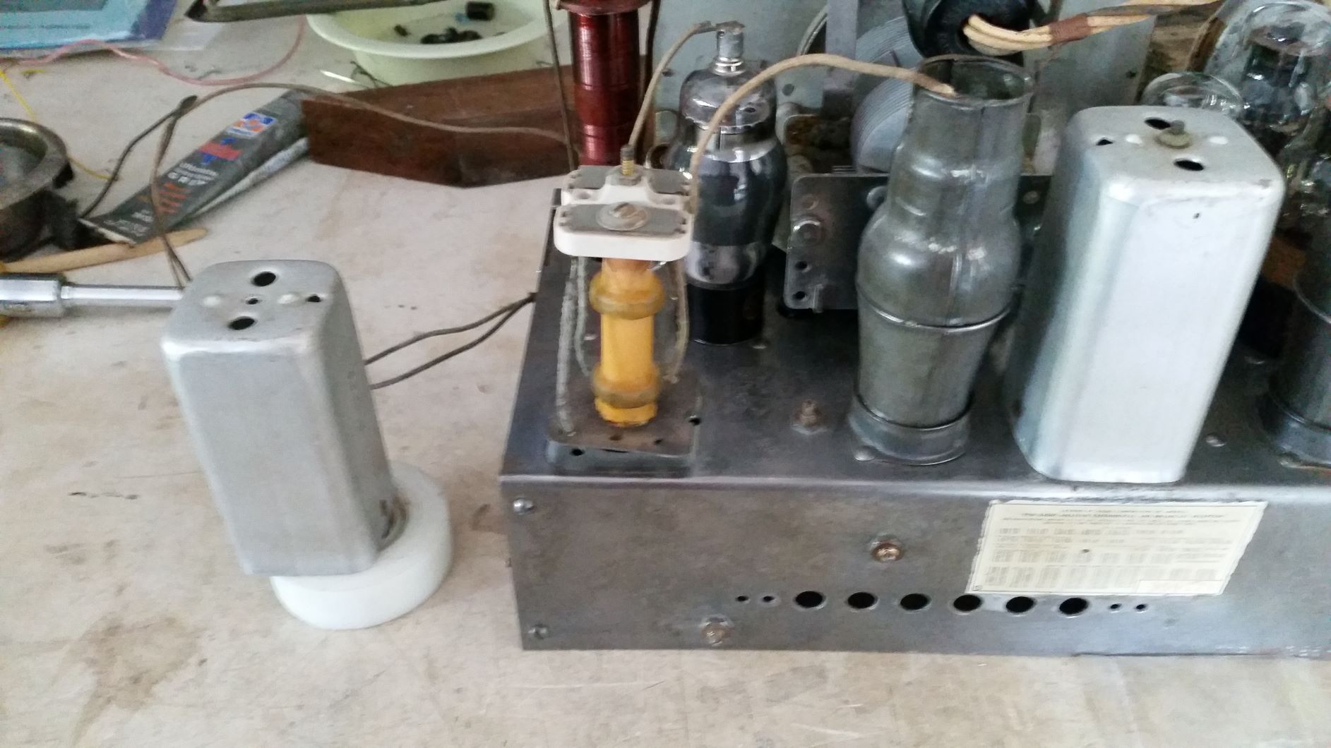

#67
More investigation yesterday. Carefully (and with some difficulty) I was able to remove the can from around the first IF transformer. Before this, I tested its continuity to the chassis again, and grounding did seem precarious. Inside, there was no obvious damage from the short, but the trimmers were very dusty. Wiring and wax dipped coils all looked good. On the inside of the can, there is one spot that looks to be where the flash-over occurred, at a position near the trimmers, and coincident with the high voltage locations. No sign of what caused the trouble.
This will give an opportunity to replace the slightly shabby wire to the grid of the #78 IF valve, and perhaps the other wires running under the chassis. I may get it running again this afternoon.
The transformer is interesting. Two coils, spaced quite far apart - perhaps ~3/4" - wound on a wooden dowel and dipped in beeswax. The compression trimmers are carried on a square ceramic support attached to the dowel.
Cheers
Ed

#70
Here is a view with the can removed. Sorry the picture is a little blurry, I was a bit hurried, and working in low light.
The can was put back together after cleaning and adding a new top wire, and the radio played nicely again.
#71
Yup...it looks just like a 1939-1942 Philco IF transformer.
