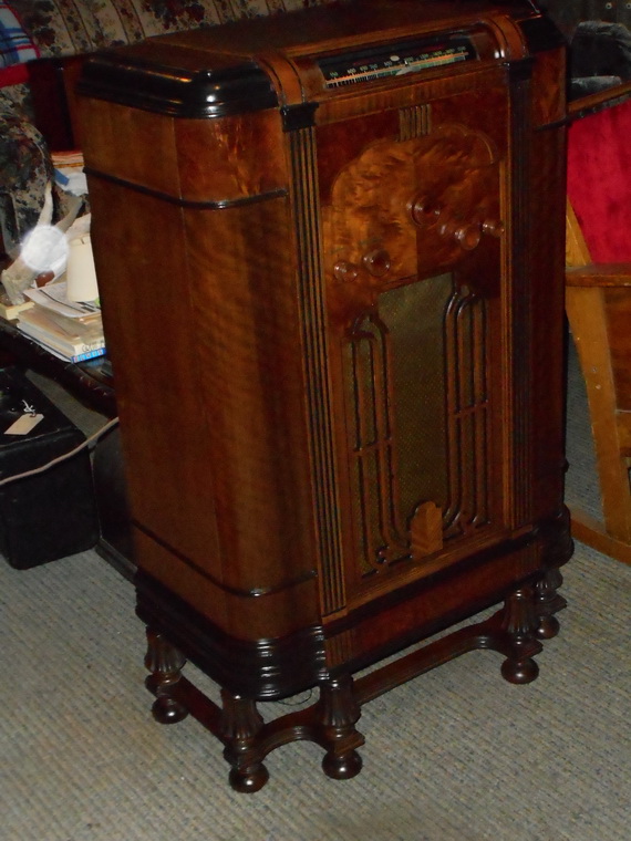

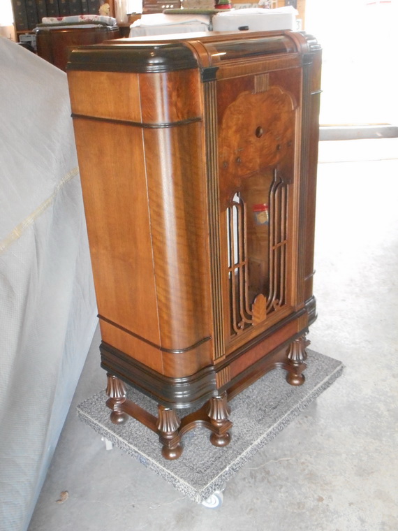

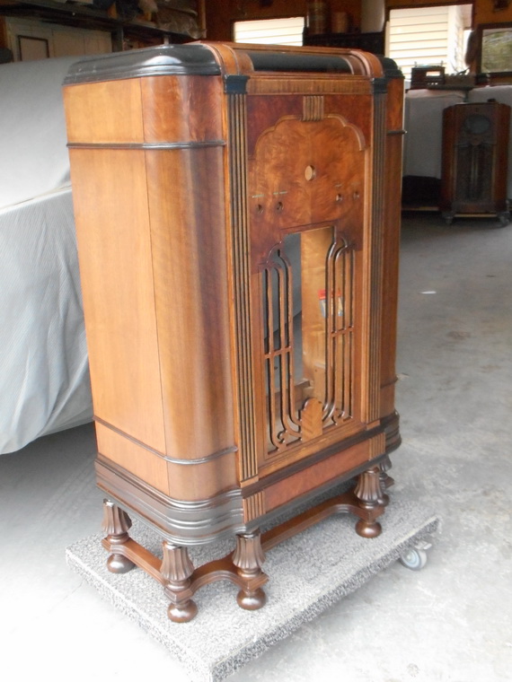

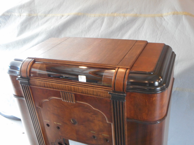

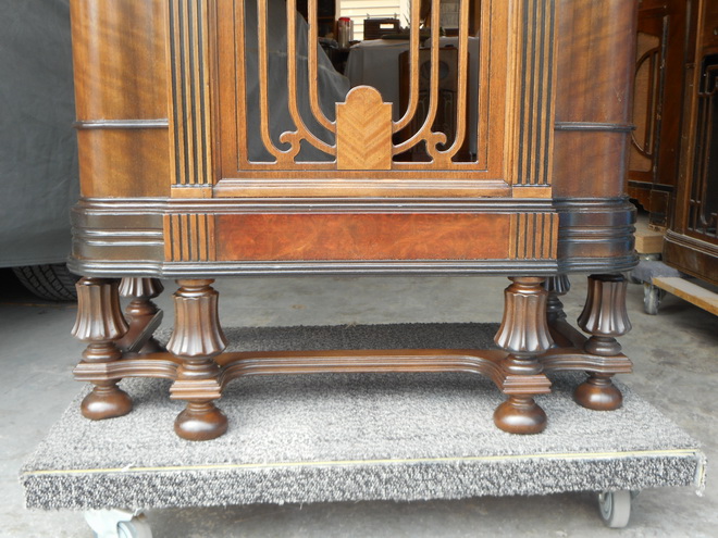

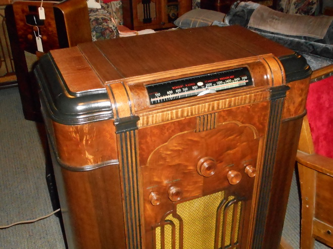

Rogers 10-85 cabinet all done
I like these Rogers radios,especially some of the cabinets.
 I picked this one up last fall and during the winter I did the chassis,
and replaced the top veneer.
 Now I finally got the cabinet done.

Dan,
It looks great! Probably better in person.
Henry

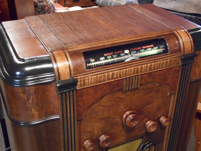

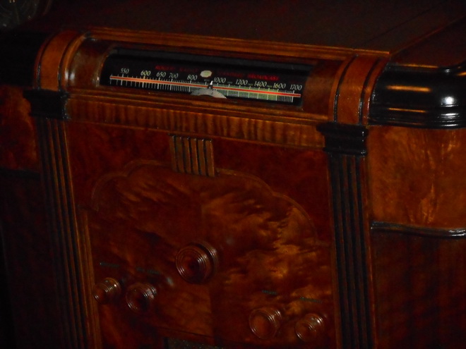

There is a small light bulb in the dial scale that is tied to a grid on one of the IF tubes. As the signal changes, this bulb glows brighter. The reason that I asked is because it is hard to find a suitable bulb. I used one of the very small "grain of wheat" bulbs.  - - going from memory - - It is easy to miss this function altogether.
Now I unde5stand what you mean by a ''signal strength indicator''
 I guess I just call it a tuning light,   On my Rogers 10-12 There are two of them, and on my Rogers 6R932 there is one in the very center if the cabinet.
   I also have one in my DeForest Crosley 'Buckingham, and some of the tombstone models have them also.
 It took me quite a while to find the right bulb,but once I did  I ordered 20 of them, because I am always running into Rogers radios.
  The biggest thing about the bulbs,   [I found ] was the amps had to be just right
  The bulbs that do the job are   #1448.
 Dan in Calagary
   Living in Calgary Alberta
The tuning light indicator works good on this one, and I finally got it all back together.
