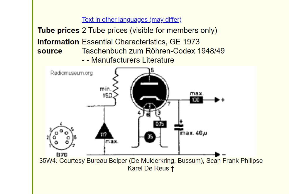

I think it's necessary to keep in mind that most (with a few exceptions) tube data sheets show "typical" operating values, not maximums. When I look at other schematics and most spec charts, I see "typical" of 40uF in the specs, but many schematics with more than 40uF, and I have seen and replaced some of these myself, usually with 47uF caps. Keeping in mind that these sets have operated for several decades like this, it is my opinion that this 40 vs 50 is a tempest in a teapot and unworthy of much debate. I believe the schematics are correct as drawn and are not errors, and I personally will continue to NOT second guess the engineers who designed the radios in the first place.
For yourselves ..... ??? ..... do as you wish.
(This post was last modified: 09-12-2020, 09:19 AM by John Bartley.)
John

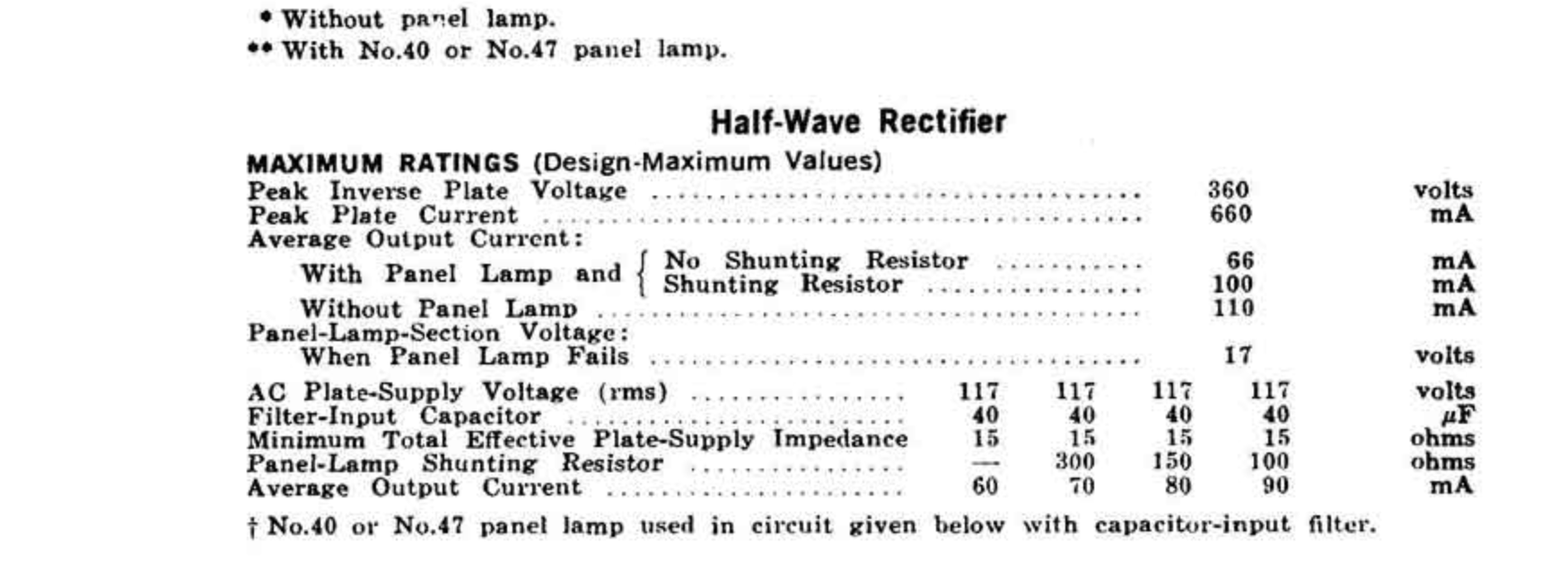

Yes, I have already seen that.
Did you read my post where I said "with a few exceptions", show typical, not max?
One sheet showing "max" beside a cap value does not negate a whole bunch of spec sheets showing "typical" for the same value. If you wish I can show you one to off-set yours, then we can keep arguing, but why waste our time? I'll keep following schematics and OEM installations and you can keep re-engineering if you wish.
John
I am not a life-long tube designer and so I do not keep the tubes' datasheets the way I keep semiconductor ones, and so I have to go by what what I find, and so fat what I find has the words "maximum" and "40 uF" next to each other.
I saw one sheet showing 40uF undet "typical" but then it did not show maimums.
So, if you produce a datasheet that says explicitly "maximum 50uF" I will agree with what you say.
Meantime, here's another one for the same tube I found.
And....speaking of "several decades of operating like this", we do not know how many time this tube was replaced.
PS. I am not saying the tube will immediately go up in smoke because of 50uF. Or even 100uF. It might last for years and, given today's "once in a blue moon" operation, might live forever. But to me this is a wrong way to do things. Even if it works.

OK captain, your pair of 47's will (more than likely) be fine and last a long time.
But instead of everyone getting in a p$ssing contest let's use this as a learning experience. I applaud Mike showing how to use tube data sheets to determine the max (recommended) value of the 1st filter cap. Often folks will randomly jack up the value of that cap trying to eliminate hum, but if one looks at the data sheet they can see the max value they should typically use. BUT, the 2nd capacitor is the one you can jack up the value on w/o damage to the tube.
The tube data sheet is also helpful when you aren't sure what the value of that capacitor should be, such as the label is not legible or some hack stuck in a ginormous filter cap at some point in time and the schematic is not available or capacitor values not labeled.
I like to have a couple hard copies of RCA's tube books around, but there are several that are available for download or you can just do a search for an individual data sheet for a specific tube.
Thanks Mike, for introducing the value of the tube data sheet for collectors who might not have been aware of their usefulness.

Also another effect of jacking up the first filter cap (yes I agree about the second as that one could be ...just about anything reasonable; the datasheet only specifies the first one), even within the specifications, is increase of the output voltage.
So, if one were to increase the value from 50uF to 100uF (and the radio was designed for 50uF value so all the tubes and their operations relied on that) the B+ voltage then would rise and the tubes would operate at unnecessarily high voltage thereby running hotter and having less useful life. Even if we disregard the ill effects of increasing the first cap directly on the rectifier tube.
That also has to be kept in mind.
