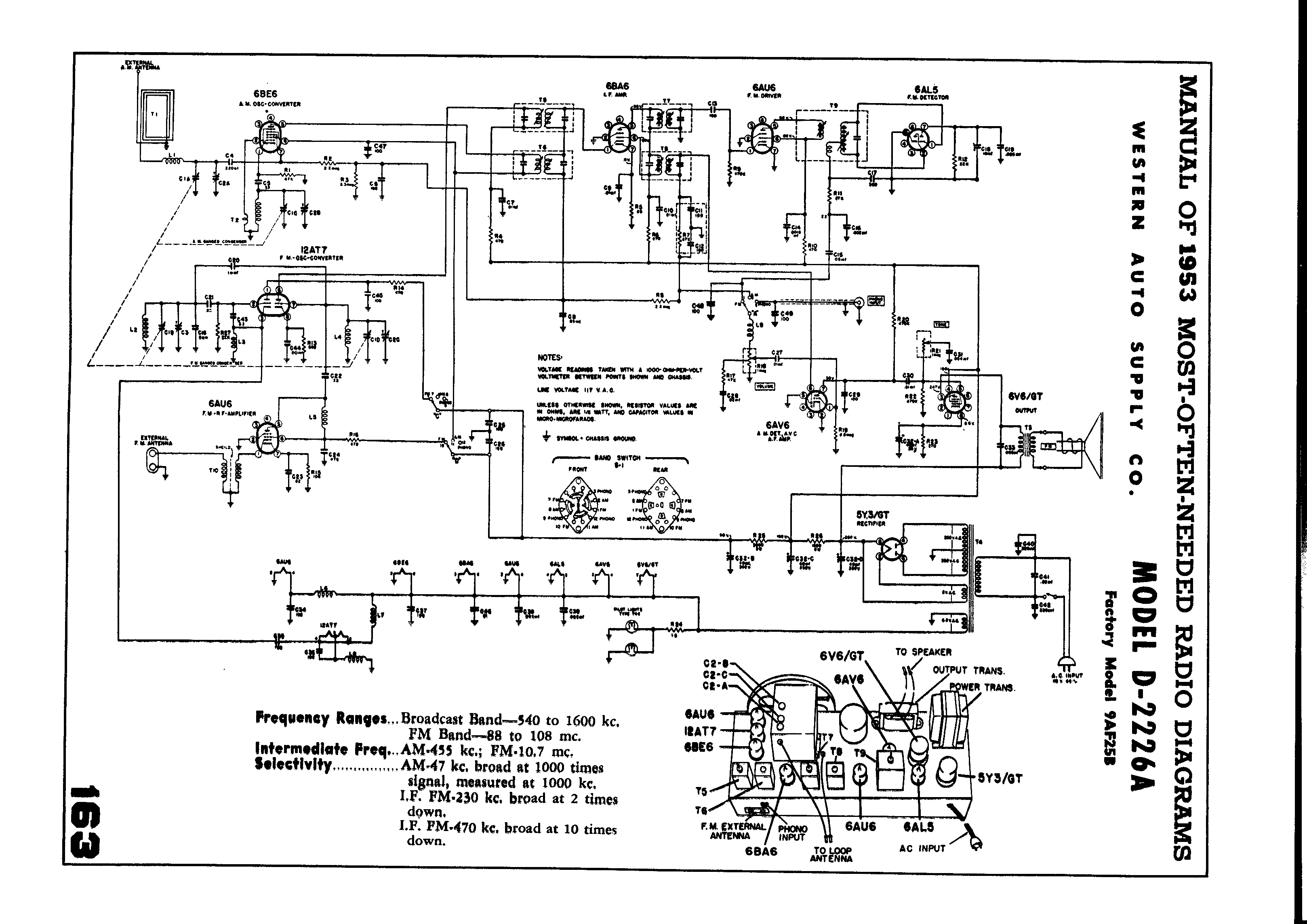

Find I am in need of some help. Bought a group of five radios. One that caught my eye and have begun working on is a TrueTone Model D2026 series B.
it is a 9 tube AM/FM radio. Problem is I am unable to find any resource for a manual.
Radiomuseum lists a D2026 series A which has the identical cabinet and controls. Problem is a D2026A is an 8 tube model.
Any suggestions would be welcome.

Just a guess in the B series using 2 tubes to due the work of the 6BA7. https://frank.pocnet.net/sheets62.html

Have a look see maybe this will help. David

BINGO... Thank You David. That is the same chassis as mine. I had found the schematic and alignment on Beitmans for a 1951 D2026A Factory Model 8AF29.
Which is the 8 tube model ,not the correct one.
You found the correct one 1953 D2226A Factory Model 9AF25B. The nine tube model.
The back cover on the radio has the same picture of the chassis as on the 1953 D2226A schematic. Only it clearly identifies it as a model D2026B.
So David you made my day plus have given me the correct info instead of me just guessing. In the not so distant past that would equal a handshake and three pats on the back from me to you.
Now with the correct info maybe I can find the rest of the manual.
Thanks Again
Tim
