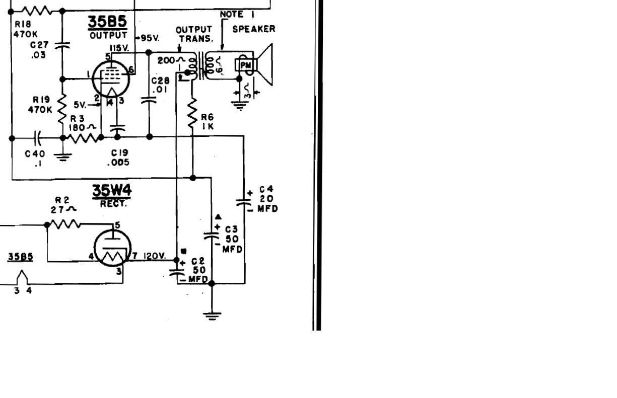

Here's a screenshot of the audio stage of this radio, showing the output transformer and its extra tap on its primary side.
#83
That tap connection is the B+ feed to the entire set. Just move that B+ feed down to the top of R6 (bottom winding on the transformer) and eliminate the tap completely.
#84
Ok, because the replacement transformer has only two connections, the B+ connection and the Plate connection, so I'm assuming that the B+ connection will connect to the bottom of the 1k Ohm resistor and the plate connection will connect to pin 5 of the 35B5 tube, and nothing to C2/Pin 7 of the 35W4 tube?
#85

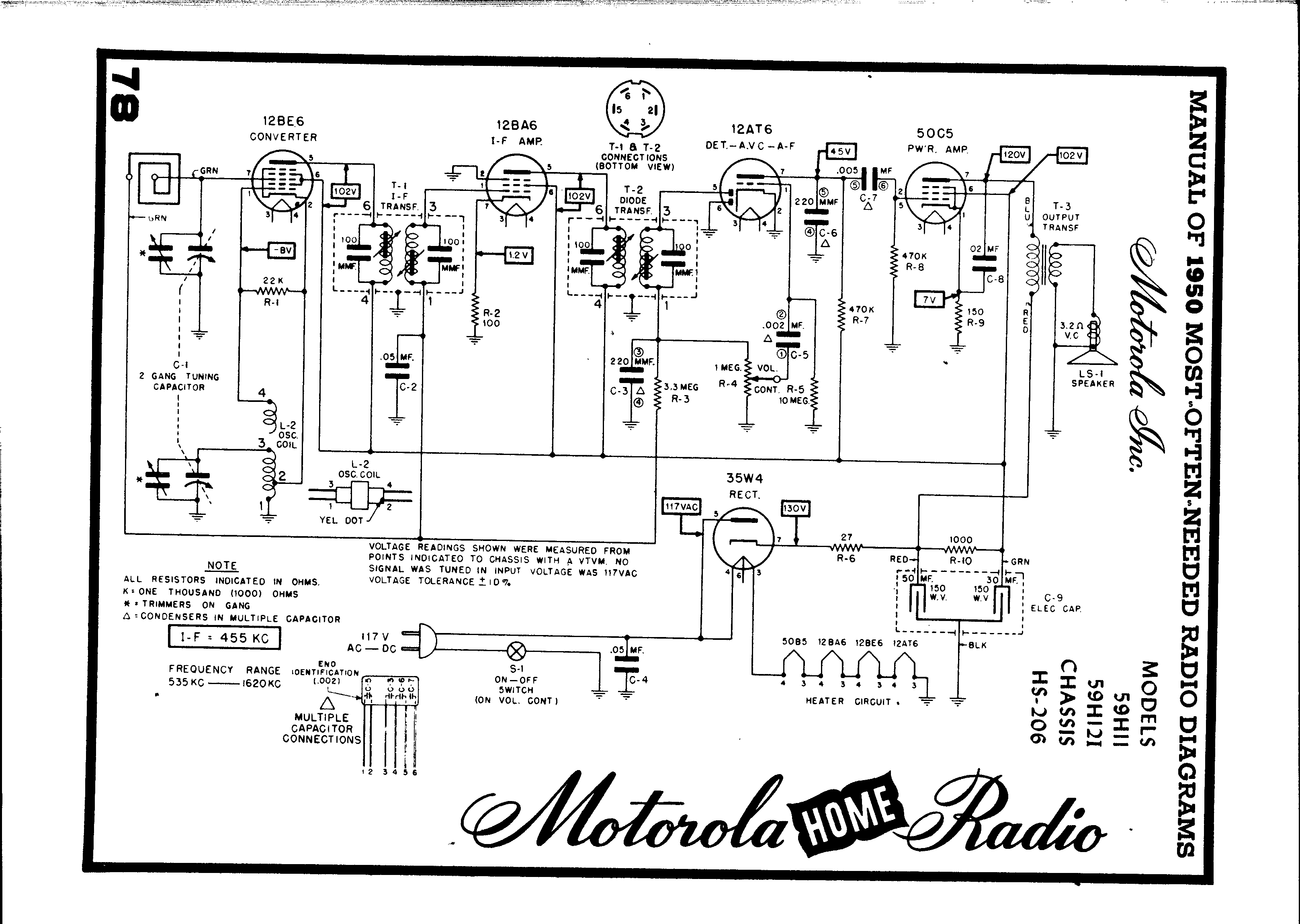

Something like this just note 50C5 vs 50B5 on the pin outs. David
#86
The plate connection from the transformer goes to the plate of the output tube (35B5). The B+ connection from the transformer goes to the top of the 1K resistor and to the cathode of the rectifier tube (35W4) and to the positive of the first filter cap. The bottom of the 1K resistor stays where it is, at the positive end of the second filter cap.

Pardon my scribbling. This is how I would wire it :
