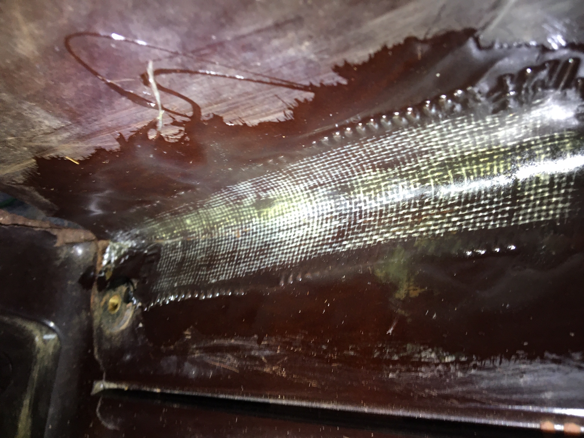

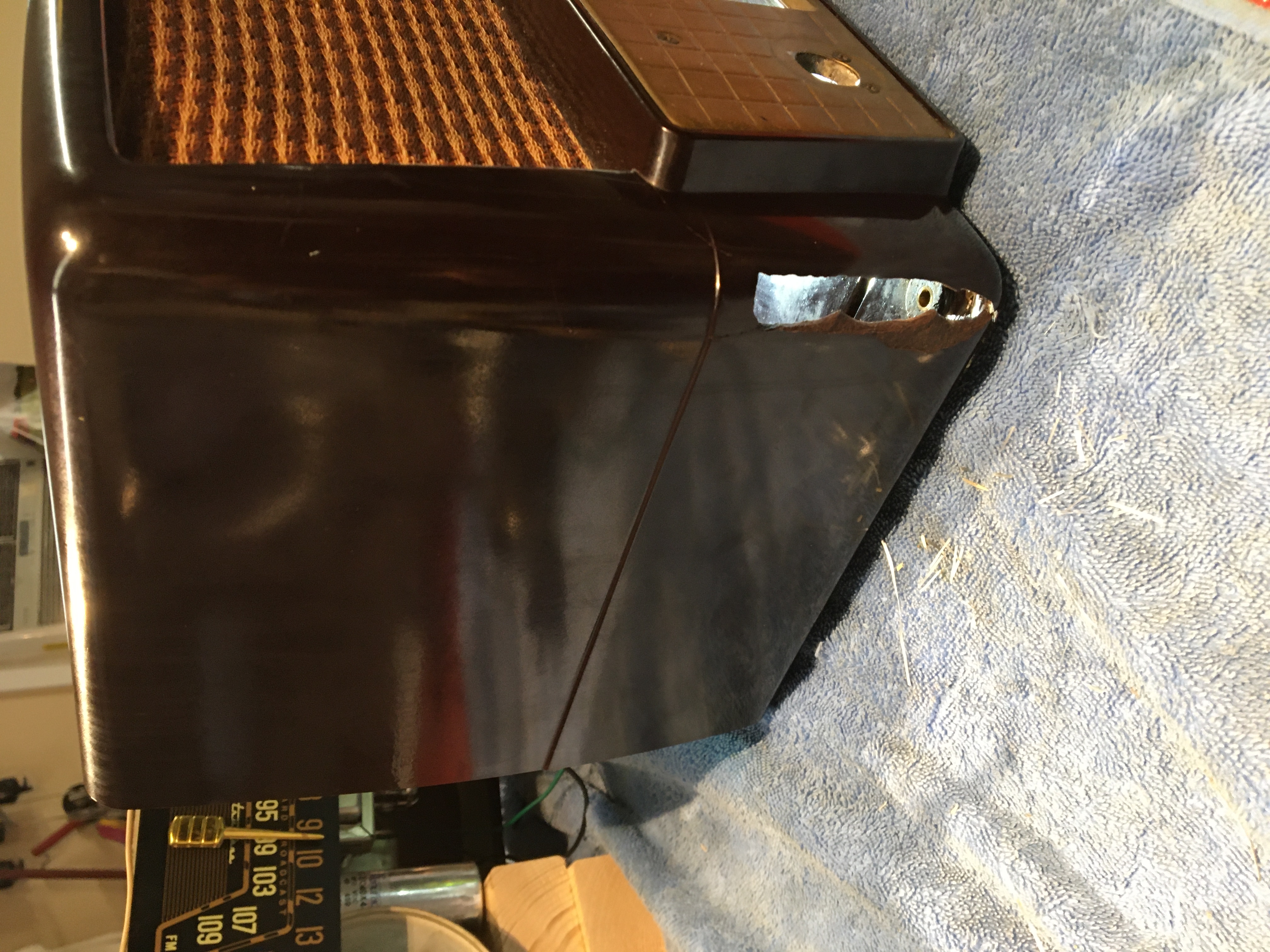

For the most part a success. Someone will have to chime in and let me know what to do so some photos don't down load rotated 90 deg.
Need to add a thumbs up to Ron Ramirez for his How to attach files to your post, tutorial. Believe I have proven it fool proof.

Good pics, wishing you happy listening.

Good looking radio. David

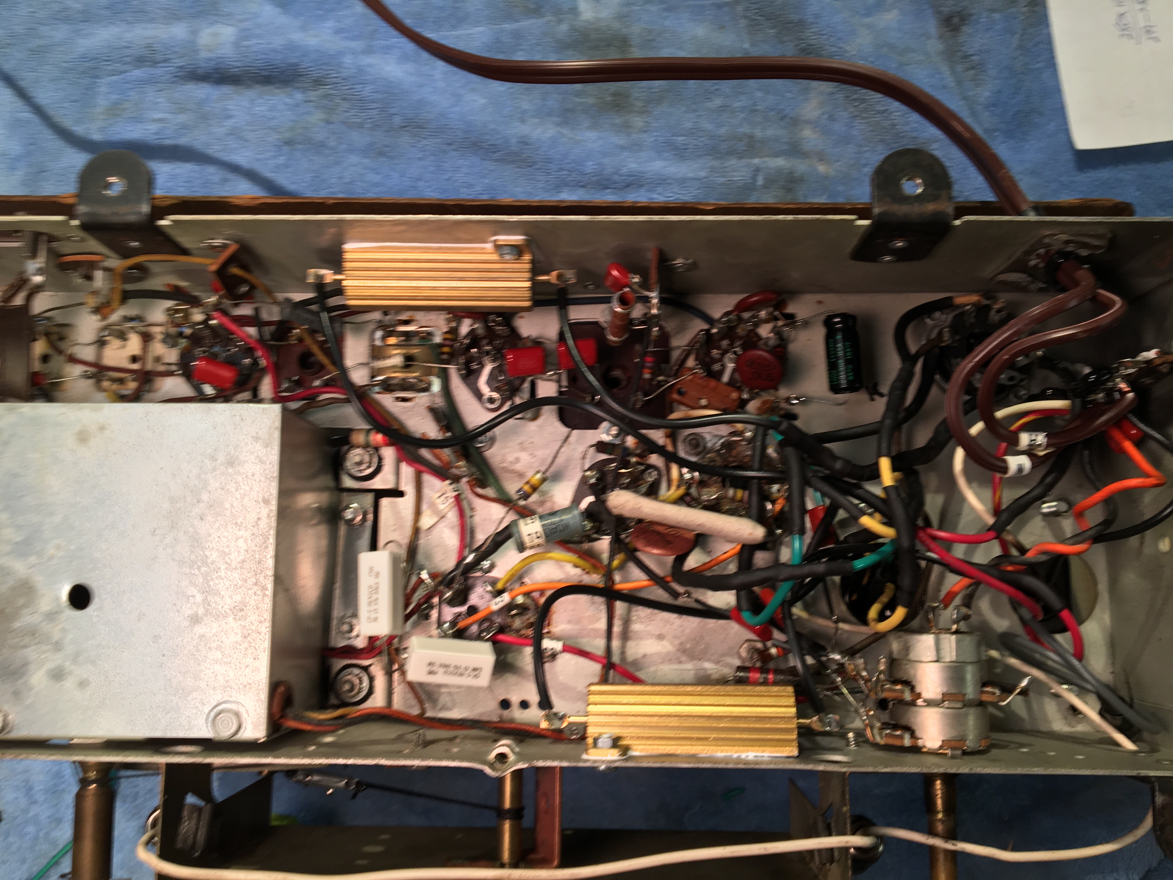

Finally sat down yesterday with my new Sams PhotoFact and started in on A.M. alignment. At first I could not get much improvement. Had noticed at times radio would have a blast of audio that seemed to be twice the level full volume would normally be. Blast would be for just a fraction of a second. During alignment this happened more often so I had to check it out. Found problem caused by a faulty Tone control. Bypassed tone control pot with a 1 meg ohm resistor. Then had full audio all the time and was able to make gains while aligning. Ran before and after tests across the A.M. frequency band and found on average a + 10 Dbm gain after alignment. Highest gain was at 1400 khz +15 Dbm. Lowest gain was at 600hz at +9 Dbm. Although I have much improved sensitivity and enough volume to overdrive the speaker, at best the audio sounds tinny. Guessing the game will be lowering the resistance of my 1 meg tone control bypass resistor till my ears are happy. Please correct me if I am wrong, remembering that on/off, volume control, tone control, gang of controls are no longer available. So is playing with the tone control bypass resistor my only option? I searched for awhile and could not find anything.
On the F.M. side found a bad connection on the F.M. 300 ohm external antenna input. Was able to tune in 20 stations so will investigate a true F.M. antenna option instead of just a length of wire that improved things.
The radio has been played for about a 20 hour time span with no problems other than the tone control. Will focus on filling the hole in the cabinet and then hopefully a completed project.
Thanks to all who provided me with correct schematics ,chassis information and Sams PhotoFact clarification. I'd still be stuck not knowing what the heck I'm working on, only thing I knew was I did not have what the back cover on the radio said I had. Had neither the chassis or cabinet that was provided on the radio.

Quote:Guessing the game will be lowering the resistance of my 1 meg tone control bypass resistor till my ears are happy.
Tim, there is also a capacitor coming off the tone control (going to ground) that determines your tone, so you might want to experiment with different values there.

Ah... Thanks Eliot great info. Would an increase in capacitance result in a deepening of the tone? (less tinny)

Tim, yes I'd experiment with some larger values. Remember you're not actually increasing bass but bypassing some of the highs so the lows will seem more pronounced. You're going to be limited by the size (and condition) of your speaker. I'd replace the tone control before futzing around too much with the capacitance since both will effect the tone.

Is there a source for the 3- ganged controls. Or is the routine to leave the faulty tone pot in place, add wiring and install a new single tone pot remotely. Possibly in the back of the radio. Leaving the front looking original.

Actually, you only need a 2 gang control, the on/off is just a switch added to the back of the last pot. Contact Mark Oppat and be as specific as you can (pictures help) and he'll probably be able to send you a new control, or possibly just replace the bad tone pot if you send him the whole control:

I know Eliot will call it futzing around, but for now simply replaced the 1 meg resistor with a 780 k resistor and I like the sound better. Sorry Eliot. Have noted oldradioparts in my records. Next time I have less than $400.00 in a $25.00 radio I'll do business with them. Looks like a great place to go.
