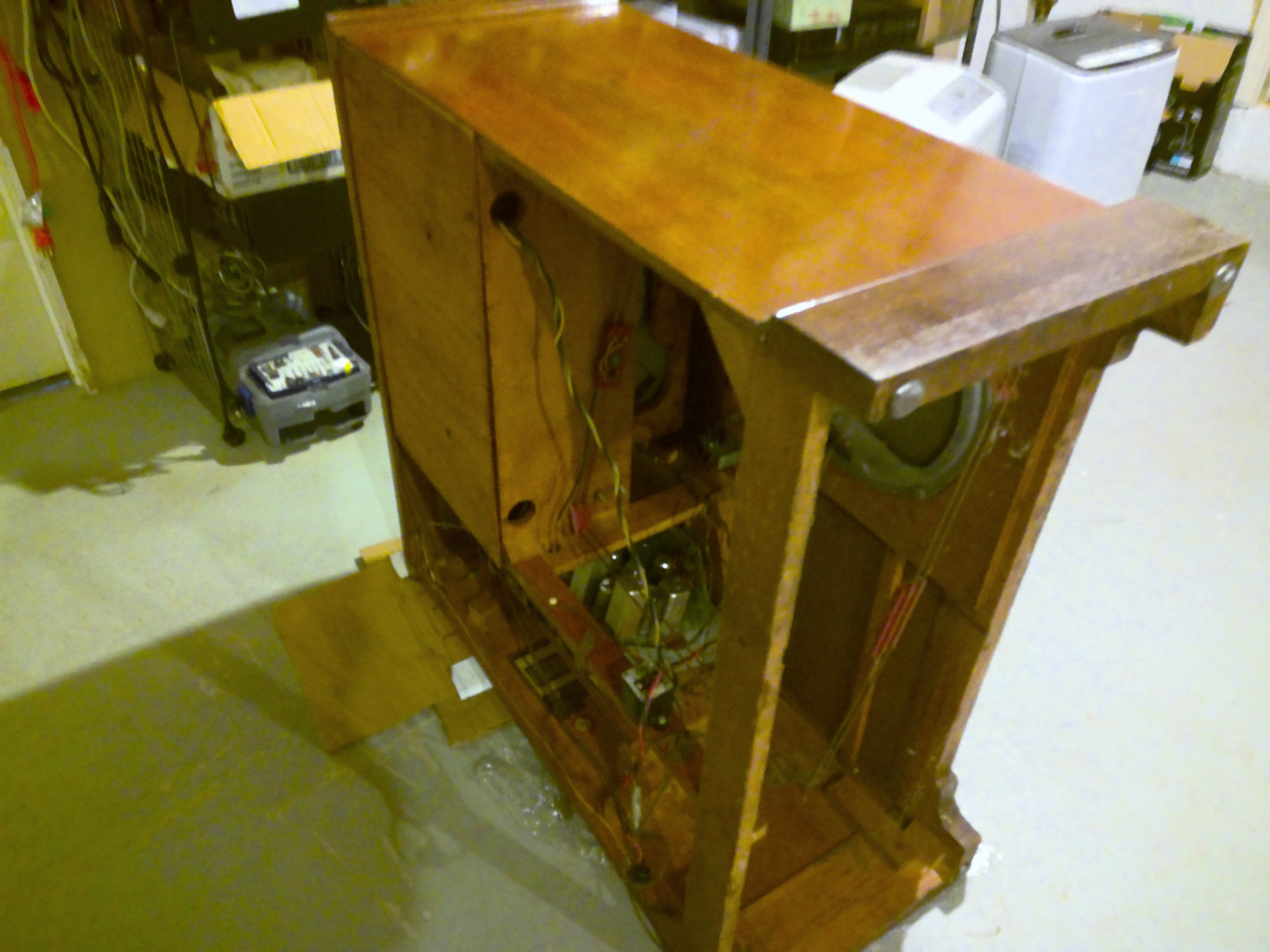

Today was the "take apart" day.
I have to say, it is not very convenient, taking apart the sets with vertical chassis mount at an angle.
Especially the last bolt that has about 1.5" of space around it and has to be taken out with a socket wrench, that makes 1 click per iteration.

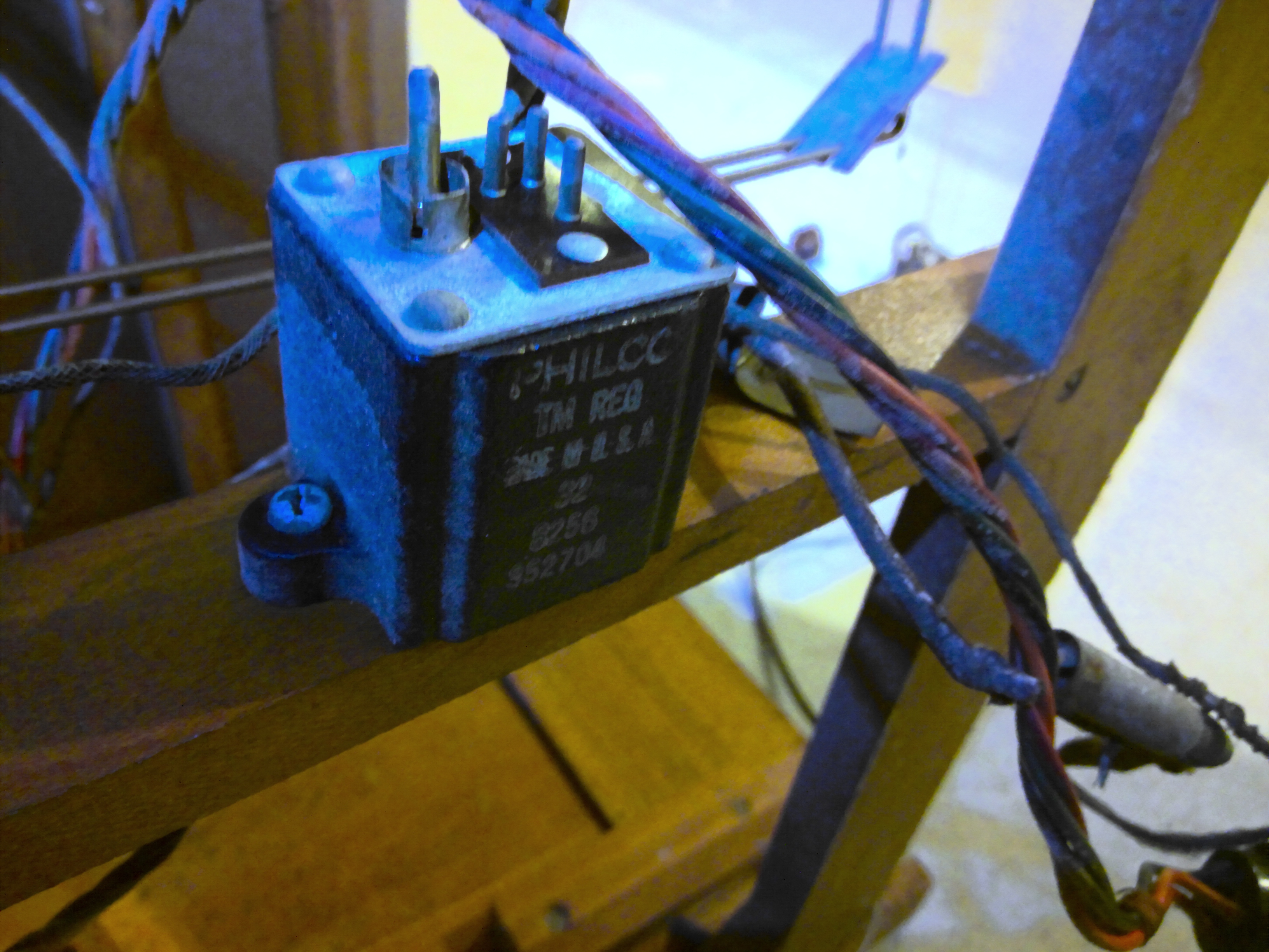

Q1: There is unconnected part attached to one of the wooden risers. Not sure what it is; could probably search but hey! it is a Philco Phorum so methought, why don't I ask first?

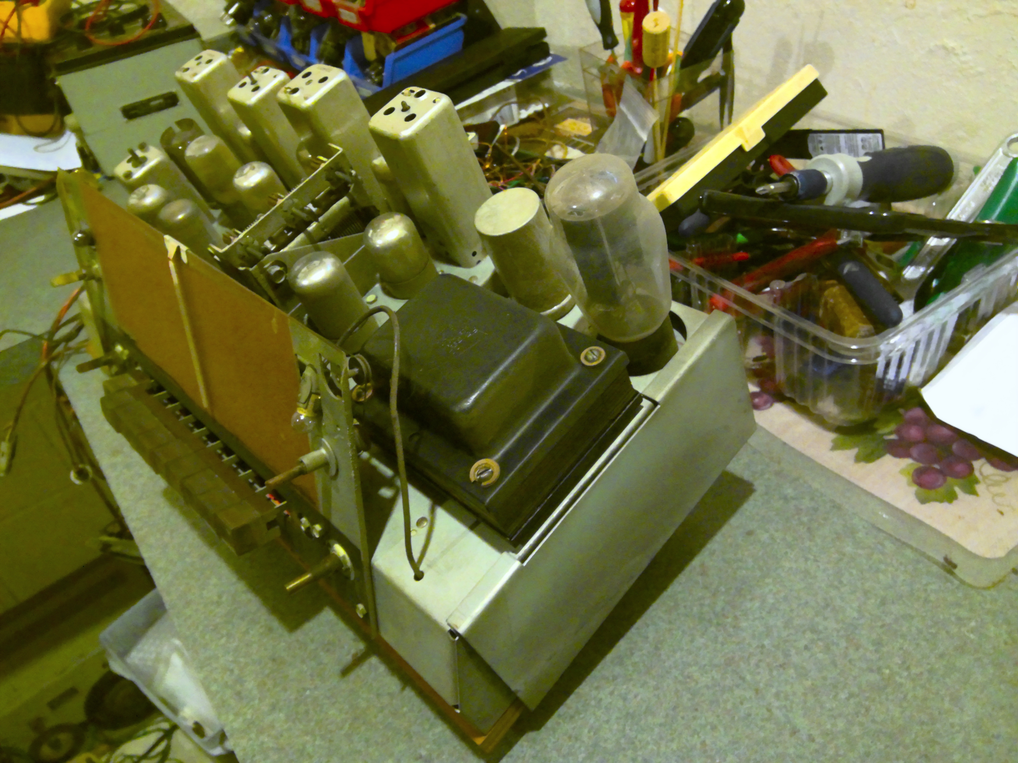

Now the radio.

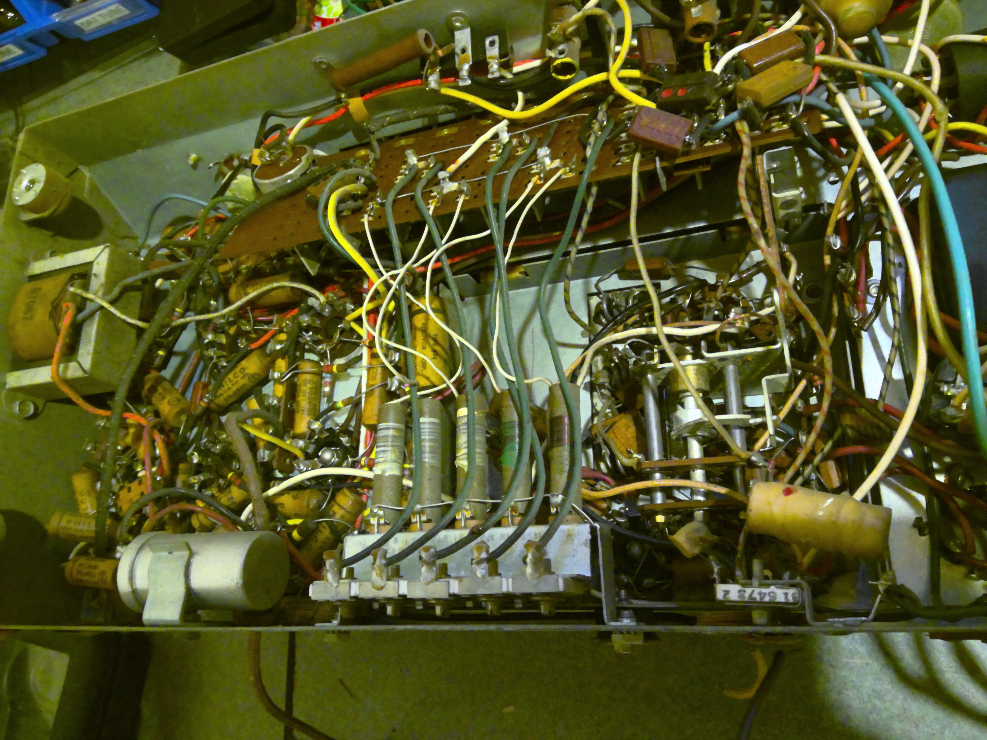

The radio has a load of caps; will take lots of restuffing. If I decide to go for it;
It has a newer cord that is attached by wire nuts inside.
Otherwise no other repairs are obvious.

You got the model correct? Couldn't find in Riders or the Library. The thingy on the board is a matching transformer of the lo z phono cartridge to hi z grid transformer methinks.
Yeah it is 46-1213 of course. typo.

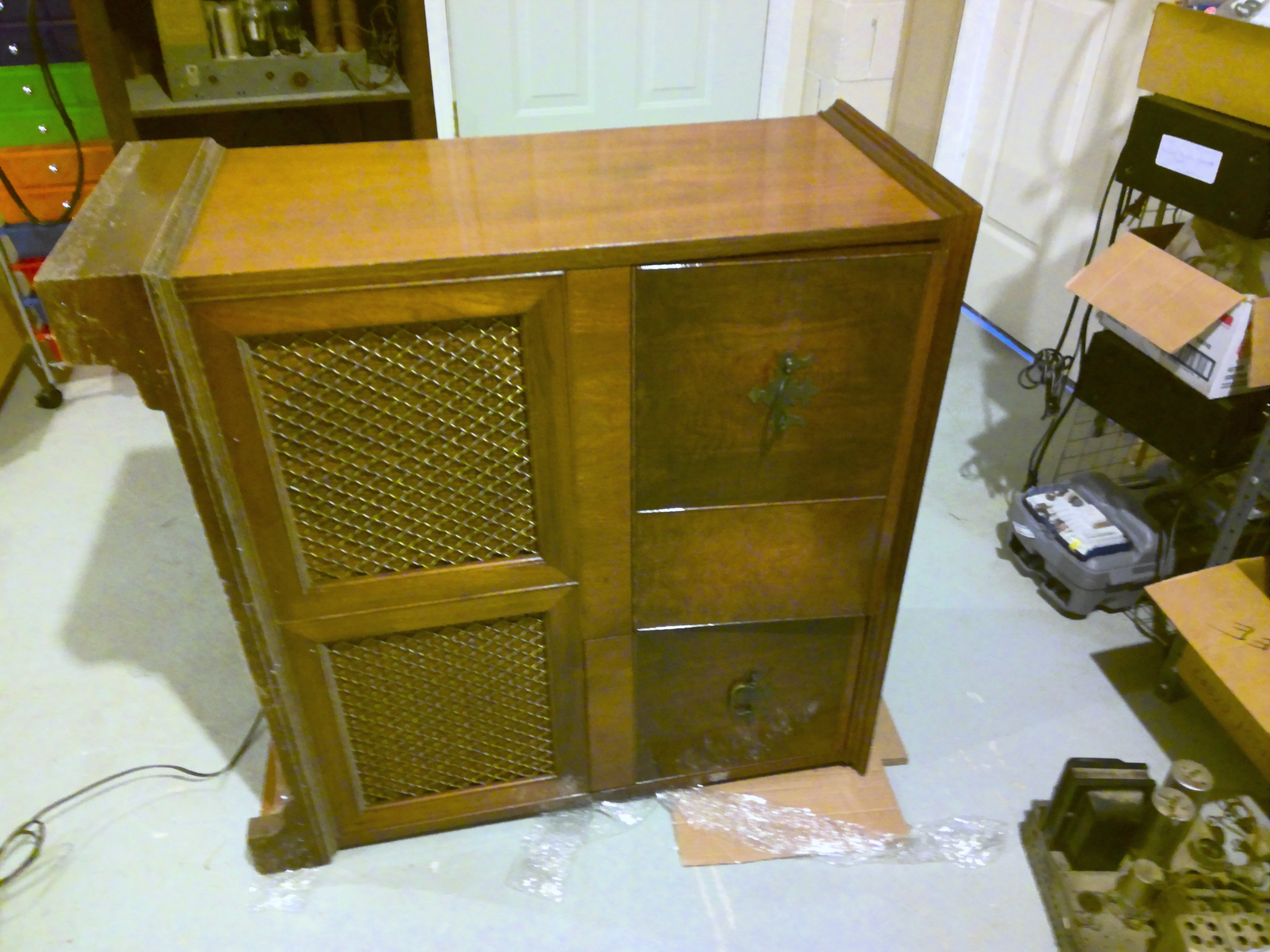

I like the metal mesh protection over the speaker grille. I have a 1952 Airline model like that. It took radio manufacturers about 15 years to realize the speakers and grilles needed more protection.

On your advice I checked the FM-1000 tube; it is fully ok.
I also tested the rest; 7F8 has a short and 7AF7, 6SQ7GT and one 6V6GT out of two are weak.
So Bob will probably hear from me.
I thought Philco stopped using backelite blocks by 40-s some time, but no.....even though it is just one, the AC line filter cap, but they used it there. Flooded eylets too. Hate that.
And it has an RF chassis. I thought they learned some lessons, but again - they decided to use it. I moved it - it it pretty snug and still has some flexing, so I will not be replacing those grommets.
Note sure about the tuning cap: all is very clean, not even much dust. But something puts resistance on moving the dial, and I think it might be that bushing or a clutch or whatever that is that couples the tuning cap with the cord. So I might have to touch that part if I cannot make it rotate smoothly.
Lots and lots of tubular caps. I even thought of skipping the restuffing but then I started doing it. The number of the caps reminds me of that 1940 Zenith Spinet. Way too. Over 30.

The tubular caps seem to be a regular type with grey hard wax (I prefer softer brown one). Because of this yanking the terminal has to be done faster after heating as otherwise before you grab the cap with a piece of paper, after having laid down the heat gun, it is already solidifying. And even after pulling some of it remains inside, already hardened and stuck to the tube.
Not too bad; having enough practice with many hundreds of those I manage that well.

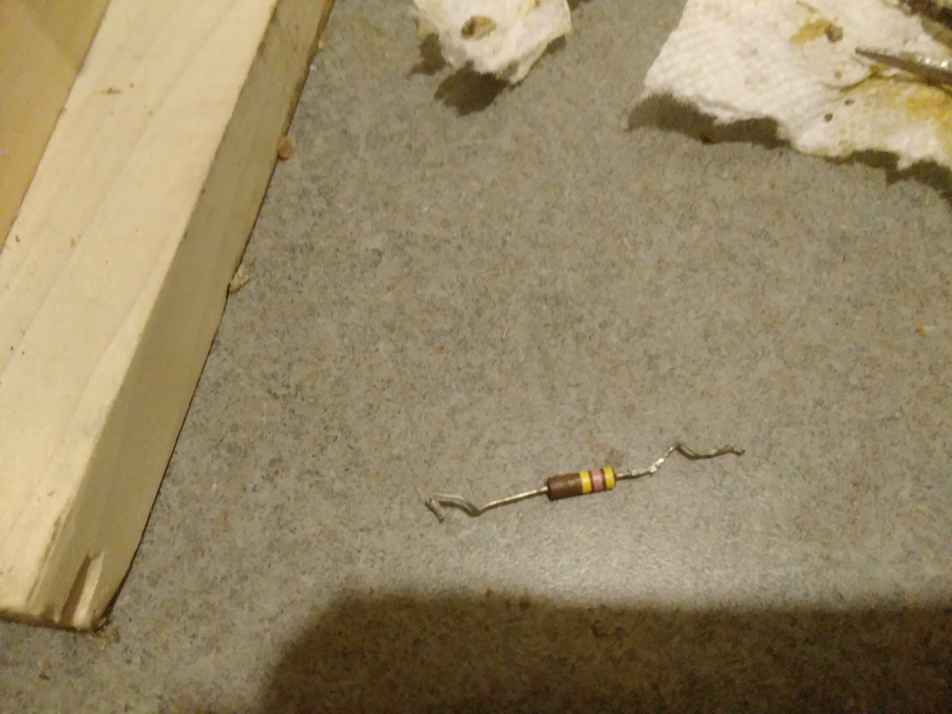

While recapping I usually check resistor values. Not always.
This time I bought carbon comp resistors so when having to replace any they'd look right.
Just now decided to check a 470K one.....it was open. Giving me between 5M and 19M.
It is a load of Phono Amp. I am not sure why short of mfr defect or mechanical or ageing failure. 470K will not overheat.
