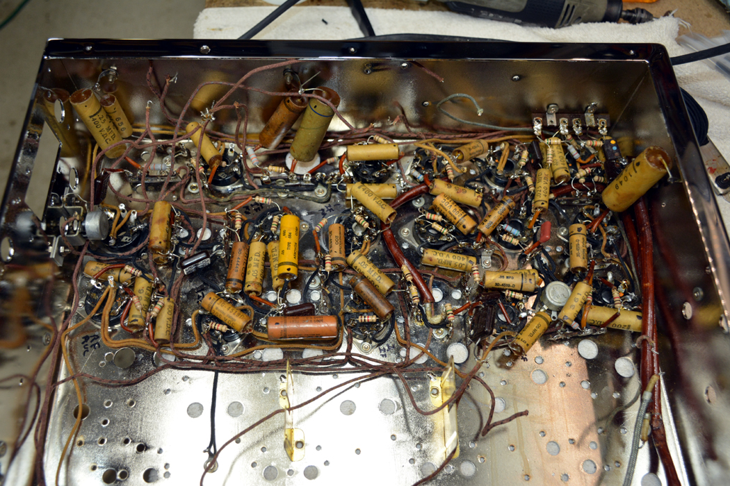

What a mess!!!! I tried to lay out components as they were originally. A lot of capacitors had been changed with Solar's, MicaMould, "Black beauties", Sprague, and who knows what else. A boatload of .05's had been changed. I had a good supply of Philco .05's, so this Scott has been Philcoized. I did turn the Philco brand capacitors so that you could not see the "philco" though! All resistors have been replaced. Now on to the next section.

As I had mentioned in the blog post on the many Crosleys that I had to work on -
https://www.russoldradios.com/blog/thalia-melpomene
Many if not all of the original caps had been thrown away. Even with my large stash of originals, I was out of most of the Crosley numbered W-XXXXX caps. My second choice is to use the same caps- CDE, Sprague, Solar, Micamold that the manufacture used, less the correct part #. With Crosley, it was most of these manufactures. With other manuf. they often used only one brand for the paper caps maybe another for the electrolytics. I have seen factory caps that were a mix of branded and unbranded. So with most manuf. - not Zenith - this sub is almost as good as original.
Your radio looks good, in any case.
Russ
P.S. I wish there were some way to encourage people to save the old original caps that they throw away (clink). I have even offered to pay for factory originals from the 1920s & 1930s. I just posted a WTB on ARF, so let's see.

I was already in that habit before I started restuffing paper caps, other then Philco ones most are brands like Aerovox, Sprague, Etc. I think the solution is to find a source of cardboard tubing, I found a source for the larger sizes, and sort of did for the smaller, some wire coat hangers have cardboard tubes on them but not often.

You will see one radial lead, brown cap in there. I couldn't fit anything in the original cardboard tube! So, for now, one modern cap in a forest of re-stuffed ones. But then, all of the resistors have been changed and they do not look like the original ceramic style. I just can't bring myself to trying to make all of those look original. Quite frankly, I'm getting tired of re-stuffing all of those caps! Starting to think that the brown Panasonics are looking pretty good.

I did not notice it, until you told us., The one on the right.
BTW I have, on a few occasions, stuffed radials in the tubes. As long as they fitted inside. If teh leads were not enough I simply wrappped them around buss wire and made lead extensions which then were potted.

I have run into issues stuffing 630V yellow caps into some of the original tubes. Much smaller (yellow) caps, rated for 400V are available through Mouser at reasonable prices.

So far I had few if any issues stuffing yellow 630V axials into the original tubes.
One that I had, I think, was the larger type, 0.15uF and the tube was not much longer than the cap itself. That is, to do what I typiclaly do, spiralling a paper strip, putting it on top of the yellow cap and potting with plastic, I had no space left.
What I then did was, instead of cutting a strip and making a spiral, I cut a disk size of the internal diameter of the tube, slid it down the lead and then potted. This gave me enough space and still protected the yellow cap from the hot plastic damage.
And you are right, 400V will do in most cases.

OH MY GOD ! Rat's nest hardly describes that MESS !... Better you than me. You have my sincere sympathy I realize now that there is a definite advantage to the military nature of the SLRM. I look forward to hearing more about your continuing adventure. (Personally, seeing that, I have less respect for the engineers who designed that radio. Serviceability should ALWAYS be a concern, and, seeing that, it CLEARLY WASN'T for the designers of that chassis.)

 No it wasn't!! The standard Philharmonic is a little less congested. Yet, at some point in this radio's history, a lot of capacitors and a few resistors had been changed, some of them under the upper layers. Someone took the time to dig deep. Scott crammed the FM section in the same chassis as the AM Philharmonics by removing the "expander" and added far more tubes, circuitry and coils than they removed, thus increasing the component density. I just hope like crazy that everything works when I power it up! NO SMOKE PLEASE.
