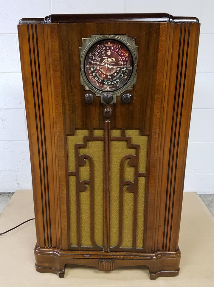

I'll briefly touch on one of your radios, the 1936 Zenith 6S52.  A six tube radio it was the first in Zenith's lines of "Big Black Dial" radios that are very popular with collectors.  Although it's not apparent now, with the dial lights on the dial is actually fairly colorful due to bands of color on the rear of the dial face.  It also has a fairly deep chassis that should be easy to work on with lots of room.  Unfortunately, the correct original wood knobs might cost more than the $50 you paid for the radio, but that's just a fact of life with the Z knobs.  This site has a close-up of the correct knobs:

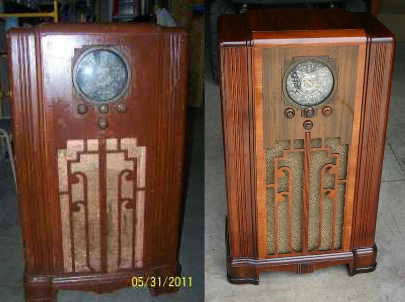

I don't see why you couldn't work on the brand Z first, followed by the RCA, the 6S52 is basically the same chassis as one would find in a table/mantle model since it's a six tube chassis. It looks like the cabinet used to have a dark strip down the middle of the pilasters, and on the beaded molding just bellow the speaker grille, you can easily spot a refinished set online if everything was refinished on a monochrome. A guy that claims to have a refinishing business did this with an RCA-Victor model 281, posting pictures on the ARF, the legs were darker then the body of the cabinet, and had a black stripe on each leg, he redid them all in a medium brown, along with the rest of the cabinet. Your best bet for getting knobs would be to attend some swap meets, the Renovated Radios ones are plastic made to look like wood, alternatively you could play the fleabay lottery for originals, buy some wood reproductions (though I'm not sure about whether they make 1936 Z knobs) or contact someone like Mike Koste, or one of the other second hand knob vendors . With regard to table radios, you will find a few in short order, in fact one of our members would probably be able to supply you with as many as you require, he's out on Long Island.

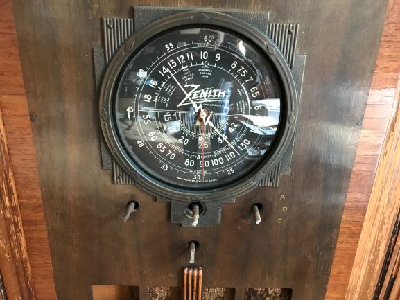

Welcome to the Phorum ! That Zenith looks like it will be a nice set if it is not missing some critical parts. I don't see any shafts coming through the two lower holes on the right and left. Some controls might be missing, not just the knobs. One of the shafts I don't see is the band switch, a pretty critical part made from unobtainium these days. I hope this is just an optical illusion because the chassis is not pushed up properly in the cabinet. As for the knobs, if you aren't a fanatic purist, you can get good looking reproductions made of plastic that look just like the wood ones from a little distance here...  http://renovatedradios.com/index.php   I hope all the critical parts are there. It is a great radio and deserves to be restored. Good luck to you.

Morzh and Elliott Ness- Yes the wooden knobs are pricey (!)- I recognized that going in but for $50 for the console without knobs I went ahead. I think I will take the suggestion of using generic knobs for now- the cabinet needs refinishing (particularly the veneer on one side). Then I will reconsider...I also had read here and on antiqueradios that the Candohm is frequently a problem- we'll see.
Arran- the console seems to be original as you suggested, clearly up close shows several tones to the wood. Because of the veneer damage on one side and loss of lacquer on the right front I will probably end up stripping part or all .
NostalgiaRadioTime- that's a very nice Zenith. I hope mine will look something like that when I am done. I will need a new dial belt although you can't see that from my pics. I wish the Waves grillcloth was not ripped, I would love to find something as close to that as I can.
Mike-it has all shafts. I think it is pretty complete altogether except for the knobs (even has dial lamp shades, although I will replace them). It does however have severely compressed chassis supports so the knobs (until I get new supports) do not quite clear the openings. I have propped it up to show the shafts in a new attachment

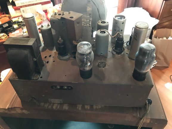

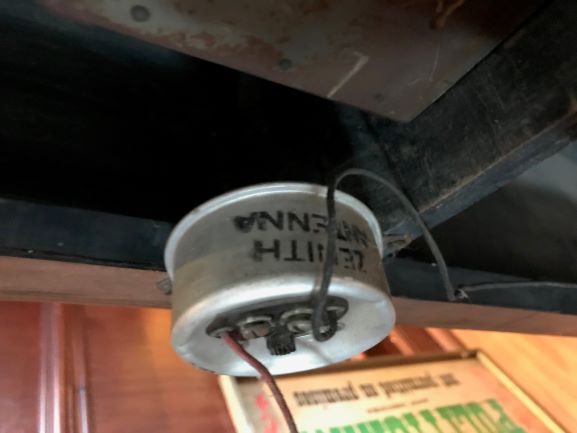

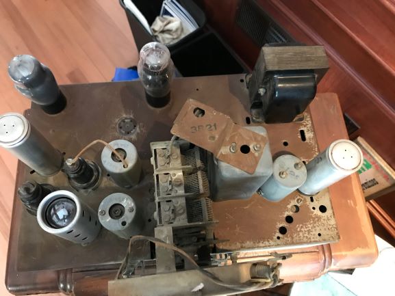

I am posting several additional snaps of the top and inside of chassis. If anyone sees anything missing, please let me know. Can anyone comment about the Zenith antenna metal attachment to the rear of the cabinet?
Steve, thanks for the additional pictures. That Zenith is a great radio, and is going to be a wonderful player when you are done. Take your time with the restoration, and do it right. The folks here will be happy to help you out. Renovated Radios has all the rubber parts you will need, as well as the knobs. Here is the link to their page with the Zenith rubber parts http://renovatedradios.com/productlist.p...ondary=120  , and here is the link to their page with the Zenith knobs. http://renovatedradios.com/productlist.p...ondary=120  Believe me, these reproduction knobs look great, and are much cheaper than original wooden ones would be, plus they are available all at once. Take your time with the restoration. Yes, some of the parts to do it right are going to seem a little pricey, but that is what you have to pay for items that sell in small quantities to a niche audience. It is something that all of us in the hobby have to deal with. The trick is to take your time, and buy things along and along, fixing the radio as you get them. It does require patience, but this just adds to the feeling of satisfaction when you finally see the radio finished and performing as it did when it was new. I look forward to seeing your posts as you go along with your work.

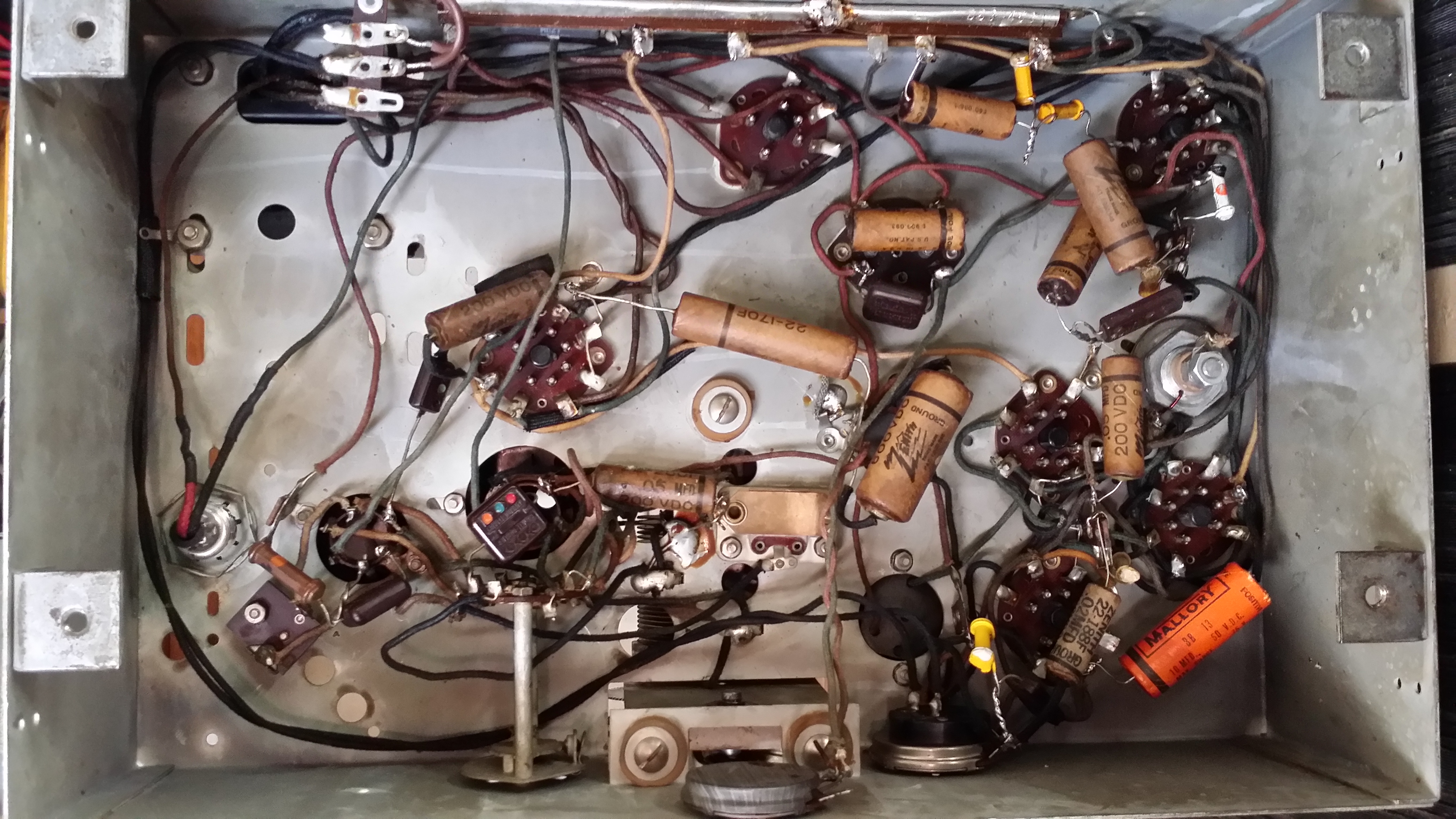

Speaking of future posts, take LOTS of pictures as you work. Take several of the underside of the chassis from as close as you can focus the camera BEFORE you begin any work. Then take a picture at each stage as you go along with replacing the paper condensers, the electrolytic condensers, and any out of tolerance resistors. Don't let the term candohm throw you. It is just a long, tapped resistor mounted to the side of the chassis to dissipate heat. You can replace it with a terminal strip with suitable resistors soldered to it, or, if just one section of the candohm is bad, solder a replacement for that section between the terminals of the bad section, same resistance, and sufficient wattage to take the current which it will have to pass. All these pictures you take before and during the process will allow you to refer back in case you mess something up and need to see how things were earlier. They will also be fun for us all to see to follow your progress.

The 6-S-52 is one of my favorite Zeniths. Mine was in bad shape too. I had kept it in the "wood shed" before deciding to fix it up. Now I am glad that I did.

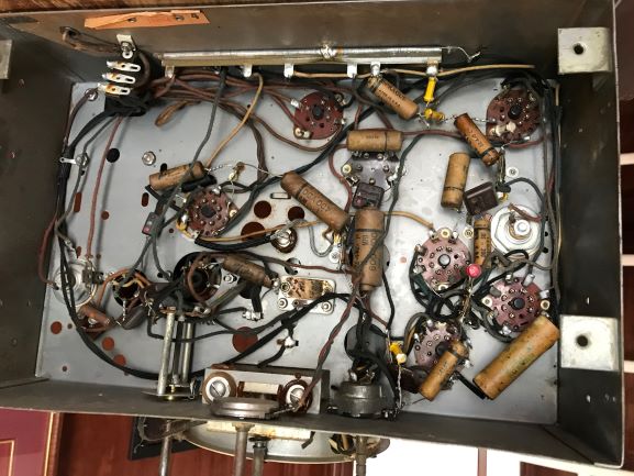

I like the looks of that console, Russ and Greg! Looking at the photo of the chassis, it would seem there is a LOT of empty real-estate under there. It should be a breeze to work on.
Yep. Still have to change out that one cap -
Forgot to include a pic of the underside-yes, lots of room under there! Considering how crowded some radio chassis are that I've looked at on line, this seems wide open.  Since I'm new to this, to those who have worked on 6-S-52's does anything seem missing?
